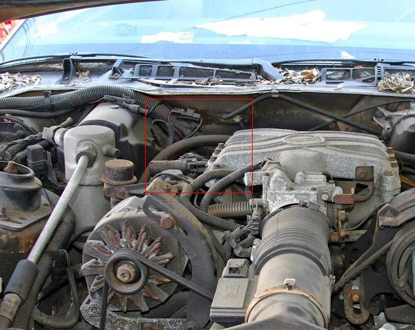

My dad recently gave me a banged up 85 Camaro to me as a gift for college and I've been hoping to fix it up. I noticed that the accelerator sagged all the way to the floor and is pretty limp, no tension whatsoever. I take a look under the hood and as far as I can tell, theres no cable connecting the accelerator to the throttle body. I've looked on eBay for a replacement and I the closest I came up with was a cable pulled from a 84 Z28.
Here's a pic I took of the engine compartment.
I know Im a noob but any help would be greatly appreciated!

take a closeup of this area so we can see if the cables are there or if there is any other damage.

see the hole in that bracket? thats where it is supposed to go through since it is not there and neither is the thing that holds it i bet it is some where under the upper plenum and it just poped out. see if you can shine a light in there and see it. if not it ma have fallen out the back some how and is just floping around.

Here it is. did this car set with its hood up for a long time or somethin?

Kyuusei: on closer inspection of your pics you are missing three cable linkages 1. for throttle kick down (with auto trans), 1. for the gas pedal and 1. for the Cuse if your car has it. which since your car has AC i would assume it does. has the engine been out of that car that you know of? cause those linkages all come up through or next to that bracket there and you have to disconnect them to remove the engine.

Hmm all I know is that it was driveable prior to being parked there for a few years. It has a manual tranny so thats one linkage down. What do you mean by Cuse? Cruise Control? I'd have to check up on that.

ya i ment the CC i didnt know how to spell it . well i would still look and see if the pedal linkage has not just been disconnected and is under the plenum or has mabe fallen further back. If it is gone totaly you would need one from a V6 camaro or firebird cause i dont think one from a V8 would work, the throttle body on them is much further forward so it would be longer. but Jyards are usually willing to sell the V6 parts super cheap cause of there not very popular for replacements usually if someone needs to replace the engine in one of these cars they put in a V8. i know the Jyards around here in kansas have huge stocks of V6 stuff that just sits but the V8 stuff goes out faster than they can get it in.

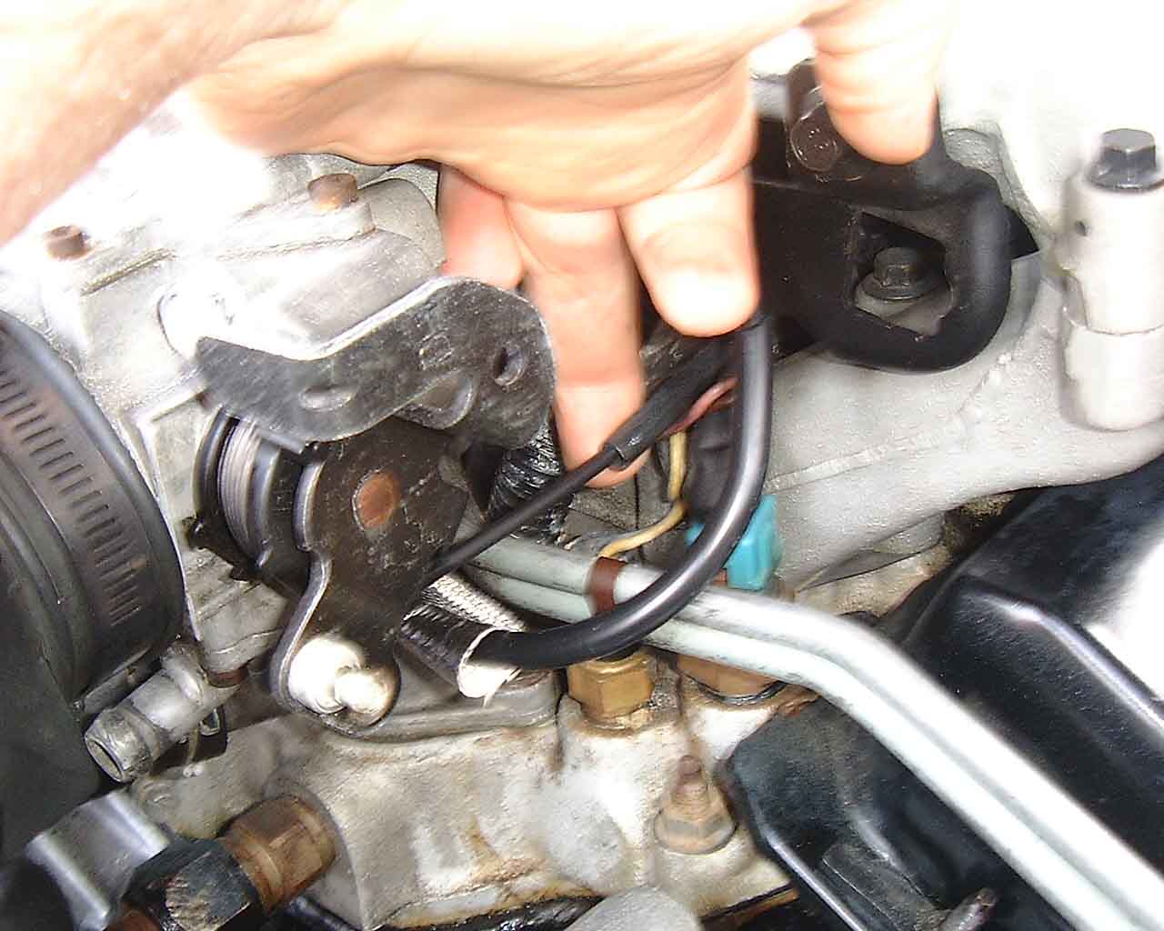

this is the throttle linkage going to the pedal. to drive the car this is the only one you need.

as long as you have somthing coming out of this hole you can follow it to wherever it is going now and hook it back up and drive
