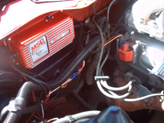

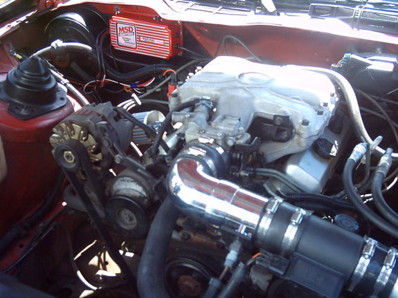

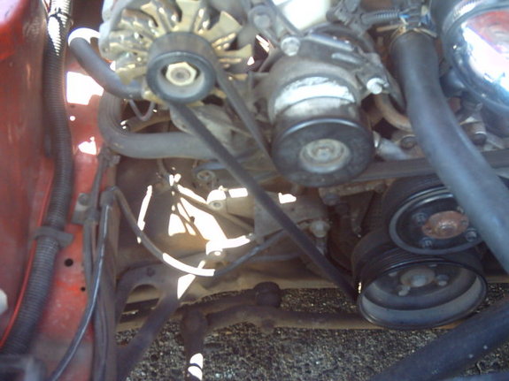

rsfreak could u please post a few pics of the engine bay and areas in which you removed stuff please?
Old Sep 10, 2006 | 09:50 PM
RSFreak's Avatar
Posts: 2,262
From: Renton, WA
Car: 1985 Camaro, 1986 Trans Am
Engine: 5.0L carbed and 5.0L TPI
Transmission: TH700R4
Axle/Gears: 3.23 and 3.27 posi
Sure thing man! I was gonna take some pics tomorrow after I get my MSD-6AL installed.
Old Sep 14, 2006 | 07:46 PM
RSFreak's Avatar
Posts: 2,262
From: Renton, WA
Sorry for the delay, I had to wait for my buddy to post the pics. BTW, his camera is not the greatest so...
Pic 1. EGR stuff gone and block off plate on exhaust manifold
Pic 2. smog pump delete with shorter belt and "custom" alt bracket
Pic 3. neat and tidy engine bay
Attached Thumbnails ordered some stuff from hawks, and need some help-msd2.jpg   ordered some stuff from hawks, and need some help-msd4.jpg   ordered some stuff from hawks, and need some help-msd3.jpg
