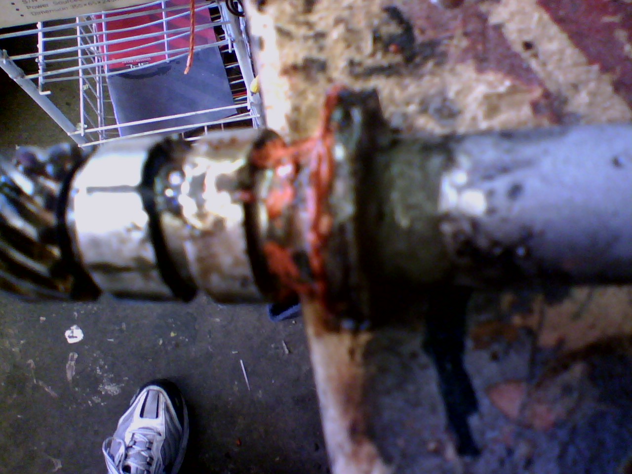

Friend is into kitcars made off fieros. He picked up one the other day that has a 2.8 in it. However, the top has been converted to eldabrock tuner2 carb setup *sigh*
This thing is spewing oil out the side of the dizzy about as fast as you can put it in. Its been either snapped off at the base, or cut and extended, and fused back together with jbweld.
Anyway, identifying marks..
A. It has an accel 140003 in cap coil
B. Inside has what I think is called a condenser, along with a wells pickup coil.
C. On the side of it, where its also been broke off has marks "103379" and futher off to the side has BJ 5
D. Vac Advance previsions.
Help identifying it as to what we need to go get a new one from. Or one that could completely replace this setup would be nice.

crappy cell phone pics... cause I didnt know what I was getting into to bring my good camera, timing light, or tools, etc.

Looks liek an early '80s FWD 2.8 carb dizzy.
Found in Celebrities, and similar GM FWDs of the time.

Thats what I was thinking. I think its taller then most FWD dizzys though?
I guess he will have to buy some, and we just test them in the car.
