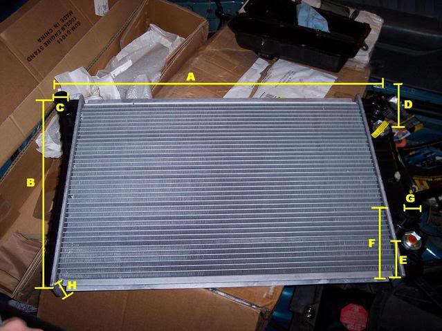

And here is a pic of my new radiator...
...dont mind the measurement lines...
