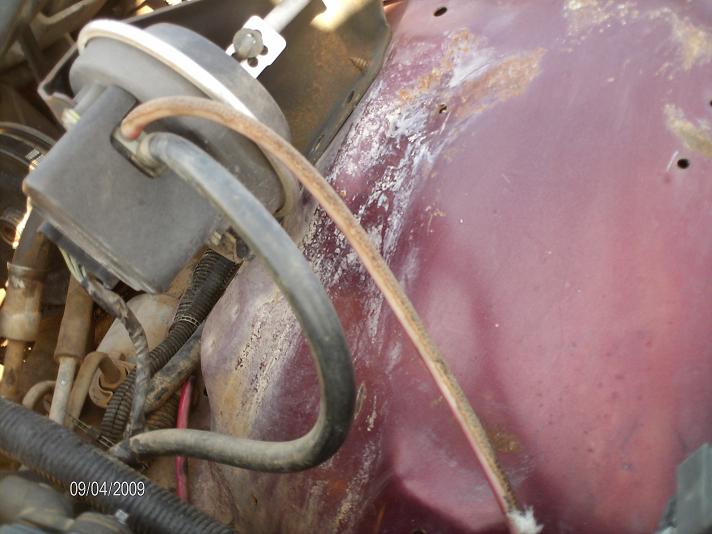

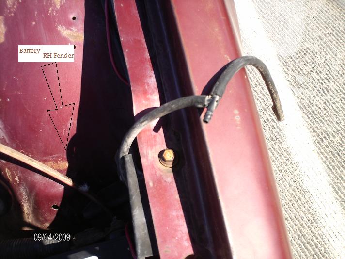

Here are some visuals of this mess
Attached Thumbnails Sick Of Dying In An Intersection....-mini2.jpg   Sick Of Dying In An Intersection....-mini1.jpg   Sick Of Dying In An Intersection....-mini3.jpg

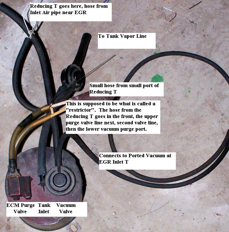

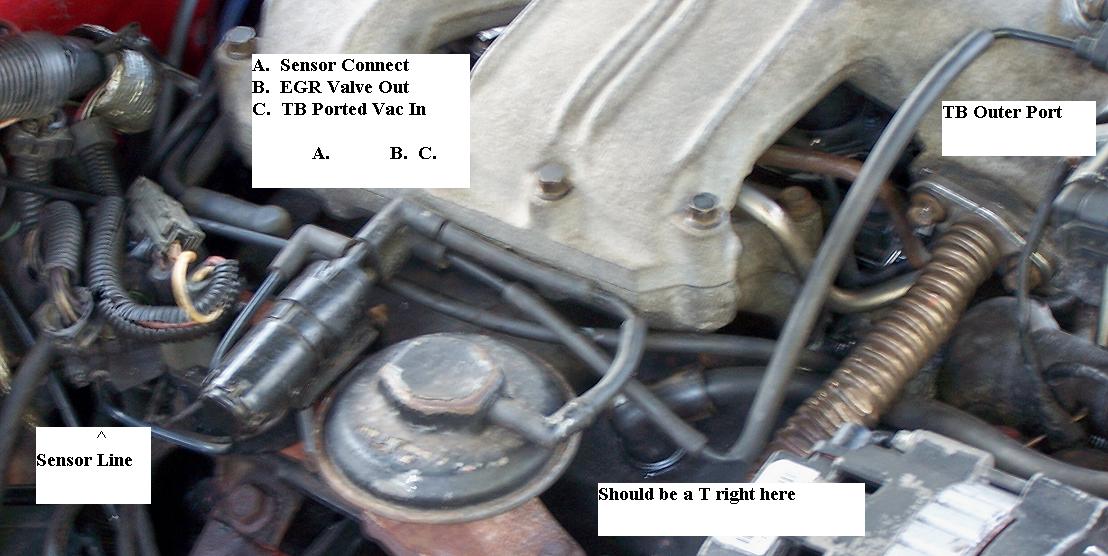

If it will let me post it, this diagram is for my 87. Get those vac lines taken care of, and then we'll deal with the other problem (cold stalling).
Look in this post: https://www.thirdgen.org/forums/v6/5...-firebird.html
Don't worry about the year difference... The diagram on the 85 hood I have is pretty much the same as the 87 diagram (that was a pic I snapped of it before I got rid of my old hood).
:edit: You're also going to want to pick up a foot or so of 5/16 fuel hose and replace the vapor vent hose on that charcoal can if you need it connected to pass emissions.

Pic 2 looks like it goes to the "orb of power" under the battery tray. I pulled mine and the line and noticed no difference.

yeah the one in the 1st pic is the cruise control,the second pic looks like the hoses goin to it from the plenum(on mine anyway) at least it goes to a vac source..just go to the source of vacuum and plug all the lines up that are loose,then get a diagram like Maverick posted,then you can get new lines in correct sizes and reconnect things you need,cruise is not really necessary.Definitely spray or replace charcoal lines as needed since it will leak,also pull the line off the purge valve on top of you cannister and open the throttle some while placing a finger on the end to feel for vacuum as you hold the throttle open.Also the lines in pic 2 wouldnt be a leak since they arent connected so you might wanna spray areas around the intake and injectors,brake booster line with starting fluid.will be better to use that instead of soap water or or carb spray

legendofkane, he has the old vacuum operated EGR valve that is controlled by a vacuum regulator valve... All he has to do is pull 2 10mm bolts and take it off of the connecting pipes.
You can clean the EGR pintle, but you might want to test the valve first to make sure it holds vacuum as well. I still have most of these parts but can't use them (the canister vacuum restrictor and inline purge valve, the vacuum regulator valve, the EGR valve) so let me know if you need them... I'll see what I can dig up in my garage (EVRV and the EGR valve are still attached to my engine at the moment as I haven't made it to the junkyard yet to get the digital one). Also, the big black pipe running off of the nipple on the throttle body to the nipple on the rear of the lower intake may have issues as well. Both of the rubber ends could be cracked and useless, and the secondary line running to the vacuum canister may be melted or cracked/broken. Also check the fit of the PCV valve in the valve cover and on the hose connecting to the idle air intake pipe (that nylon pipe I described before), that the intake bellows (and the ENTIRE air inlet assembly for that matter) isn't cracked, and the nipple on the passenger's side valve cover for sealing to the intake tube and the valve cover for proper sealing.

EGR valve hookup is easy. The top line to the regulator comes from the middle small port on the TB vacuum block, which is a ported vacuum source (open only when the throttle plate is open). The bottom line comes out of the valve, goes into a T which is hooked up to both the sensor block, next to the valve, and into the EGR valve itself. There are no other hoses for the EGR.
The other line in that area should come off of the nylon inlet pipe running between the intake manifold (by the PCV valve and the cold start injector in the back next to the dizzy), and it runs to the restrictor for the canister purge valve.
Those are the only vac lines that should be in that area. The HVAC system inlet is supposed to come off of the line running to the cruise modulator and the "orb of power" under the driver's side battery tray, which is fed off of the small port on the T for the brake booster, and the heater control valve line comes right out of the HVAC wire harness and runs straight to the HCV.
:edit: Code 24 is a tricky one to get rid of. FSM says to disregard this code if the vehicle is not moving when the code is set. Code 54 is also tough, but an easy test can tell you if it's a problem in the fuel pump relay wiring or the ECM. Take a 12V feed and ground and run the power feed to the lower left port on the ALDL, and the ground to the upper right. If the pump runs, the ECM is bad and the rest is good.

Here are some diagrams that might be of use
Attached Thumbnails Sick Of Dying In An Intersection....-0900c1528008e5e7.jpg   Sick Of Dying In An Intersection....-0900c1528008e5c1.jpg   Sick Of Dying In An Intersection....-0900c1528008e5c0.jpg

Here are the pics. Let me know if the canister one confuses you. I had to pull the can out of the car (it's not like it's hooked up properly anyways).
There are 2 plastic parts in the EVAP can lines. The first is a green Y-shaped T that has the inlet hose coming from the nylon intake pipe by the EGR (which I don't have). The vacuum purge valve that is in between the can and the vapor line has a small hose connected to the small port on this Y. The outlet on this line goes into the restrictor.
The restrictor (looks like a black TT shape) has the inlet coming from the Y, the first side port connected to the upper port on the ECM controlled purge valve, the next port to the lower port on the ECM valve, and the last one connected to the lower port on the canister's vacuum purge valve on the right.
The inline purge valve between the can and the fuel line has the inlet at the fuel line and the lower outlet port connected to the center port on the can. The control port (above the outlet) connects to the small port on the Y.
The vacuum regulated purge valve on the right side of the can has the upper control port connected to the EGR ported vacuum inlet, which is split coming from the throttle body.
Attached Thumbnails Sick Of Dying In An Intersection....-egrsetup.jpg   Sick Of Dying In An Intersection....-2.8tb.jpg   Sick Of Dying In An Intersection....-evapsetup.jpg
