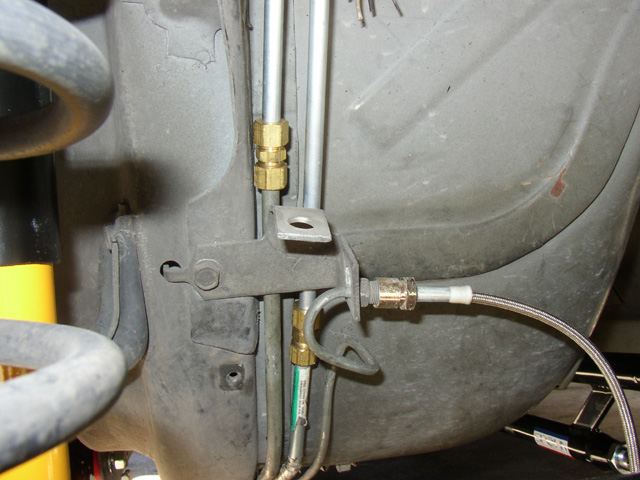

ok so i made a mistake there is no clear hose anywhere it was just rotted and dirty and in the bright light i guessed it kinda looked cleared. amd this is where its snapped at

Re: fuel line problem
Need a pic further back to know what the line/hose is for... There's 4 hoses right there, and without a decent pic, we can't tell you which to replace or what it does.
thats the hose that goes into the fuelfilter its snapped right at the connection. its the hose closets to the out side. im not sure if thats what you wanna know or not
Looks like somebody tried to patch what you're replacing before. Closest hose to the fuel filter should be the one that connects the inlet line on the filter to the fuel sending unit coming out of the fuel tank, no hose within 2 feet (feet of fuel line) of the filter itself. However, you can cut out the damaged portion of the line and go to the parts store to see if you can find a filter with a hose barb on the inlet side (might be hard to find for non-carbed applications, most with hoses that I've seen are on the outlet side and they ONLY go ONE way). Might be worth it to thumb through a Fram or Purolator filter book at a parts store to see what you can find.
how do you assume that somebody tried to patch i dont understand?
You said that part in the pic above was right before the fuel filter connection...
yea i dont know if i twisted it while trying to take the filter off.
89 and 90s have the same fuel line setup right there both 3gen i hope so because i just found out its of a 89
and all the way to the left thats the right connection to the end right?

Need a wider pic... Not quite sure what I'm looking at there. The line going to the fuel filter will be the biggest of the 4 under there (3/8" line as opposed to 1/4" or 5/16").
The lines are the same for all fuel injected vehicles...

ok that answers my question that pic was just to show the connection at the end.... the fuel line looks so much bigger under the car..
