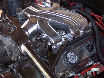

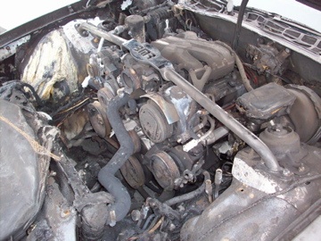

Yesterday, at 6PM, my engine looked like this...
By 6:30PM, it looked like this...

I was driving in traffic when it just died. Trying to restart it, smoke started billowing out of the edges of the hood. The fire department were there pretty quickly, although not that damn fast considering I WAS 100 YARDS FROM THE DAMN FIREHOUSE!! They could have chucked a bucket of water out their door and hit my car!
When they arrived, they took their sweet time getting their gear on- can't really blame them I guess, in case it blew up- but then one of them casually walks up and drops TWO 5 FOOT LONG PRYBARS ON THE GROUND NEXT TO MY SMOKING CAR- NO! I yelled to one of them opening my car door to 'just pop the hood!' and he holds up the a handle marked 'hood' with a burnt, fried wire hanging off it and yells back 'you mean pull this?' DAMN! The fire had burnt through the wire! Or else he just yanked on it too damn hard. Anyway this is what it looked like once they found a way to get their hoses in...

And once I got the hood up this morning...

I got it back from an auto electrician a week or so ago and it has been running rich and starting hard ever since. I was taking it in to a friend of mine today(!) to have it diagnosed!
It started from right around the EGR valve area. The EGR lead is melted onto the EGR and the sparkplug leads are white and chalkie. The leads on the other side just have soot on them, so it was on the passenger side. My mechanic suggested it might have been a short on the starter, since there is no fuse on that circuit, but we won't know for sure until I really dig into it- even then... the wiring harness is now almost one big copper wire(!).
I love this car- poly suspension all round, new shocks and struts, tires etc- do you think I should save it? I am too emotional about the thing at the moment to think straight. It will need all the wiring in the engine bay and EVERY ACCESSORY, from the radiator to the heater box replaced. Even the light bar sagged! The headlights all point down, particularly on the passenger side! It sort of has a sad, Lightning McQueen look on its face!

It looks like it was contained to the under hood area.
If it was me, and I had an attachment to the car I would at least attempt to fix it.

wow man atleast ur ok and the car dosent look to bad, start stripping the engine bay down and see how bad it really is.
besides the harness i can see u will deff need some new upper strut mounts, inner wheekl well plastics,headlight buckets?maybe some new front brake hoses were they are rubber, and check the front calipers for leaks
all in all not to bad
the power side harness will be easy to get used ( headlights, blinkers etc)
a good engine harness is going to be a lil harder,may i suggest the thought of installing a megasquirt ecm and harness

replace the strut mounts no matter what , the tops have rubber in them which im sure got destroyed in the fire.and as i said check the rubber front brake hoses .
take the tires off and check the backsides of them for melting or blistering from the heat
im sure ur going to have a bunch of melted sensors and other odd bits and pieces
u will prolly have to strip that engine bay down to a bare engine and inspect everything

I haven't pulled the stuff off it yet, but it got hot enough to blister the chrome on my STB!

micktroup2, have you found out what caused the fire, and even more so, why it was so large? Unless there is a lot of grease build up or a fuel leak on the engine there isn't all that much that can burn.
Some wire insulation, convoluted tuning, and some vacuum lines. What else is there. From one of you posts it seems that this may not have been an accident.
You have my sympathy regarding your loss.

It was an accident- it looks like the coil, an MSD by the way, let go and overheated. There is a serious heat mark on the underside of the hood right above it. No doubt the hood liner, being 20 years old, went up and spread the fire. The heat generated from the coil, since I was told it has some sort of oil in it, must have been intense.
The fuel lines went up when the fire spread to the driver's side, so I am sure that didn't help.
I know that the canister type coils are oil filled (the round can-like coils).
Although I believe that the stock coil is epoxy filled. This is the E type coil.
With the MSD coil, I have no idea what is in it. So that could very well have done it. I have an old MSD Blaster canister coil here that someone gave me. It is leaking oil from the top.
RBob.
