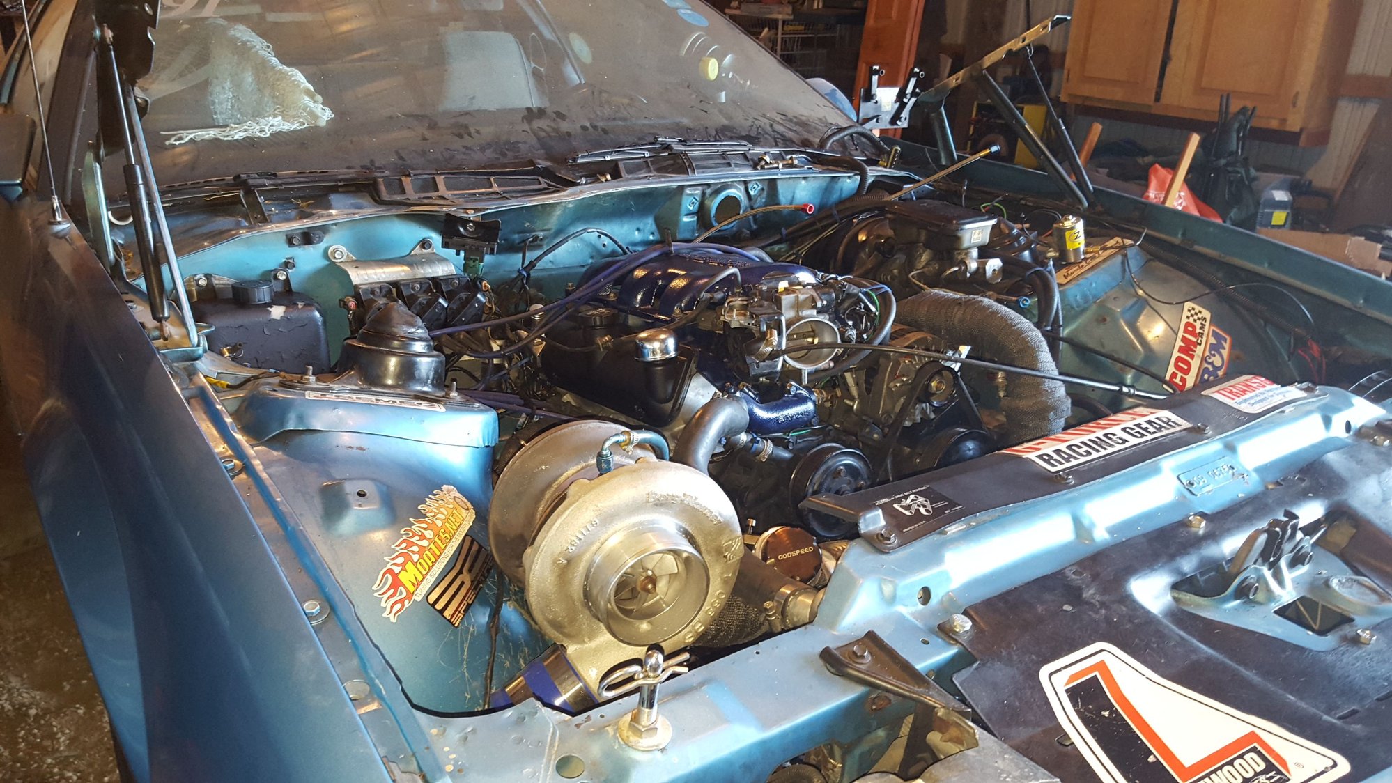

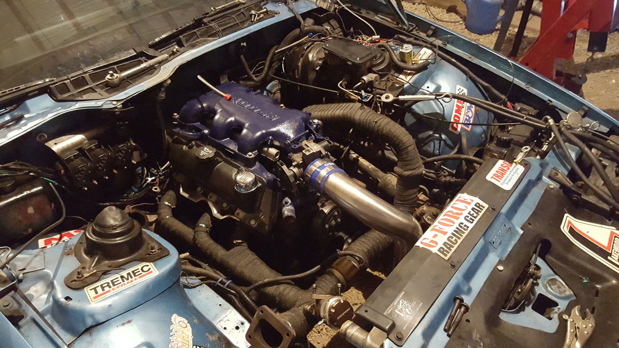

Here is the update pics. Ive had a little bit of time here and there and basically have the engine ready to toss back into the car.
I am running E85 now. I have 80lbs injectors in already, a 450lph walbro pump in already, both e85 compliant. I still need to get a AFPR because i doubt the stocker would last very long with all the ethanol.
I swapped in my 26986 comp cams behive springs with new locks and retainers. New lifters, and ill probly regret it but i tossed in this new cam I got with the motor. Its a crower cam. .550 lift on the ex. .505 on the intake. 108 LSA(which is what i dont like about the cam) and the durration is a touch higher then my 270 grind cam. If i dont like it ill just toss the 270 back in since it has less overlap.
I got my quench to be .052
I rechecked my P2V clearances many times over. The exhaust is .09375 and the intake is .1375 I would have liked more on the exhaust but there isn't much i can do about that right now.
I'm running 3400 head gasket and with that extra gap that added to my quench it also lowered the comp ratio to 12.27:1 Which is still really high.
My future plans. Just to get it to run and baby it the rest of the year. My expectations aren't very high. I just want it to run and make passes at the track. If it only can run high 12s or something so be it. This winter I plan to go forged 3400 pistons, but until then i just need to baby it and run very little boost to stay away from detonation and also to not blow anything up..lol
I still need to rework my exhaust a bit as i want the waste gate in a different spot to have better control on lower boost levels. Also i need to finish up my 3 inch charge piping. I know its over kill but the IC the TB and the turbo outlet are all 3 inch and i have tons of 3 inch SS 316 in my garage.. literally tons of it. So i though it would be a fun project to tig up some pipe for the car.

I would have had the car started but I ran into finding out that the pilot bushing on the crank was still in there. But I got it out now and all I have to do is bolt up the transmission and started up. I work the exhaust over a little bit so I want to run an engine without the turbo on it first so that I can blow out all the metal shavings that could have fell down in the pipe but it's ready to go else then that. I also need to hook up the n20 stuff.
I rewired alot as well. You might not notice from the pic but trust me when I say the wiring is much neater. When you add a boost solenoid, crank sensor, line lock, n20 heater, n20 purger, 3 n20 solenoids, a hobs switch, 2 elect fans (one strictly for the trans cooler), wb o2.....exc the wireing can start to get a tad messy...lol
