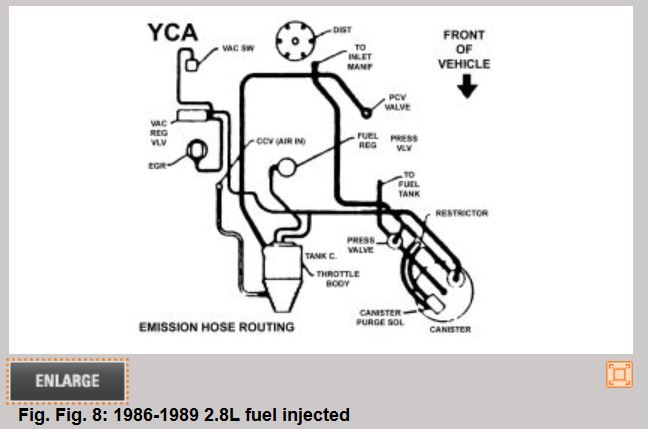

After pulling the plenum on my 88 firebird this weekend I realized the hose with the screw in it looks the right length to go to the fPR or fuel pressure regulator under the plenum. There are two plastic vacuum tubes that connect to the rubber block at the front of the plenum. One goes to the fuel pressure regulator and the other to the EGR solenoid or vacuum switch as it is referred to in the emissions diagram on the under side of the hood.
Attached Thumbnails Weird Engine Issue?-vacuum-emission-system-86
