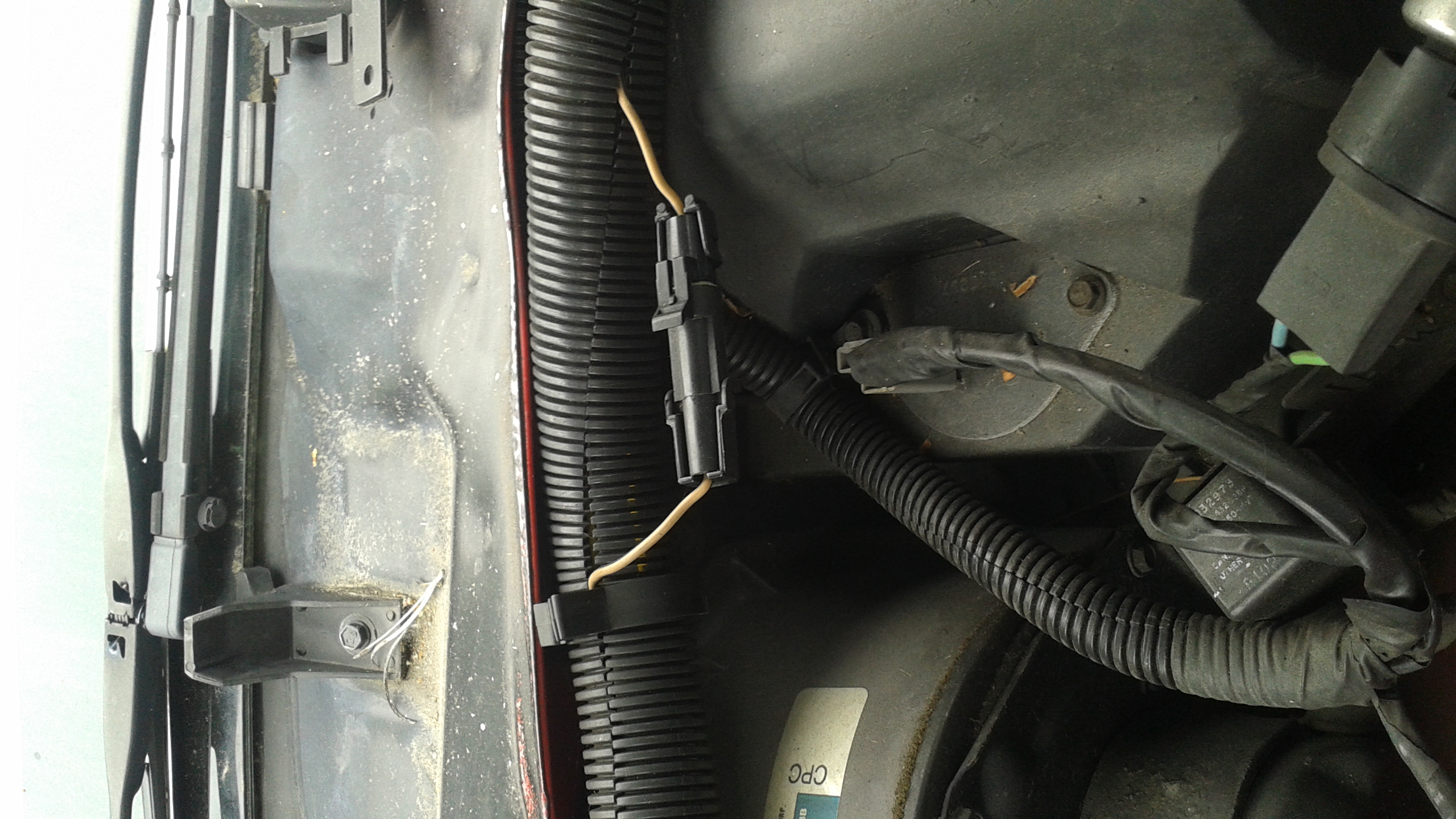

I have a 1989 Firebird with a 2.8l in it. The car ran like crap the other day when I purchased the car. Guy who sold it to me said it needed to be put in timing correctly. I have been trying to get it to run for the past 4 days and am at a lose now. I have put it at TDC numerous times and cannot get it to fire. I do get spark and it does get fuel. And has no codes except code 12. Any suggestions??? Attached are pictures of where the balancer and the distributor are currently sitting at, which from what I was told is TDC.
Attached Thumbnails Won't start. Help please!-20170522_201449.jpg   Won't start. Help please!-20170522_201917.jpg

Remember the number 1 wire is on the passengers side of our V6 engine. Also there are two TDC. One is exhaust stroke and the other compression. I use a compression test to make sure the engine is on the compression stroke.Another way is to pull the plug and a finger over the hole while cranking the engine.
A friend of mine replaced a distributor and put in 180 degrees of and the 4 cylinder BMW still ran but had no power to accelerate. Ran good once the distributor was installed in the correct position.
If setting the timing does get it to start try a little starter spray in case the issue is low fuel pressure or old bad gas. Remove the hose from the power brake booster and spray into the plenum. Replace hose and crank engine. There is a test port in rear of engine to connect a fuel pressure gauge.
Check the label near the radiator and shows timing 10 degrees BTDC. Automatic supposed to in Drive wheels blocked when setting timing. Disconnect tan with black strip wire passenger side on firewall to set timing with engine running. Reconnect wire after setting timing.

and I still honestly cant find this plug on the firewall. i found one that plugs into the coil harness and another that is on the firewall itself but it is a red wire instead of the brown with black line. anyone have a picture of it?

attached is label with timing 10 degrees BTDC when running with tan wire disconnected.

was about to ask if you disconnected the tan wire first but Mark beat me to it, it's right above the blower. If you have the timing reset to 0 I believe you can just pull the ECM fuse in the fuseblock for a good 10-15 seconds to reset it....

I will have to look again and see if we can find the wire. The smoke was coming out of the exhaust I believe.

Old May 27, 2017 | 05:02 PM
Grizz87's Avatar
Joined: May 2017
Posts: 103
From: Alton, IL
Car: 1989 Firebird
Engine: 2.8l
Re: Won't start. Help please!
Found to plugs both with tan wires and black line. Neither are above where the a.c. should be. One is on the finder other connects to the coil
Old May 27, 2017 | 05:37 PM
Mark RWC's Avatar
Joined: Nov 2011
Posts: 142
The tan wire does have a black stripe on it if i remember correctly. It connect to the computer.
One of the 2 you found problably goes to your computer
The computer uses it to advance the timing. If you get the car running you can look at the timing with it connected it probably will advanced roughly 20 degrees when .set to factory timing. To time the engine to 10 degrees as per factory label on hood tan wire is disconnected so the computer will not advance the timing.
I saw another thread of a no start the mentioned the pickup in the distributor can be a common no start problem.
Old May 27, 2017 | 10:31 PM
LiveIt!'s Avatar
Joined: Nov 2016
Posts: 348
From: Florida
Car: 1988 Camaro Sport Coupe
Engine: The All-Powerful 2.8l!! :P
If you're talking about that tan wire with the plastic clip connection that's not it, I confused it too haha. I think that goes to the tach. It looks like that, but it comes out of this plastic wire loom above the AC box. You may have to pull it out and see if it's behind the loom.
Pickup coil can be a bit of a pain to change but definitely worth checking out. you said it's getting spark, just won't start. If the spark is weak the pickup can be to blame, my car was exactly like that and ran like a champ after I replaced it. It's a cheap part
Old May 28, 2017 | 01:44 AM
Grizz87's Avatar
Joined: May 2017
Posts: 103
From: Alton, IL
Car: 1989 Firebird
Engine: 2.8l
i will have to look again. the two i found had one next to the strut and the other was next to the coil
Old May 28, 2017 | 02:08 AM
Grizz87's Avatar
Joined: May 2017
Posts: 103
From: Alton, IL
Car: 1989 Firebird
Engine: 2.8l
from what I remember that wireing harness that is in the picture doesnt have a plug in it. picture is kinda small though lol. and by pickup you do mean the coil right? cuz I already replaced that
Old May 28, 2017 | 12:46 PM
LiveIt!'s Avatar
Joined: Nov 2016
Posts: 348
From: Florida
Well they're both coils, did you replace the ignition coil or the pickup coil? You said the car was running with all those things replaced, the only leaves the ICM and pickup coil. If the car has been sitting for awhile and the pickup is original it's possible it could've failed, I had this happen to me. It's really easy to test. Take your cap off and take off the 2 wires running from the coil to the ICM. Get your multimeter, it should test as infinite resistance from either lead to ground, and about 500-1,500 ohms with both leads connected.
And sorry about the picture, I tried using a screenshot from your vid to be as clear as possible. Since the car isn't even running off fluid now I'd focus on finding it later, but it has to be right there somewhere.
Good luck
Old May 28, 2017 | 05:08 PM
Grizz87's Avatar
Joined: May 2017
Posts: 103
From: Alton, IL
Car: 1989 Firebird
Engine: 2.8l
No plug in that harness your pointing at. Still not starting
