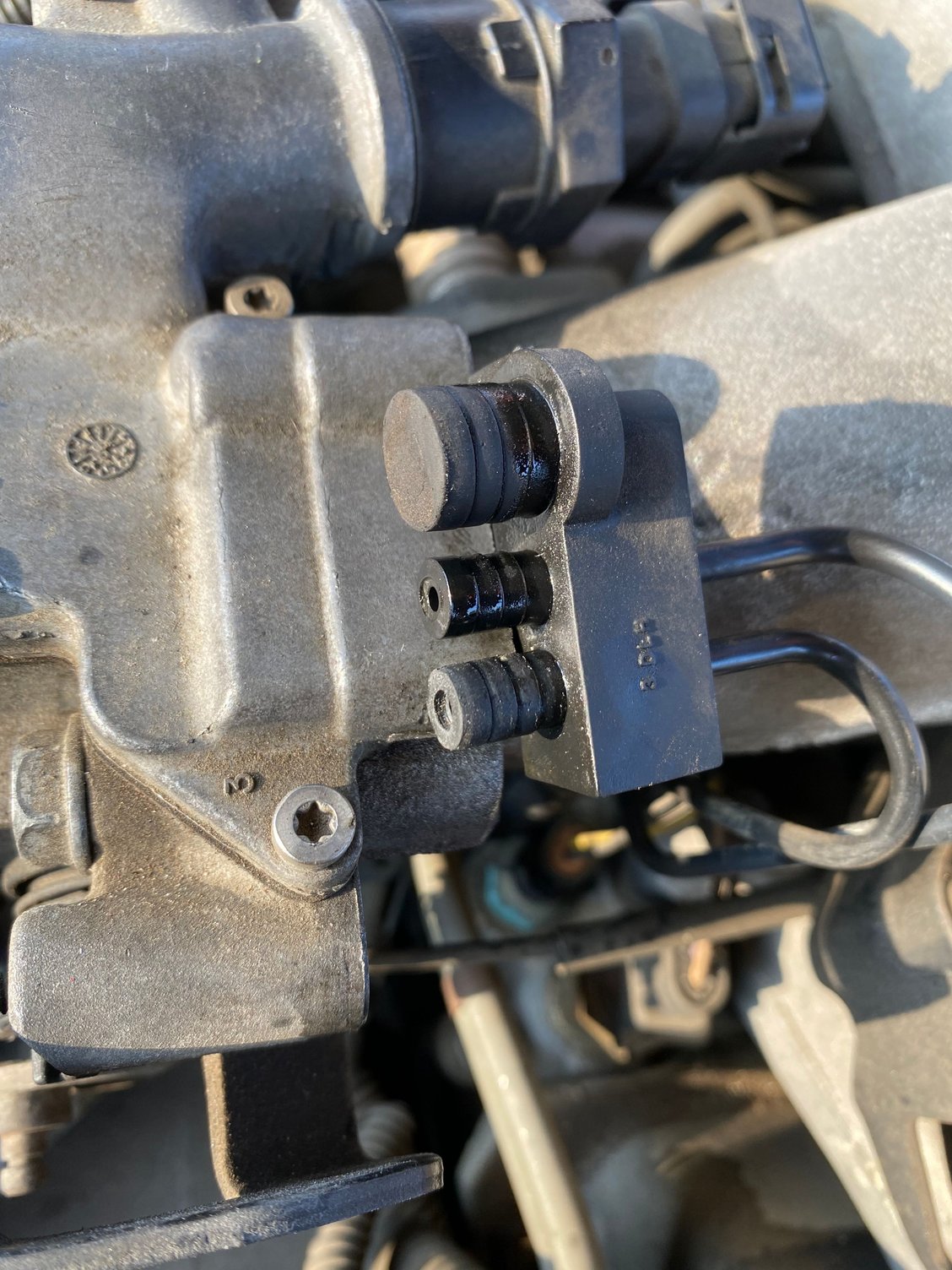

I recently bought this 1986 camaro rs with the 2.8 v6 almost have it ready to start but theres one more part I need and don't know what it's called it's the 3 port line that goes Into the top of the throttle body any help is greatly appreciated

I asked the same question back in 2018 except mine is still useable but barely holding on -- post is here: https://www.thirdgen.org/forums/v6/7...connector.html
The best answer I've gotten is to just call it "that weird vacuum port on the top of the throttle body" -- never been able to actually find a name for it or find it for sale, specifically. Probably your best bet is a pick-n-pull.

I know this is late but as far as I can tell it doesn't have it's own number it is part of the EGR VLV VAC Harness for the 86 the harness part number is 14094820 for the Auto 14094819 for the manual trans. I think they are the same not sure but the 1987 is 14102601 and looks like it will fit the 86 and they seem to have one here.
https://www.usaspareparts.com/parts/...r-vlv-vac.html
It is in england. Best I could find.
Wish I could find one for my 3.1 v6. one of my hoses broke not sure what to do about it.

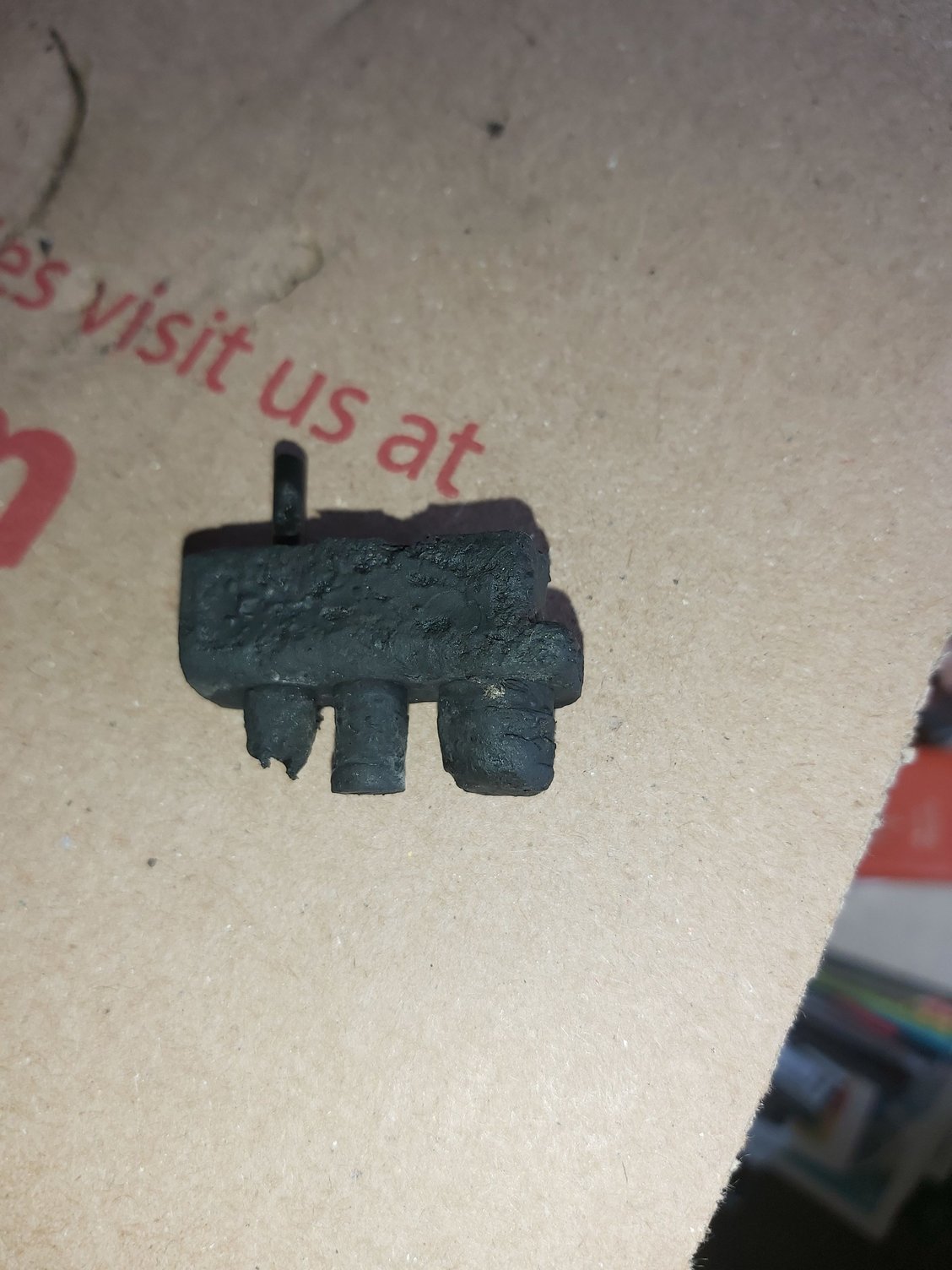

Hi I am to looking for this part. My firebird has a vacuum leak. I did the smoke test and the smoke is coming out from that part. I’ve tried surfing the web for it but it hard, since I can’t seem to find the name for it. Any solutions to this?
