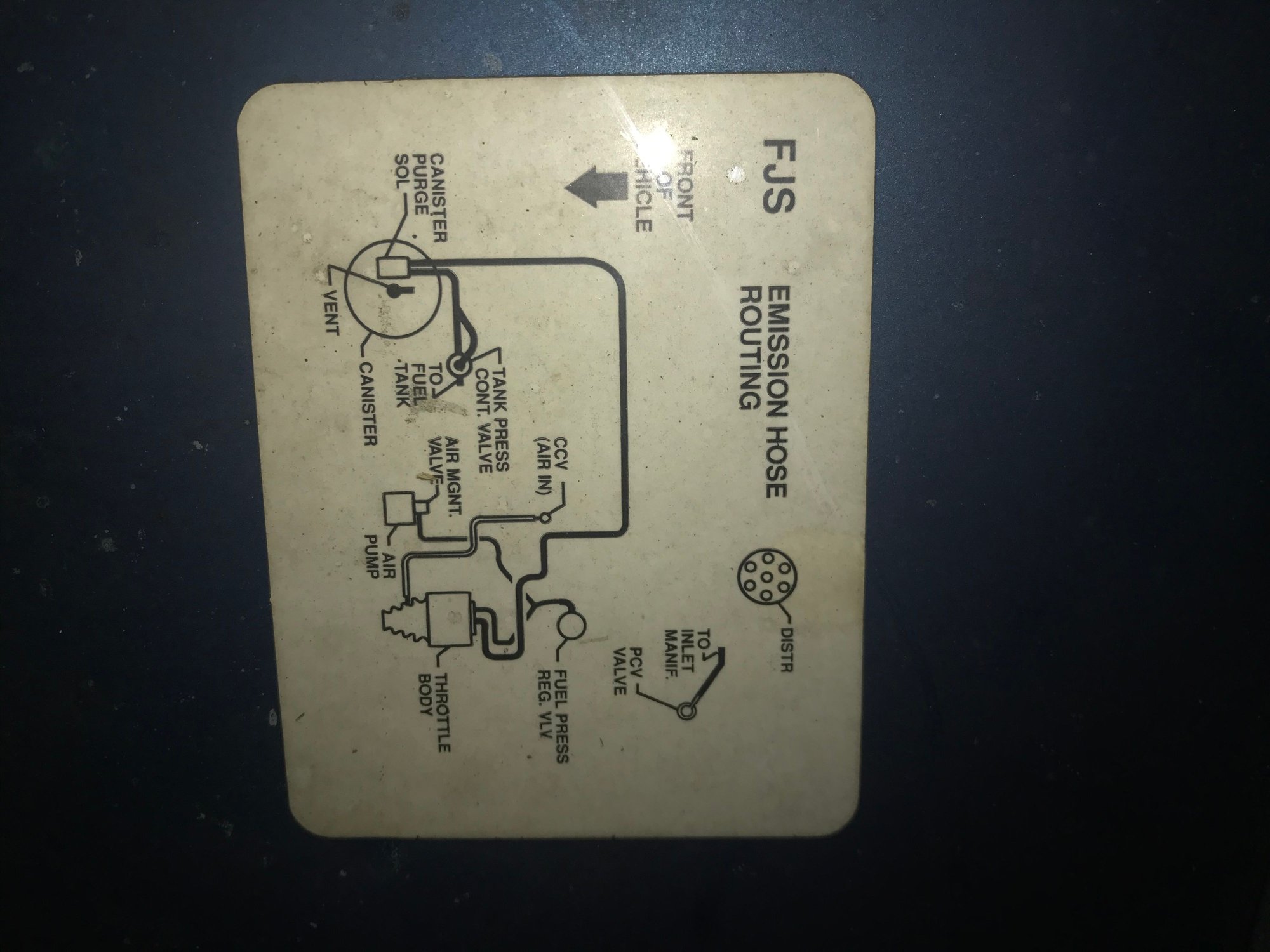

Help with vacuum lines
One
One of my vacuum lines from my fuel pressure regulator isn’t going anywhere, my diagram says that it goes to the air management valve but I can’t seem to find it, can anyone with a 3.1l V6 show me where it is?

Re: Help with vacuum lines
its the magnetic valve bolted to the smog pump
it is directly under the alternator
best you remove the pully belt and the smog pump than you have easy access
there should be a a electrical connector as well
