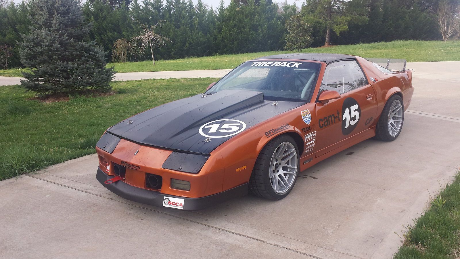

I am resurrecting this old thread because i am interested in upgrading to some 18x10 ForgeStar F14 wth a 6mm offset (which equates to 5.75 inches of backspace) (According to this chart)
and then I am considering a C6Z06 BigBrakeUpgrade, hopeful that those wheels willl tuck under these brakes. I am not opposed to running some small 5mm spacers to push the wheels out toward the fenders (as I have been doing that for years), which would reduce offset, but i want to double check before a make a big $$ purchase. I am a racing application so I totally oppose spacers MORE than 10MM, i won't do it. PERIOD.
My car has GroundControl, is lowered a couple inches and I run Koni Sports all around
I'm going to run some 275 tires on front (and maybe 295 rear), do the wheel guru here have thoughts on this setup? I love BFH and have NO problem using it..

ok, i pulled the trigger. After talking to the wheel guys it turned out I was calculating things a bit wrong from the current spacers.
So here's the current proposal:
Front: 18x10 ForgeStar F14 Super Deep Concave with -13 offset
Bright Metallic Silver with 10MM cap to cover hubs
Including 70.3 hub ring to mate the wheel on front
Rear: 18x11 ForgeStar F14 Super Deep Concave with 9 offset
Bright Metallic Silver with flat cap to cover hubs
Getting hollow back lug nuts in 12mm x 1.5 pitch pattern so my ARP fasteners can come all the way thru the lug.
Delivery Dec 15th, $1600 from getmywheels.com
He's double checking the chrome finish, but likely going to be bright silver.
I don't expect to need any spacers, but have a couple 5MM handy just in case.

Idk I dont agree with the front offset, I ran about +5 mm offset with a 18x10.5 and that's about it. Those wheels will stick out. I need to run some numbers but unless you have some weird front suspension setup that will be a problem. Unless you meant +13 for the front
rear should have around +12mm to avoid a lot of metal work, or around +22 if you don't some cutting and want to keep them under the car a little

Ok I was running what would equate to 5.95" of bs on the front with stock brakes. The wheels your looking at have 5" of bs. That will never tuck unless you fenders are cut because racecar?? Any brake upgrade would require more backspacing to match the added hub offset

On the rear i was running a 18x10.5 with +17mm offset. Fit like glove with a little hammering to front of wheel well.
an 11 would need 6mm less offset, to avoid cutting, but will stick a hair outside the wheels well.

OUTSTANDING, thanks for your advice. My though was if I was off by a little bit (larger offset that is), that I could run those 5MM spacers to push the wheel out. My suspension is Koni Sport with BMR lower control arms but everybody bolts into stock positions. Nothing too extreme, i should follow your advice.
I solved my Steering Stop problem tonight, so I will have the ability to adjust lock to lock and stay OUT Of the inner fenders now.. I am very pleased and it allows me to follow your advice on front offset.
So in conclusion, you are saying a little more offset. OK. you are running front 18x10.5 with a +5 offset (which equates to an 11 offset on a 10 inch wheel.) according to TGO calc.
So here's the current proposal VERSION #2:
Front: 18x10 ForgeStar F14 Super Deep Concave with +11 offset
Rear: 18x11 ForgeStar F14 Super Deep Concave with +11 offset

ok, first time off the lift (she's dirty as hell), but here's the first picture after the test drive.
NO RUB. 18x10,275 up front, 18x11,315 BFG Rivals-S in rear. Still have to fabricate and install the new steering stops (should be easy), and I have HUGE list before the first event of the year.

Those look really good on there! I just put in my order for 18x10 and 18x11 for mine yesterday. Can't wait! What type of events you gonna run this season?

Updated pictures after I finished up a few more of the details..
