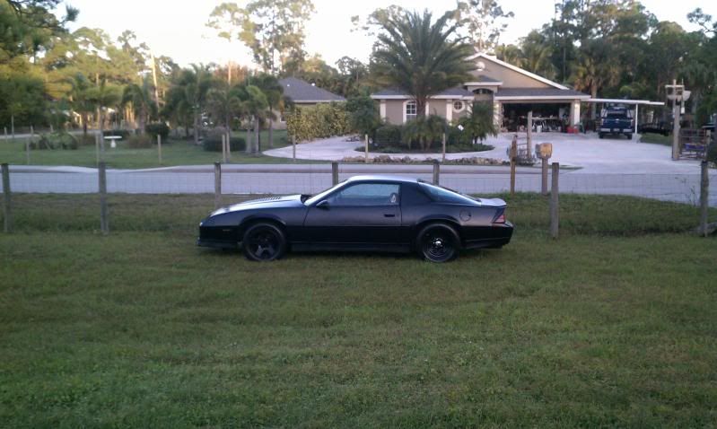

Cragar 17x9 Soft 8's probably. They're so heavy, though.
They dont look bad on these cars.
http://www.summitracing.com/parts/crr-3998955/overview/
The only others close are the 17x8.5/18x9.5 C5 wagon wheels, and 17x9 or 17x9.5 ZR1 wheels. The ZR1 wheels can be had for ~$60-$100 a wheel usually. You'll need to add $40-$100 a wheel for adapters, though.

That is is a Chumpcar we have a set of wheels on - he previously had the soft 8s in 8" width. All he did was change the wheels (keeping the same 245 width Dunlop Dirrezzas) and the car picked up about 3 seconds a lap on the road course. There was a 55lb reduction in rotating weight and the sidewall had much more stability as the wheel is 1.5" wider. Feedback was the handling and turn in were razor sharp and the car felt like it picked up 25hp (55lbs of rotating weight will do that). This is an extreme case though - not too many people have 34lb wheels on their 3rd gen.
I want everyone to understand this as something to optimize your cars - you want the widest wheel and tire (but not too much tire on a given wheel) and the lightest weight (within your budget) combo within reason. Exotic car guys spend thousands to save a few pounds on their wheels - CF wheels are $15k a set, save 20 to 35lbs, and are extremely fragile.
A set of cheap ZR1 9.5" wheels with spacer might push 28lbs (guesstimate?), but going for a 20 or 22lb wheel will have the effect of adding another 5 to 15hp due to less rotating weight.
