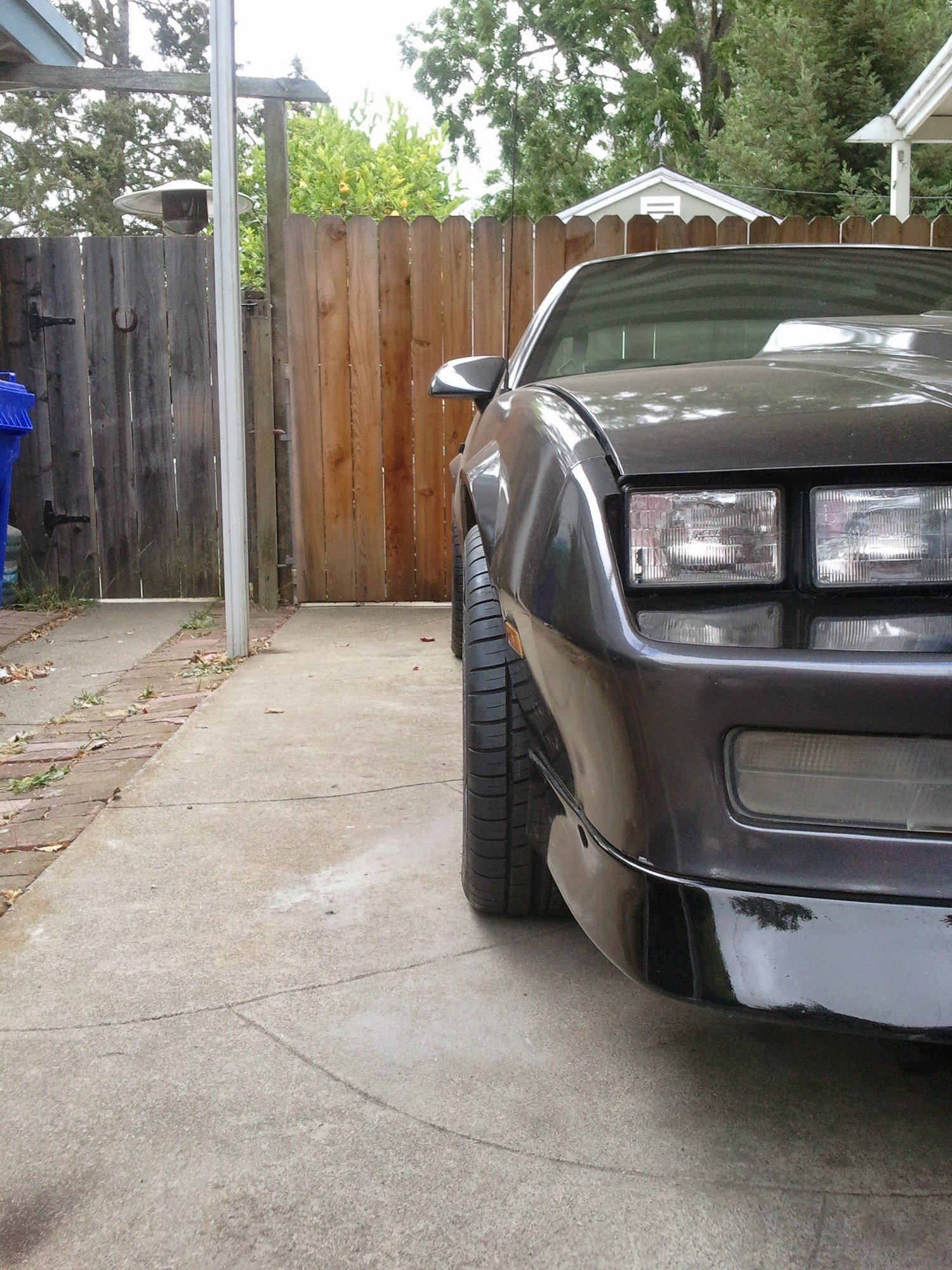

Here goes the rear.
I measured the clearance with a level.
2mm F and 8mm R to the fattest portion of the sidewall. 277mm wide tires.
The tires do not rub anywhere except full lock on the frame/swaybar.

Thanks heaps man.
I'm quite fond of the old school style of the 675 Ridlers.
They look good on the car and they are CHEAP @ $144 each + freight.
I figure a bit of -ve camber will take care of the front ( if not I can chuck the 15's back on for inspections).
The rears give me 3mm leeway so all good there.
I really appreciate you taking the time to do that......thanks!

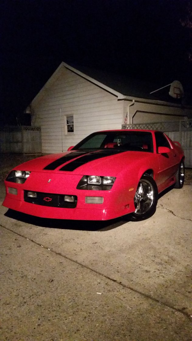

I have 18x8 in the front and 18x9.5 in the back. Both zero offset. Ridler 695 I believe.

Nice looking car mate!
