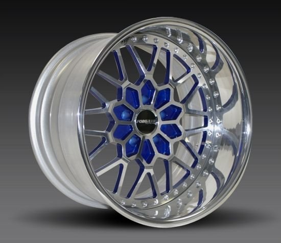

Future wheel set up help
I am completely redoing my whole car and the look I want requires new wheels. As far as I can tell, I should go with 18" wheels so I can have more clearance for tie rods and stuff like that? Originally I wanted to go with 17", but after reading it seems the 18" wheels would work better.
Ideally and if it is anyway possible at all, I want to run 18"x10" in the front and 18"x12" in the rear. Front tires being 295 and rears more like 315 to 335.
BFGoodrich g-Force KDW-R Tire
Forgeline TA3 Wheel
I need help figuring out what I have to do to make these work. What offset/backspacing? What do I need to clearance on the car? The hardest part I have found while doing research is that I need to keep my rear seats. So I can only tub it so much. (How much is that?)
Any help will be very much appreciated. If you find some links or something that I didn't than please post them and I will go read them. Just trying to figure it out so I can go buy some more parts to get the project moving forward.
The rear end is going to be the Hawks Custom 8.8" that they make bolt-in for our cars. Looking to run the factory 3rd gen length, unless I can shorten it to be able to fit the wheels and tires back there better? Wheels must have a lip in the rear if anyway possible.
Hawks 8.8" bolt-in rear-end
If it matters, the front brakes are going to be Baer Pro+ Front brakes with the 13" rotors. And the rear are going to be Bear Rear SS4 brakes with the 13" rotors as well. (Looking to do dual rear calipers, the second one being for a hydraulic handbrake; so might have to go with the 12" rotor in the rear.)
Front brakes
Rear brakes Blue Ice
Thanks in advance for any help and/or advice.
