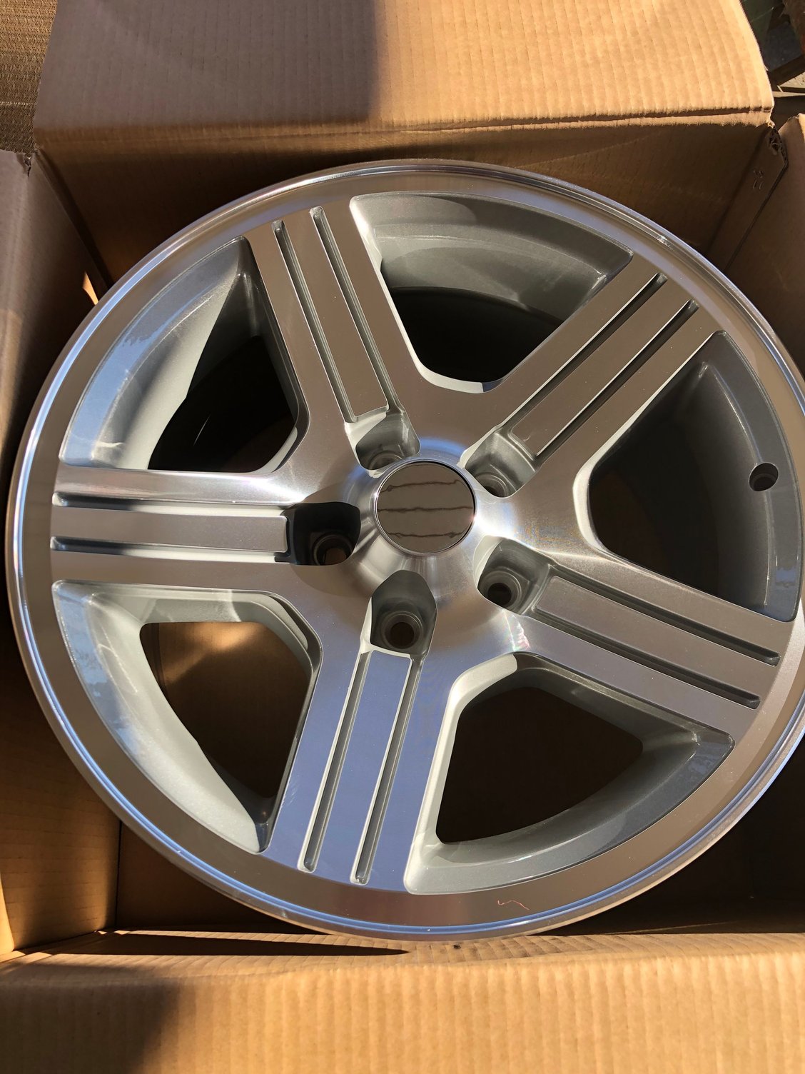

Mine arrived today...carefully wrapped to prevent damage. Paint looks very good to me...
