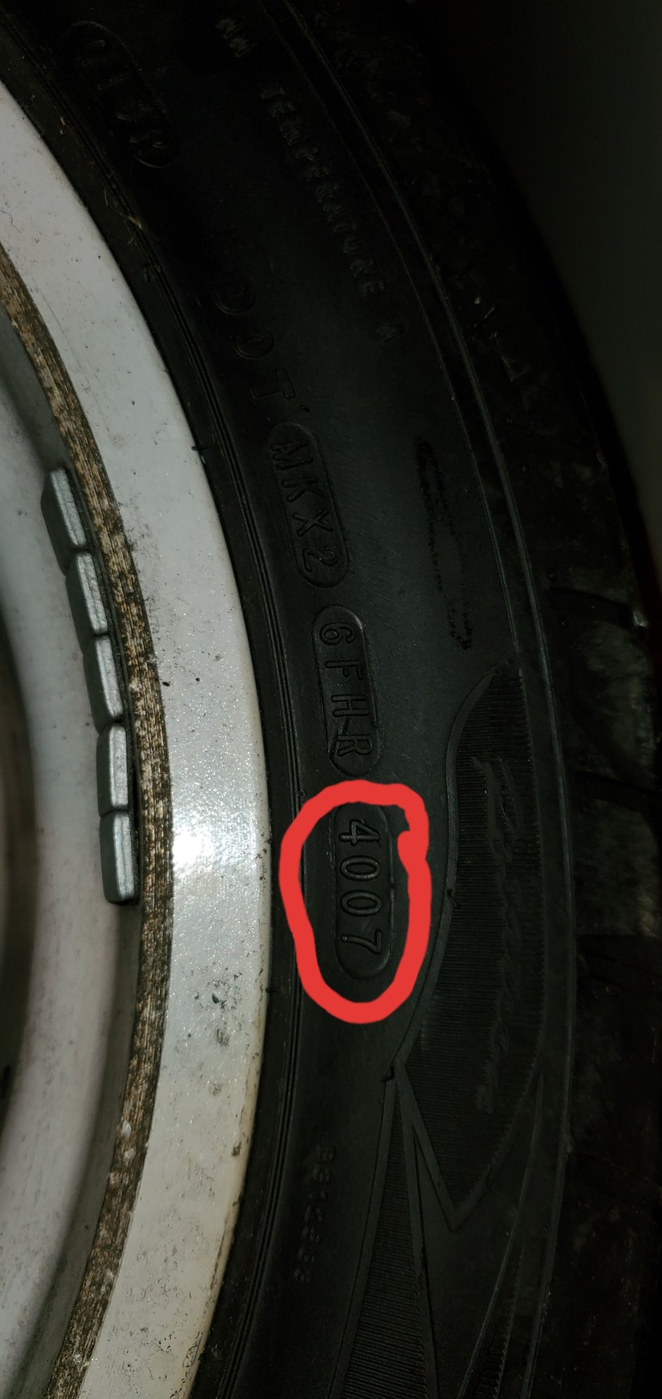

this is the date code on my GS-D3s

Thanks Scooter. I need to look again. I can't tell from your pic, does it say "DOT" in front of that somewhere?
Mine do note have "DOT" on them. Which means they may be really old. The date was required starting in 2000. Yours were manufactured in 2007.

That's not correct about the date coding, tires all the way back to the 70's still had date codes, but they were only 3 digits
https://www.cokertire.com/blog/tire-age
Yes, there are three ovals, one with the date code and two before it, then there is DOT at the front of the ovals
