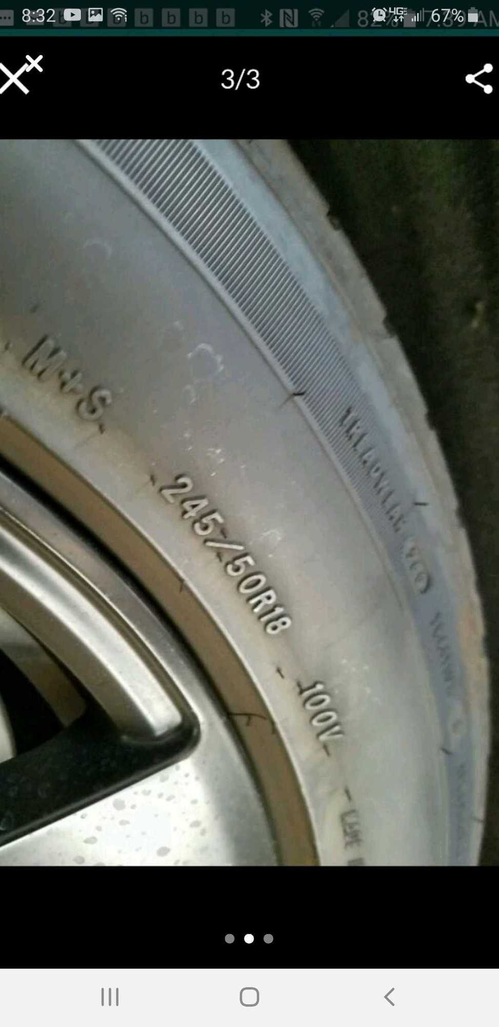

These are 2017 factory Camaro wheels, will they fit on 3rd gen ?

Spacers?

Spacers yes. The tires are much taller than stock, could be a problem on the front

No, they won't fit. The bore is too small for a 3rdgen hub to fit through it.

I think the 6th gen Camaro uses a different bolt pattern too.

probably with 2" non hub centric spacers and you will need 5x4.75 to 5x120mm adapters.
You also may need to hone the center bores a little.
