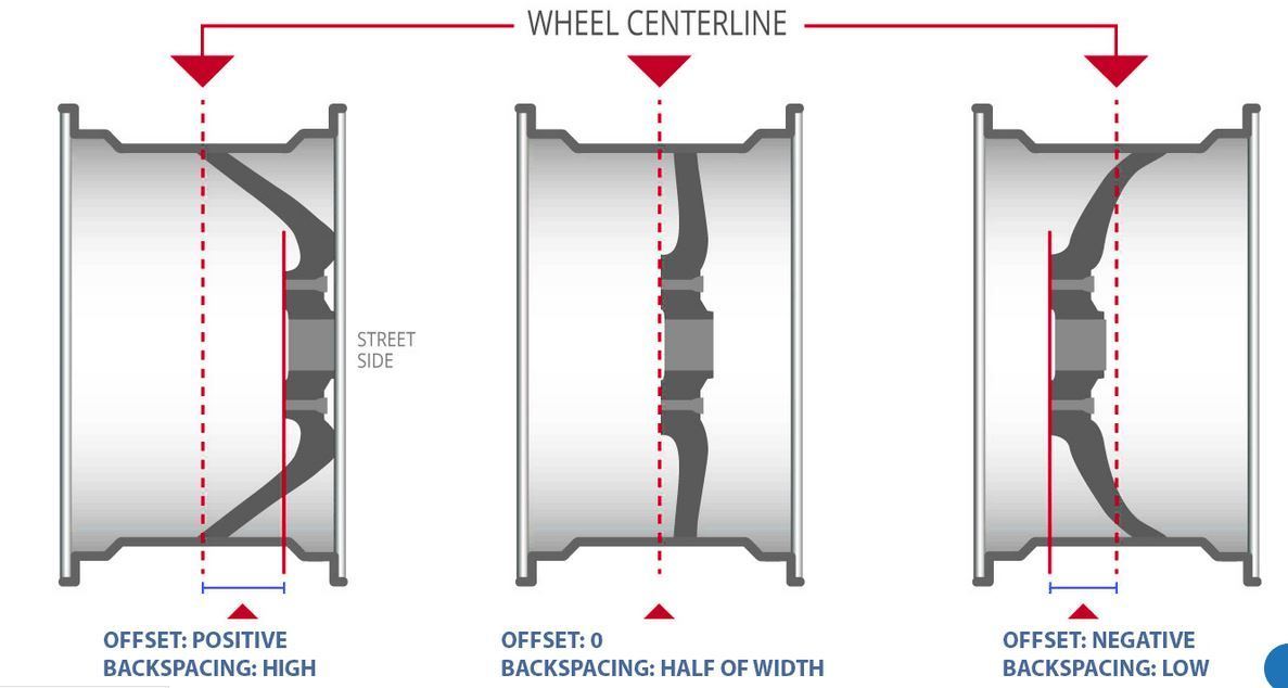

No problem....I've attached an image that will hopefully help show what the offset is.
As for tires, You're right about having more choices with 17", although it's not an overly common size either, and in another 10 years, they may be hard to find too. Still....I do love the look of 17's!!! .....so if you get a 17" x 8" wheel with "0"mm offset, then yes, your logic is correct in that you shouldn't have any fitment issues. You just need to make sure you keep the overall diameter of the wheel/tire combo the same. A stock 245/50/16 tire is about 25.6" inches in diameter. If you buy a 17x8 wheel, and buy a 245mm wide tire, you'd need a 45 sidewall, which would give you a 25.7" diameter. -so tire size is 245/45/17. ...with an 18x8, you'd want a 245/40/18 tire to keep you at 25.7" diameter.

...and the image
