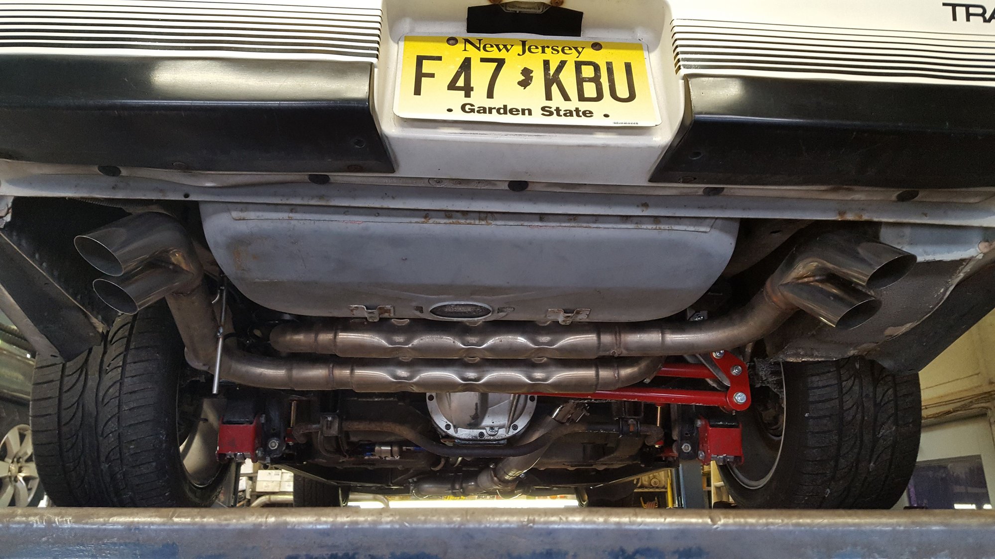

Re: 8.8 Rear Wheels and Tires
My 8.8 was cut and welded to factory thirdgen width. When It was first built i was using my 10 bolts axles (28 spline). Im running billet specialties street lites, 17x9.5 with 5.5in backspacing.
