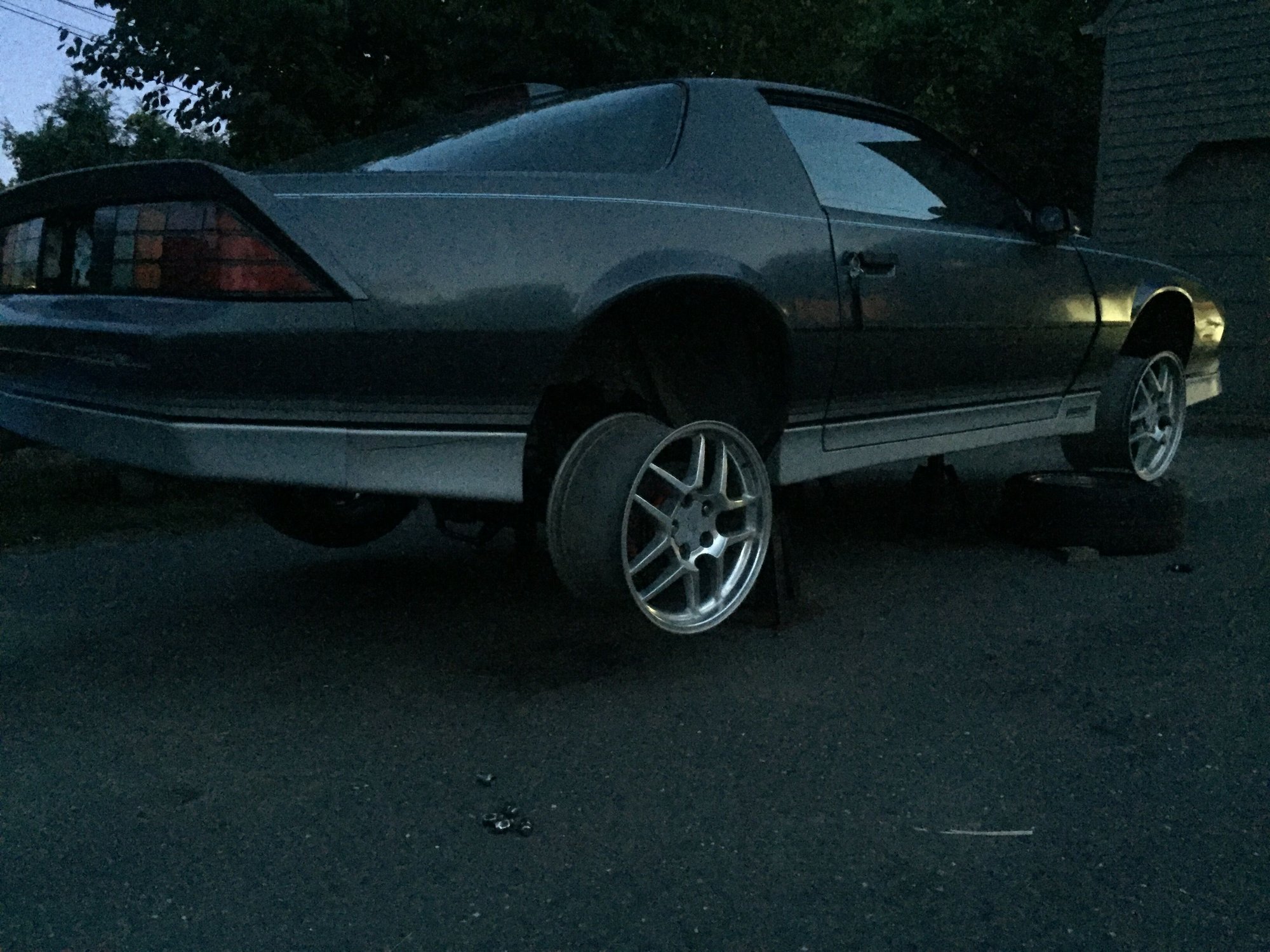

I purchased Zo6 18x9.5 replica wheels. What is a better size for them? 275/35 or 265/35 18’s? I am going with the eibach sportline drop. Also any pics would help. 👍

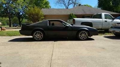

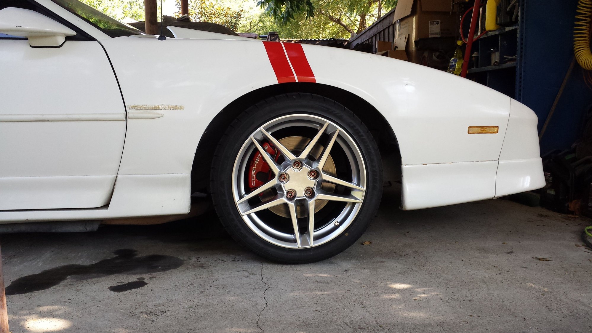

I run the Eibach sport and have 275/35/18 on the front with no issues

That looks good. What do you have for spacers?

I wonder if the difference in height when using the same springs has do to with the springs themselves being different or the car structure.

2 inch hub centric

My Bird currently still has the V6/700R
in it and sits higher than my Camaro with Eibach Pro springs and a 350/T56 which has the same rims style as yours but in 17X9.5F & 18X10.5R
