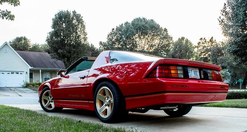

Ok guys I'm gonna be getting 18s iroc replicas for my Camaro and I wanted to know if 295 30 18s would fit on the back and not stick out and look dumb...don't worry about making them fit if I have to roll the fenders I will

Factory rear Irocs are +16mm offset. Lots of guys run FRONT wheels on the back, which are 0mm offset, or run aftermarket zero offset wheels. Here's a pic of my car with 0mm offset wheels on all four corners and a 275 tire. With a 295 tire, you'd of course have 10mm more outside, and 10mm more inside.
