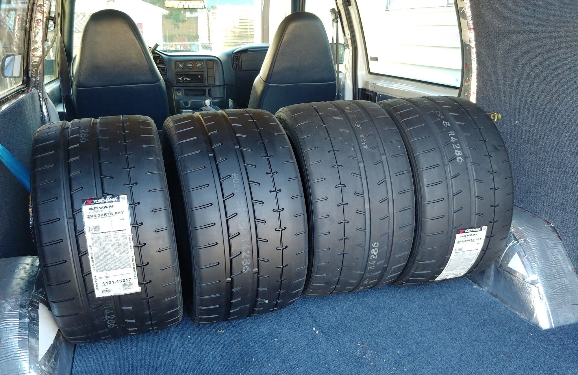

Autocross Cheater tires A052 review
Interested in autocross?
Want to beat new 5th or 6th gen Camaros in your ****** Mobile?
200TW Autocross tires are the way to go.

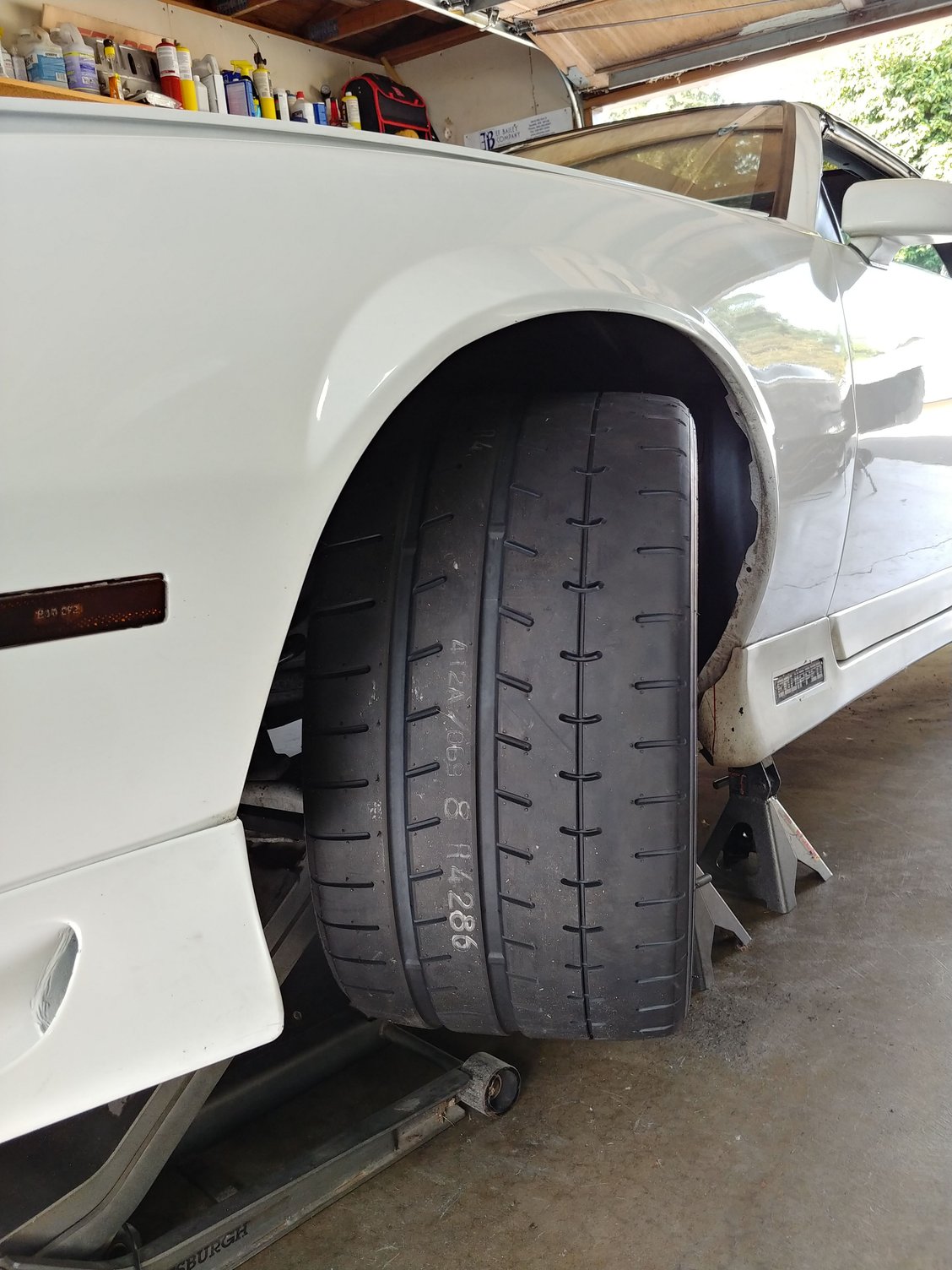

Here's me experience with running the Yokahama 295/30R18 A052 tires on 18x11 wheels
​​​​​​Quick review:
pros: stupid amount of dry and wet gripWarms up basically after 1 lapPuts easily 1 second on older tires like the BFG Rivals.
Cons: very expensive tireWears out fast due to soft compound
needs -2.5 or more negative camber to work rightSteering feel isn't very crispGets greasy and falls off after 140F carcass temp.
not a good road course tire.
Dry grip:
theses tires are very very sticky
After 1 lap the tires are basically ready to go 100%
my 92 with a giant 10in spoiler and a stupid amount of suspension work, can sustain 1.29-1.31Gs in corners.
I can't comment on putting power down, as my 92 is a low power car for the time being(LS swap coming soon). I can't even do a burnout with these tires because they stick so much.
the A052 don't have the crisp steering feeling like the now end of life RE71R or current RT660 tires. However the steering input is acceptable.
the overall grip is fantastic.
nothing like beating a AutoX prepped 6th gen SS 1le and having the owner look at your Turd gen in contempt!
Tire temps and pressures:
I run these tires at 35psi front 36 psi rear.
If I had more camber,(like -2.75 or -3.0) I could get away with less pressure in the front.
Even better if you are running a Cambered axle.
Unfortunately I don't have one.
The tires get maximum grip at around 120F-130F
And quickly drop off.
One dual drivers event had my front tires at 157F and were a solid 1 second slower than previous runs. I didn't use my water sprayer because I was testing to see how much heat they could handle.
Although I know people that use these tires for road course racing, they are not ideal for that situation.
Wet grip:
Nearly unbeatable wet gripThe soft compound allows you to hold an excess of 1.0G even in the rain.
While other 200TW tires like BFG Rival tires have garbage grip in the wet.
The A052 are a good choice for anyone in a region that gets a lot of rain.
However, the A052 do not like standing water for obvious reasons. The A052 will tend to hopp or vibrate when driven through standing water (1/2-1in) They do alright considering, but if there's standing water; use a summer tire like the 4S.
Cold grip:
Just like the wet grip, cold grip is fantastic
They warm up fast even on super cold days.
I ran an event that was 36F, and run 3 and 4 had enough heat to get the tires to stick.
Even though Yokohama recommends not using the tire below 45° f, more than half the paddock was on the same Tire.
Wear:bad, all badThe wear is fastThe tire compound is extremely soft with very soft side walls.
that means wear is VERY prominent.
The tires also need negative -2.5 or more camberThat means the rear tires will like to eat the outer shoulders. Being able to rotate tires is a MUST here
​​​​​​If you overheat the tire and go above 150F, the wear gets WAY worse. It's an Autocross tire, not a road race tire.
My tires after 88 runs, 44 rains runs, 44 dry runs.
5/32 tread wear even across the tire.
Sizing:
As with most race tires the sizing on the sidewall is not super accurate.
These 295/30R18s are 12.25in wide and are wider than the 315/30R18 Toyo 888R tires for example.
they are very very wide for a 295 and fit well on a 18x11 wheel.
they don't like being pinched on small wheels. The same 295 on another guy's 18x10 wheel was wearing 3x faster than mine.
The REAL width is measured with a soft tape measure. Measure from the side wall wear arrows and that gets you the labled width of 295mm.
Tread depth is 6/32 new. Yokahama claims it's 7/32 but that's not accurate.
​​​anyways, a quick run down for those inclined for turns.
After 88 runs, 44 runs being rain laps. Worn down 2/32 so far
Overheated A052 Dual drivers and 18 runs at 157F temp with a Pyrometer.
Going to get the tires mounted
295/30R18

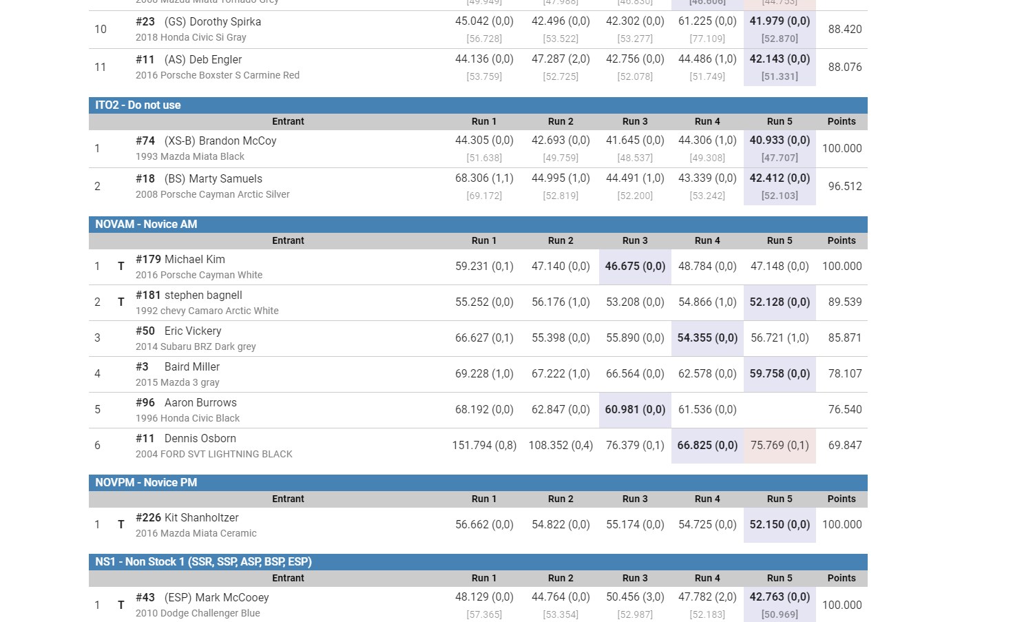

Any chance you want to post a link to the timing results from this event to show everyone evidence to back up the claims that you outrun everyone? If it actually happened at a SCCA event the results will be posted online on their website.

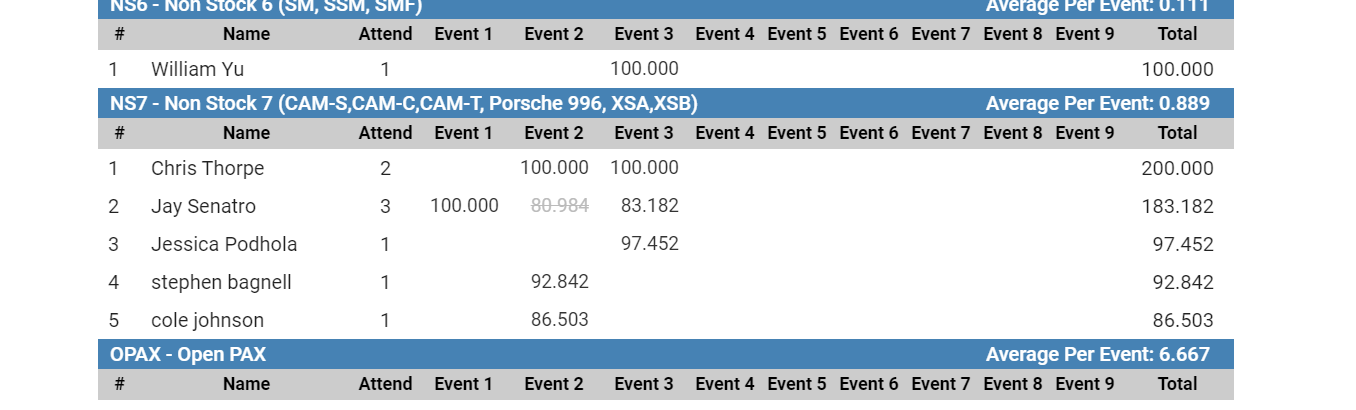

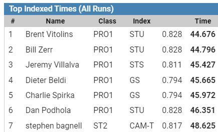

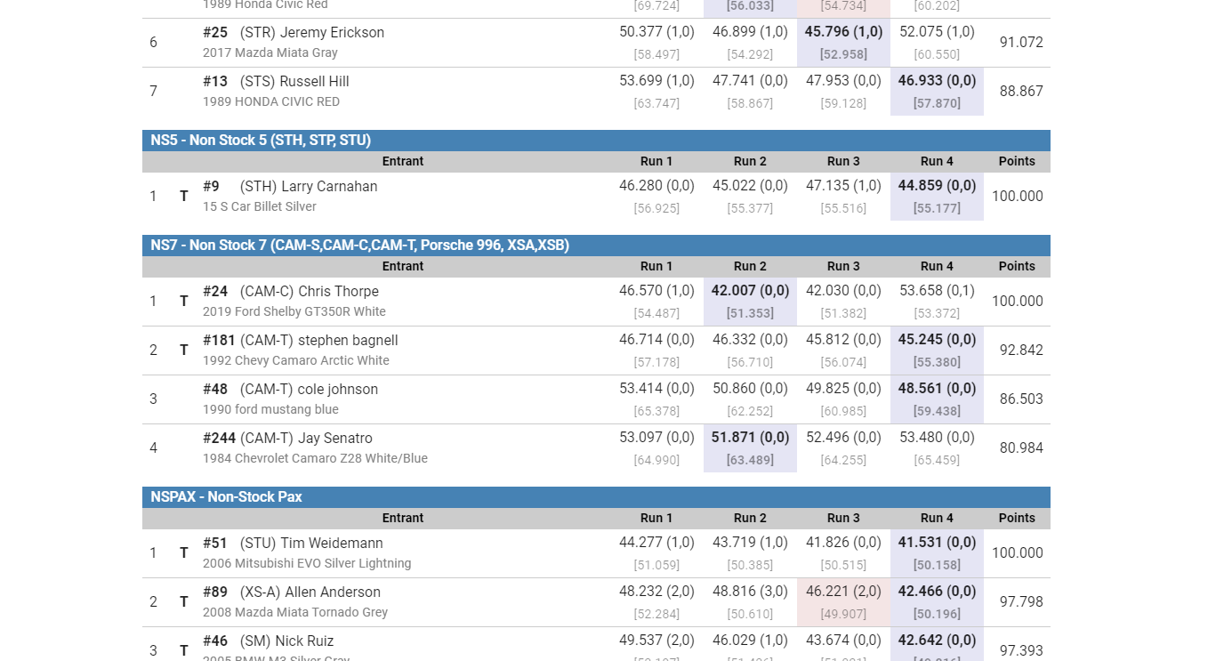

MCLOVIN1181 - Never mind. I found the link. https://nwr-scca.org/solo-latest-event/ Shows you coming in 50th out of 64 cars while running in Novice class in the March event and 5.5 seconds off the lead in your class at that event. 50th out of 82 in the April event in CAM-T and 3 seconds behind the newer Mustang. Oddly I don't see any 5th or 6th gens even competing in those events to see how well you did compared to those cars.
Honestly, with the way you post about how great a driver you are, how fast your car is, how much better engineered your setup is, I expected a much better performance and to find you running a class other than Novice.

I haven't run in the novice class since 2019, you are looking at the other white 3rd gen in my area.
Furthermore, I've been #2 in the CAM-T class in the last event I went to.

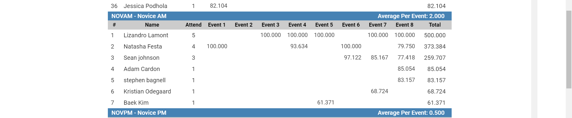

Interesting. Those March results show class NOVAM for a 1992 Camaro under your actual name. Are there two people with that name driving 92 Camaro's in the NWR SCCA region? And, yes, you were 2nd in CAM-T at that event. By 5.5 seconds in your class. Same with the April results. It was a 4 car class. Same driver name. Description shows a 1992 Camaro. 2nd place by 3.2 seconds. If these aren't the correct event results, what is the link to the other timing records? Even the car number in the results list matches the car number in the photo in the first post of this thread. Are you sure these aren't your racing results?
