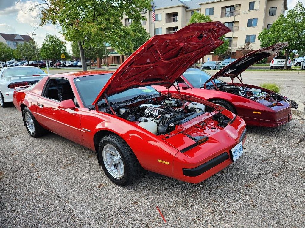

I'm not sure which wheel you have, but I know the PW7 wheels (see photo) have different offsets front and rear. The fronts have a deeper dish to them, and a lot of folks prefer that look at all 4 corners. So they will get an extra pair of front wheels and run them on the rear.
Here's a car with the PW7 wheel.

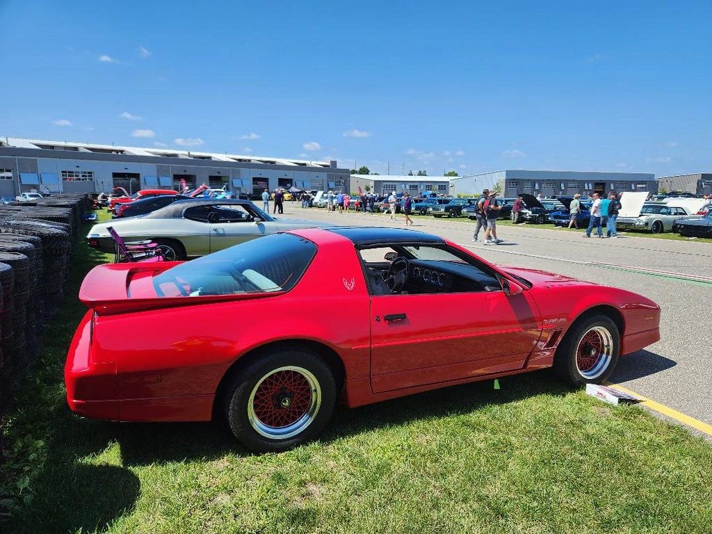

Your car may have this style of wheel....I'm not sure if the offset is different front-to-rear on this style of wheel or not.
