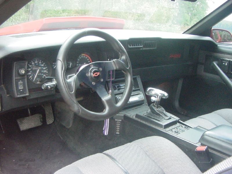

I found this picture on the forum somewhere.

The pictures that followed Fireturd's last post were of a camaro console and of no use to me, but they look good anyway Wishmaster

if you look closely, i found this pic from a camaro on ebay, it looks like he shoved a hammer shifter within the stock console. i thought it was only the handle, but if you look closely it looks like the whole shifter mechanism and the shift lever thing that you pull up to shift. basically the whole hammer shifter without the boot or mounting plate thing. i could be wrong, but its a thought

Originally posted by GTA-SPD
Unfortunatley no. I never got around to taking pictures because my truck got stolen around the same time and that took precedance. By the time the truck issue was resolved, I had already pulled it out and started the 6sp install. It looksed as if GM put it in there. I did it that way for two reasons. First was the metal plate thing (it looks like hell on a GTA console) and second was I hate those accordion rubber shift boots. They look cheap and quite *******. After spending 7 years working on imports, the rubber shift boot is a big NO in my cars. I'll see if maybe my wife may have gotten some actual film pics of it, but I doubt it, she was mostly taking pics of the outsides of all of our cars for future insurance issues. I'll let you know if I stumble over any.
did yours look anything like that picture i posted above, where you can see the shifter mechanism metal part sort of at the bottom, or was your install a little cleaner than that? sounds like yours came out nice.
Old Apr 23, 2003 | 02:00 PM
GTA-SPD's Avatar
Posts: 716
From: Parrish, Florida (Glad it ain't Vegas)
Car: 94 Corvette
Engine: LT-1
Transmission: Freakin Automatic---For Now
You couldn't see any mechanism at all. It looked like the factory set up, just with a different boot. I attached the boot where the top of the rubber one was supposed to go and it set down in the hole just like factory. In fact, I didn't cut my console top AT ALL, just bolted the new boot in place of the grey factory one, and that's it.
