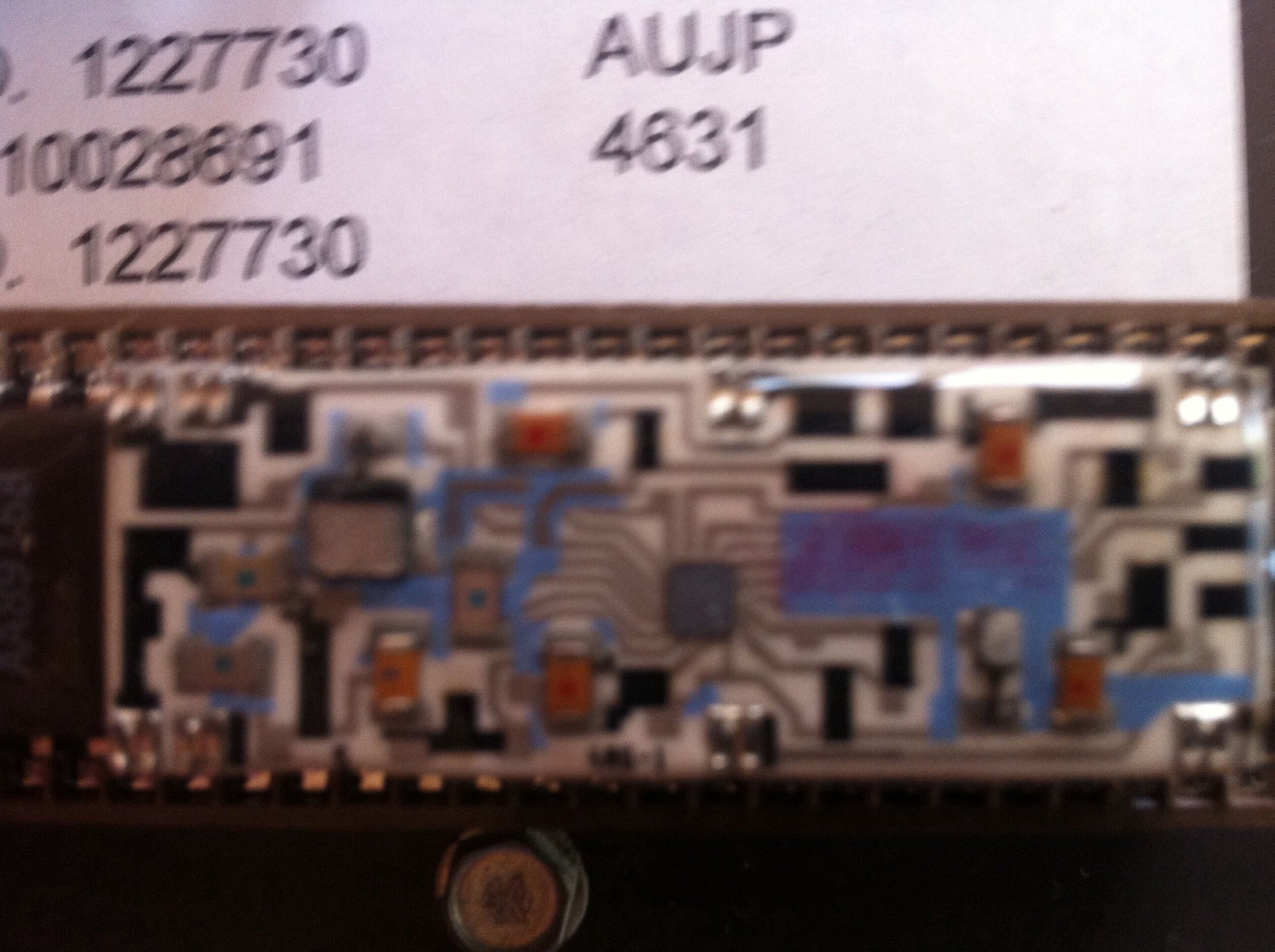

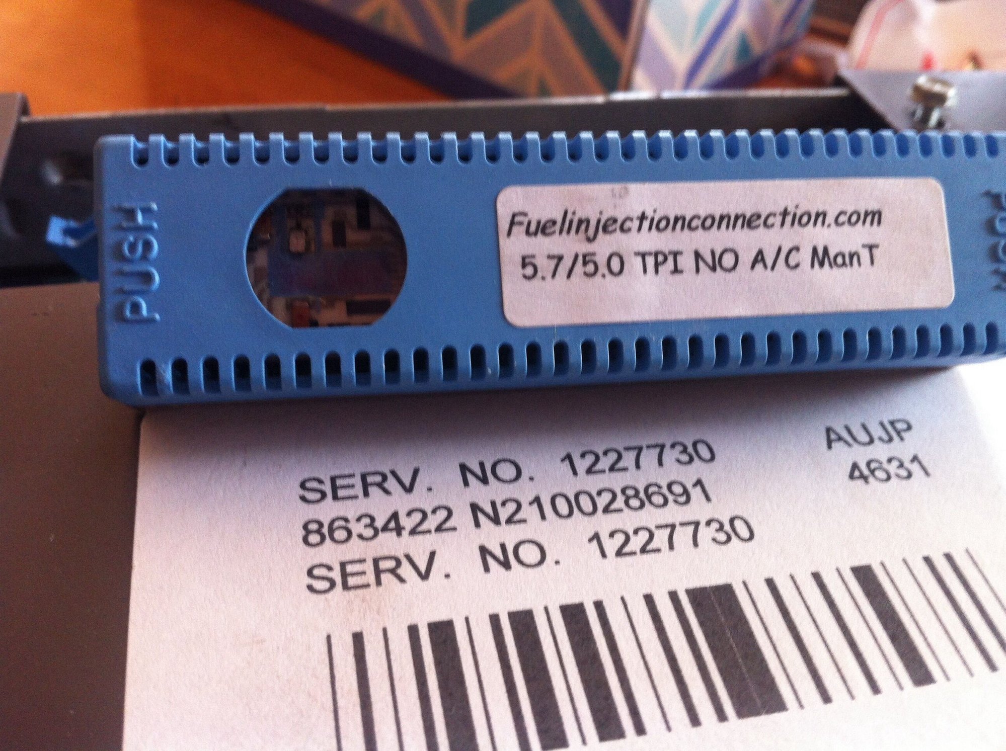

I would never trust any of there speed density memcals. I just received one in a package deal. Surprise it has a v6 memcal with no compensation for cylinder select.
Old Apr 19, 2015 | 05:58 PM
Tuned Performance's Avatar
Community Influencer
iTrader: (95)
Posts: 16,892
Likes: 1,013
From: Mile High Country !!!
Car: 1967 Camaro, 91 z28
Engine: Lb9
Transmission: M20
Re: FuelInjectionConnection.com
The second digit on the knock filter is J. No knock protection found here !
