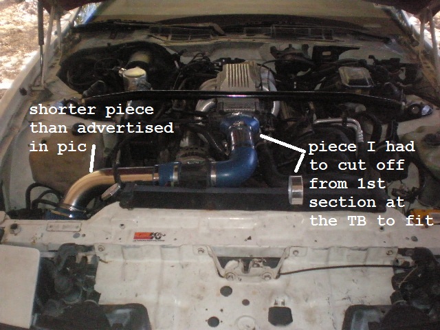

I seriously would NOT recommend buying this for a v-belt 3rd gen. There is less that 1/4" clearance between the MAF & the alternator pulley. So it is more of a "It will not fit v-belt 3rd gens.", than year model specific. Convert your older v-belt system over to serpentine belt & I bet you'd have more room.
This is the actual one that I used since the pic showed that the filter would sit lower therefore easier to block off & create a real Cold air intake.
http://cgi.ebay.com/ebaymotors/ws/eB...8551&viewitem=
But since the MAF is where the interfernce problem is, the problem would be the same AND what I got was the same as the pic in the other thread, with the shorter tube to the filter.

I got it to fit good, over 1" clearence now, but had to cut the heater hose so that it ran lower & the CAI fit better. And I had to cut about 1"-1.25" off the shorter tube in the kit so that the blue elbow was not sitting on top of the radiator, which obviously won't work for hood clearance reasons in a Firebird.
So it can be made to work, but took some cutting of not only the kit but a hose in the car to make it work. Too bad the silver tube between the MAF & the filter wasn't what was in the kit advertised.
It was definitely a shorter tube that came with it.

Compare my pic to the one for the ad 3 replies up & you will see that what they show is not what you get. Where the filter mounts that piece is definitely not the same!
The MAF would have been sitting on top of the radiator wall if I had not trimmed 1 3/16" off the tube & still think more trimming could be done & still get a secure fit.

Well, he turned out to be a great Seller! Gave me a $10 refund (on a $38/Free Shipping part) for my trouble.
I cut 1 3/16" off 1 pipe, shorten the heater hose so that it hangs lower (was too long causing it to go up then back down to reach its other connection & it saved me $10. Not bad at all! And the hose that was too long? The CAI kit had nothing to do with that. I simply hadn't noticed it until I went to put the CAI kit in.
I'll take a $10 discount for me having to trim 1 piece any day!

Okay so I ran this "Ebay" 38 dollar intake all summer long. Seemed to work pretty well. The only problem I ran into was the aluminum piping got extremley hot. I felt like it was being less effecient than the stock intake. So I've taken the filter from the ebay one and slapped it on the end of the stock intake. Seems to be working well so far.

UPDATE!
https://www.thirdgen.org/forums/tp...ml#post5053066 (Anyone use this cold air intake?)
