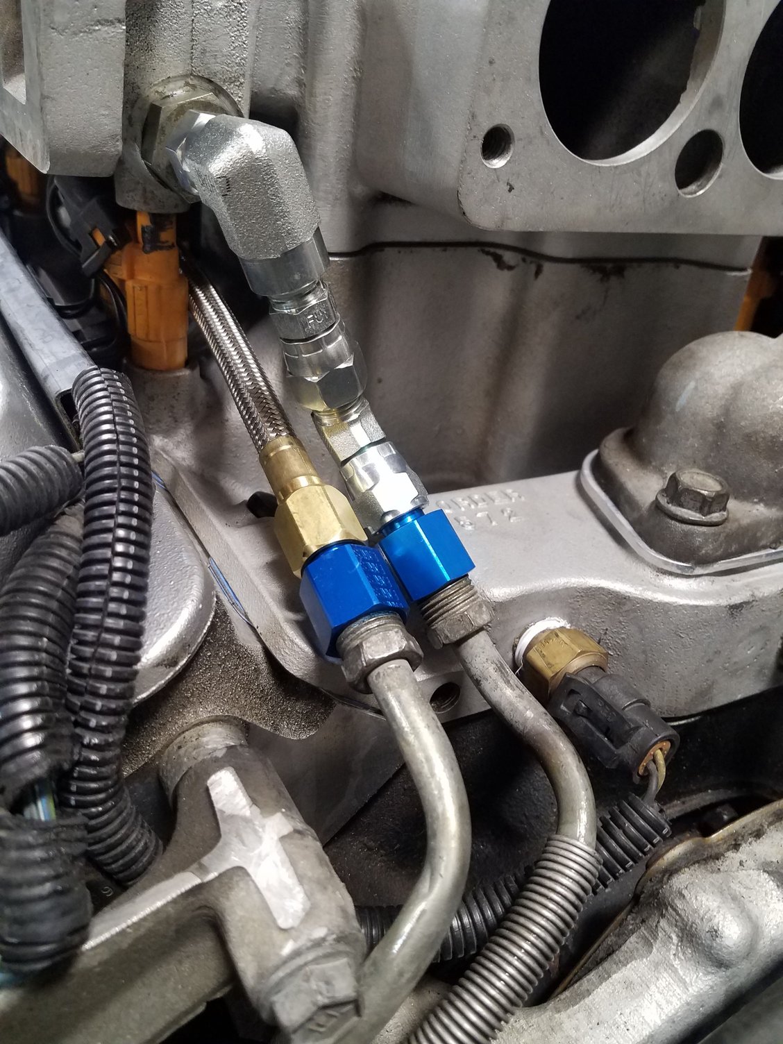

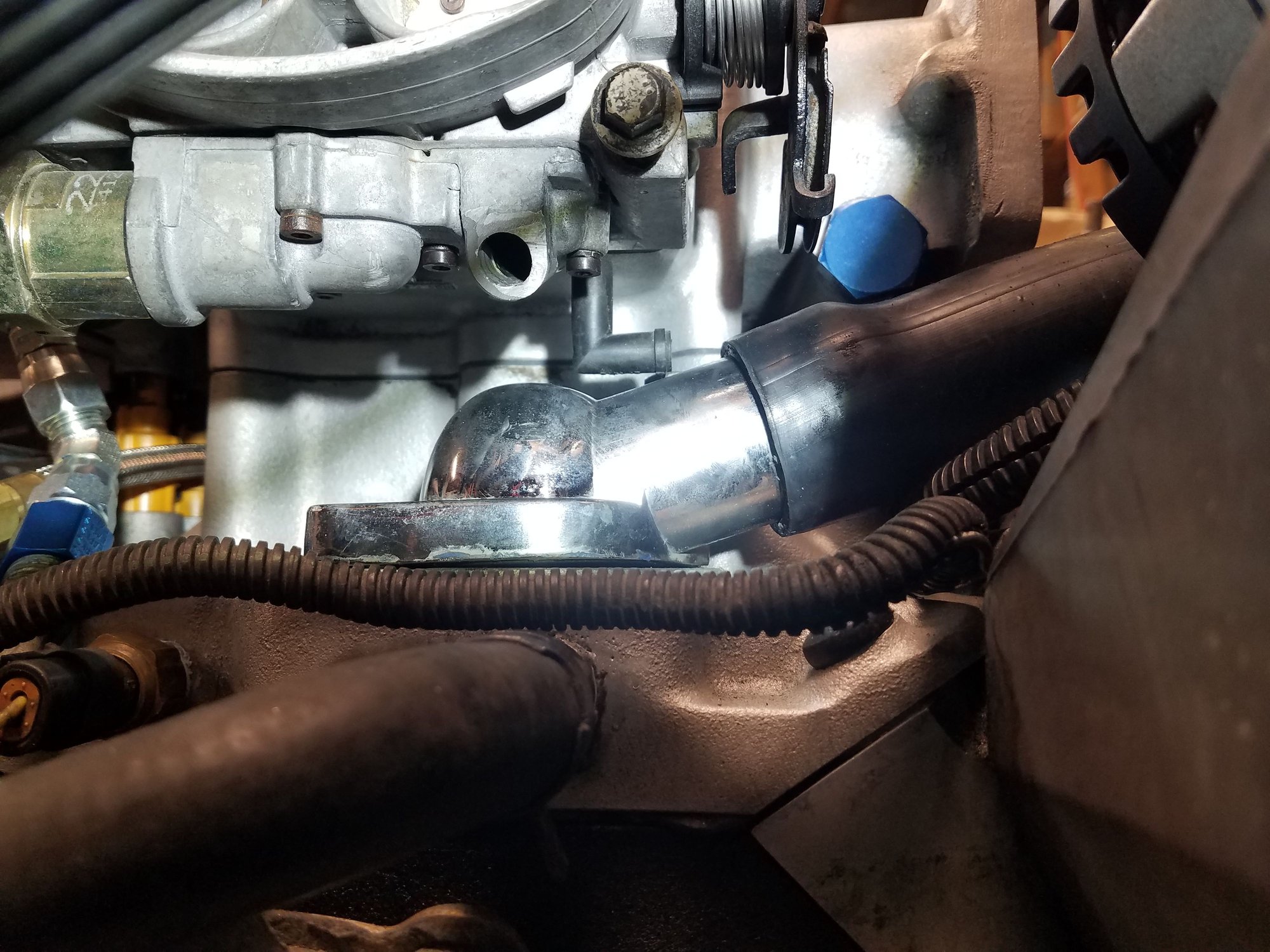

Did a search for this too....but didn't see anything; How are folks connecting the AN fuel lines for the T-Ram, to the o-ring fittings on the fuel feed and returns? I'm guessing that there is a fitting that you can buy from a hose place?

You need a Saginaw 14 and 16mm to an6 from
earls or fragola.

https://www.thirdgen.org/forums/tpi/...uel-lines.html
earls or fragola.

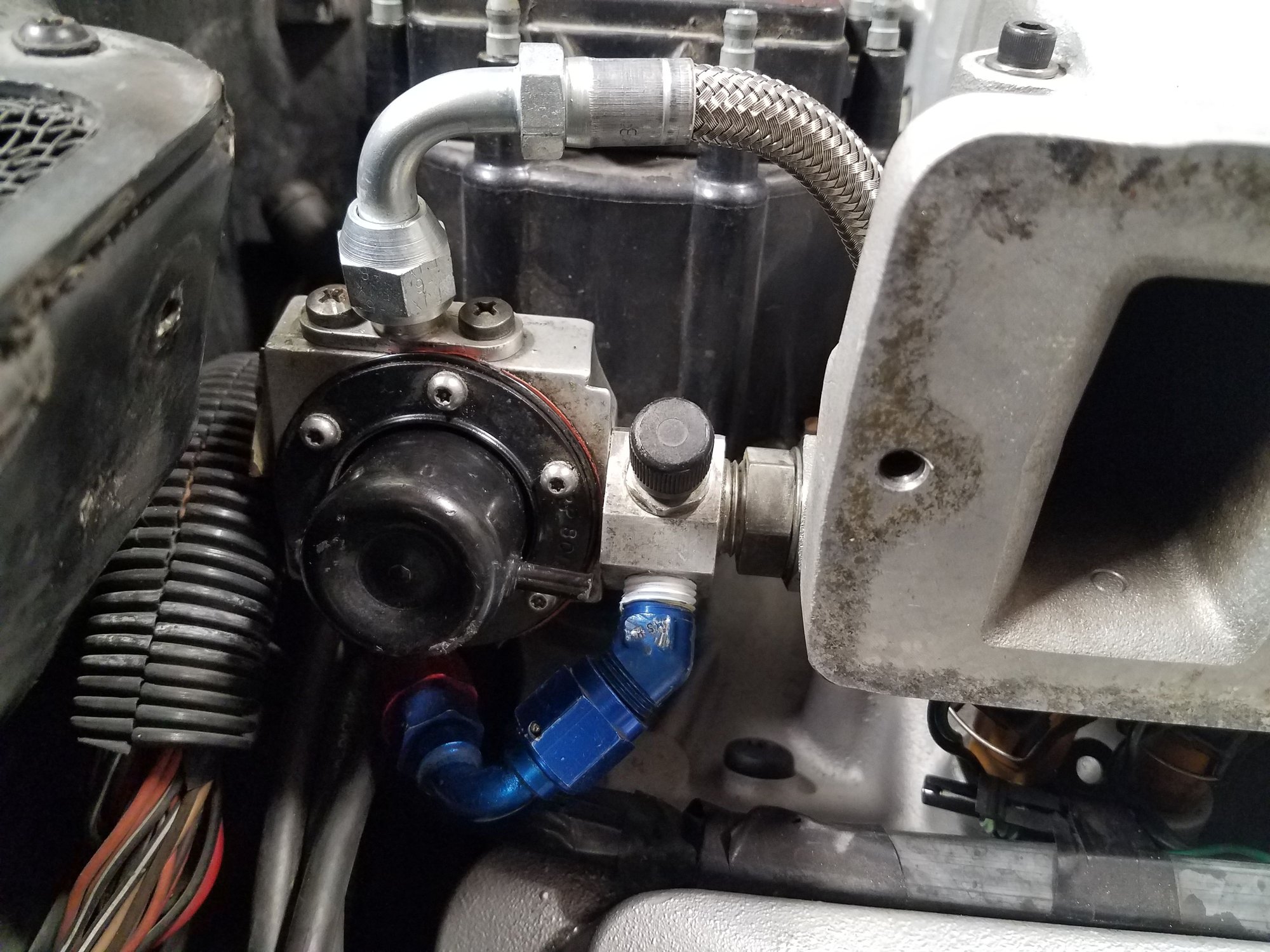

PSA: The 'Vette application uses the 16mm for both feed and return. At least my '89 does.

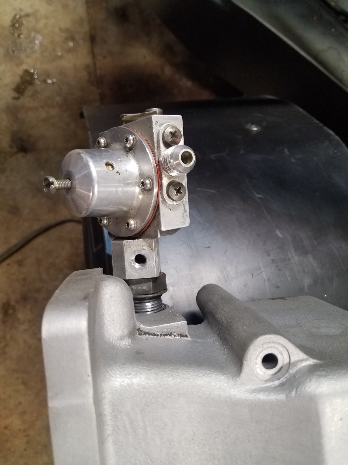

What gives w/the FPR? Is it NOT vacuum referenced? Or did I buy one w/the nipple broken off?
I finally got the fuel line routing sorted, had lines made, and got the upper installed...then realized the the TPI T-stat neck won't fit under the TB. Now (this late in the game), I "get it" why there is a t-stat housing that matters. Shitty.

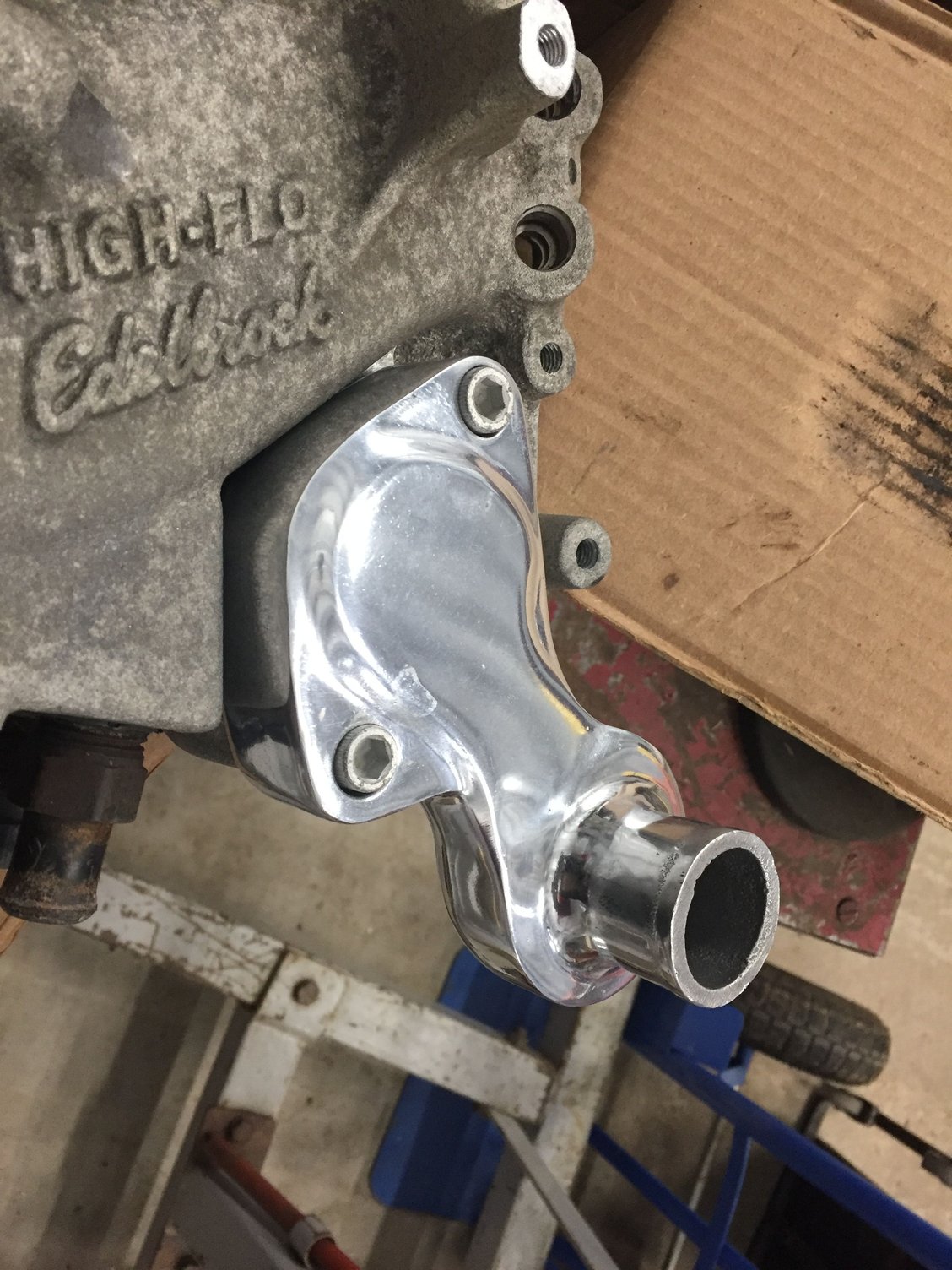

My t ram uses a factory tpi fuel pressure regulator , diaphragm and cover with vacuum fitting.
the t stat is specific to the t ram. Look at previous threads a member had one made wasn’t cheap I don’t think.

Thanks for teh post #. I'm confused though; are those for sale somewhere? I didn't see anything about them being purchaseable? He says that they're CNC machined, but the pics show a cast water neck....I don't "get it".

Send him a pm, he did a test 3d print then had one made that was cnc

Your regulator housing nipple is snapped off. Might be able to tap with 1/8 not and get a 1/8 not to barb fitting.
looks like your pressure tester fitting is missing too.

Thanks. I thought that might be the case. I didn't even think about it until today, when I was running through the vacuum lines in my head, that needed to be hooked up. Then it hit me; "where's the Nipple of the FPR!?".
I gave charlie6178 way, WAY too much money for this thing. Shame on me for not researching better and letting myself get taken on this one. Shitty.
I'll PM him about the water neck, but do you think that
ANY
OF
THESE
....might fit? I can't believe that there isn't a go-to solution for T-Ram folks.

I have the pressure test fitting...I removed it to allow the unit to be screwed into the port on the upper intake.

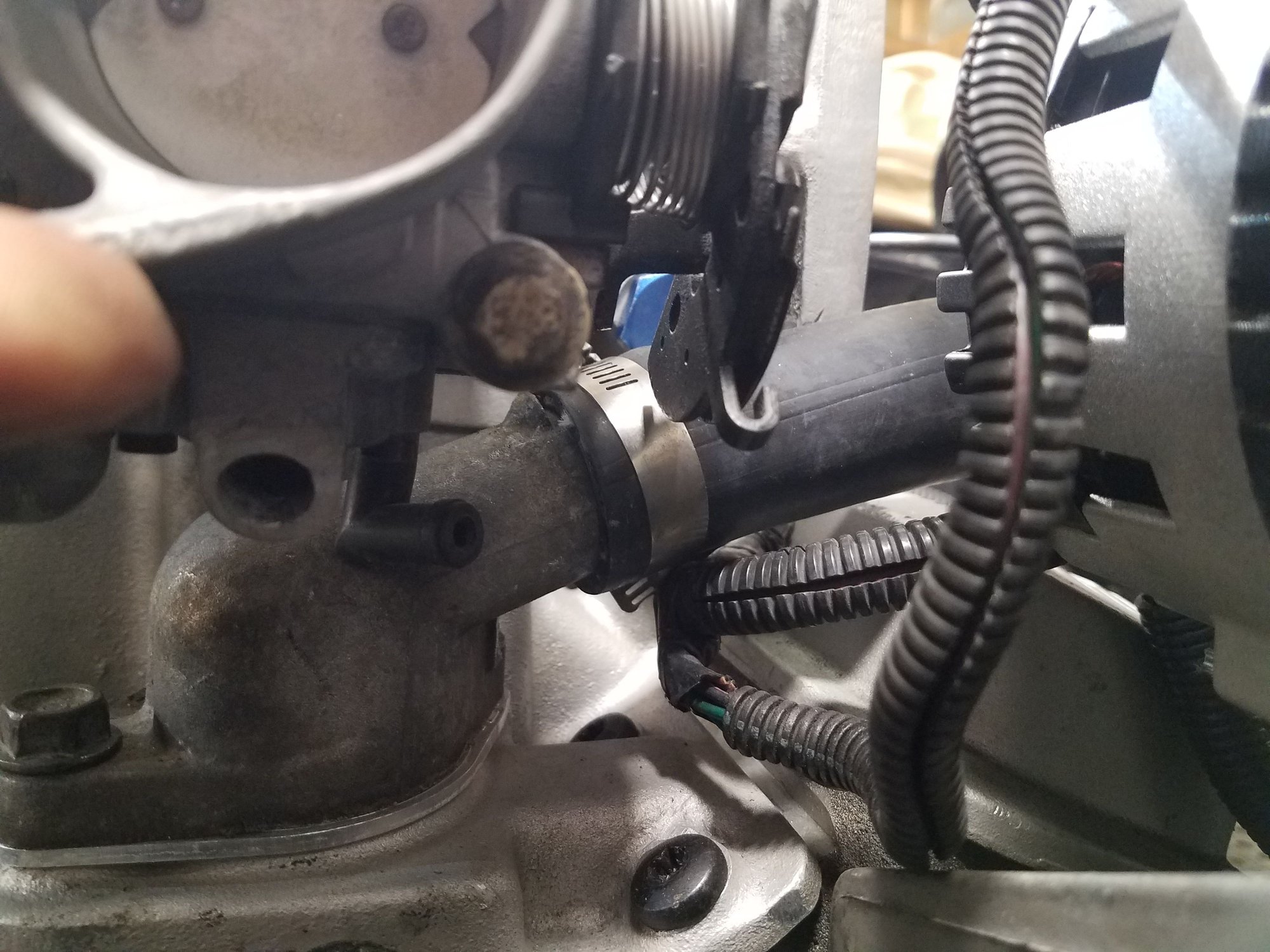

I don’t think there will be a alternative t stat housing. The t ram one is angled down and the radiator hose then routes between the belt. A blower one may work but then might hit the alternator is on the drivers side. A street and performance may work if you can find one.

Thanks.....again! I had a couple "revelations". First, I finally understood what you meant/why you used a stock TPI FPR; they're the same. I had an extra TPI fuel rail assy in the "museum" so I took the housing from that and solved my FPR issue.
Then while I was looking at parts in the museum, I started to wonder about stat housings that I had...if they'd fit. They sure do! No problem there, so that problem is solved also. I appear to be in good shape now. I just need to get one more 4mp 90* 3/8 nipple for the PCV, and I can finally finish this thing, and test fire it.

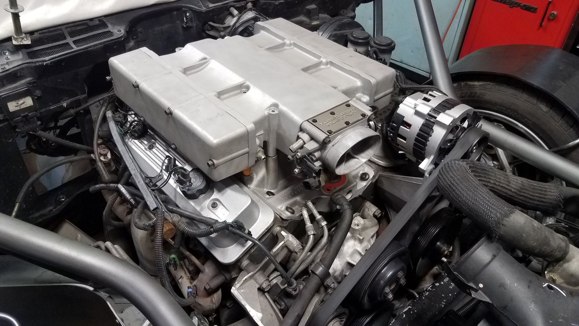

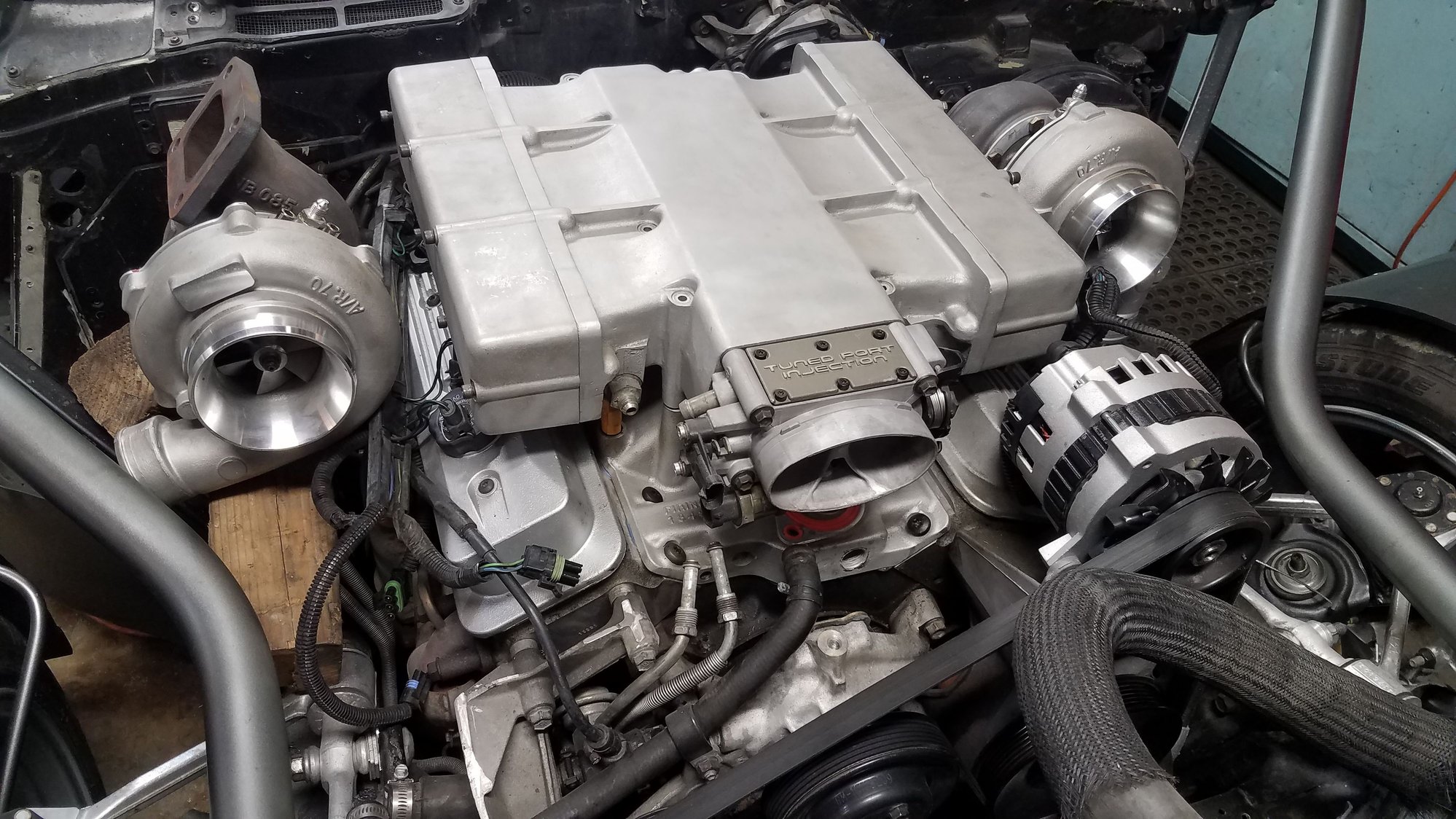

Well, here we go again. let's put a SN92 paxton on with a T-ram.. =10lbs of sh*t in a 5lb bucket.. (we hope)
II have got to get a new phone. Sometimes it takes great pictures and other times, well...

I think it'll work, soon....
What's the 10 lb/5 lb thing mean?
More than one can handle/overflow/excess
Come on Tony, stop low key rubbing in our faces that you have more than one T-ram
