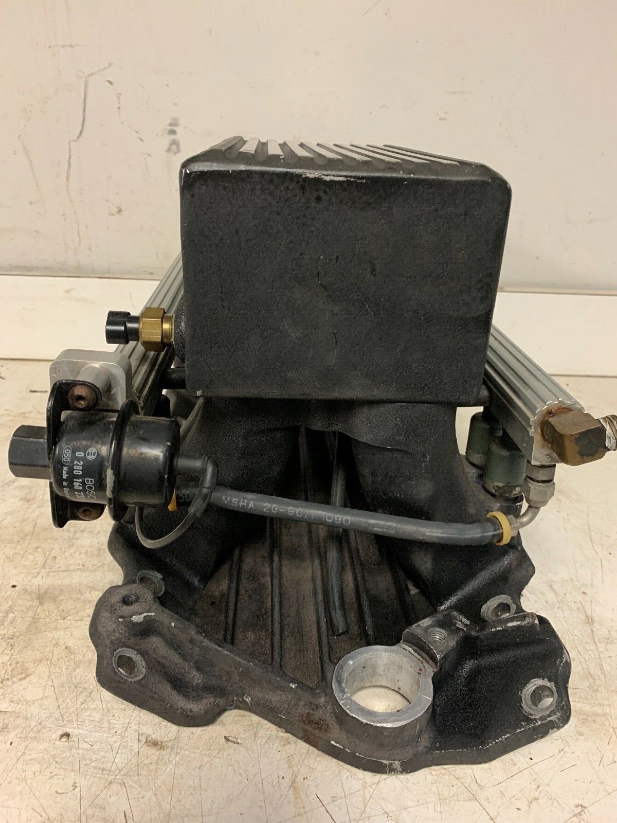

Flo-Master Short Ram
I just saw this pop up on Ebay. https://www.ebay.com/itm/114040592158?ul_noapp=true
Has anyone ever heard of this intake?

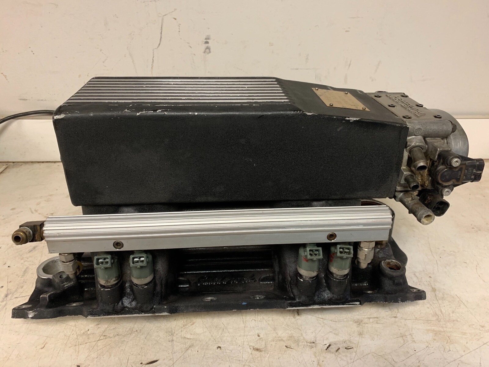

Looks like it's an Edelbrock (Orville Eldlerbrocker) tunnel ram intake with a fabricated plenum. The logo, fins, etc on the lower all match up. The injector bungs are welded in after the intake was cast.
Like a Stealth Ram before the Stealth Ram was a thing.

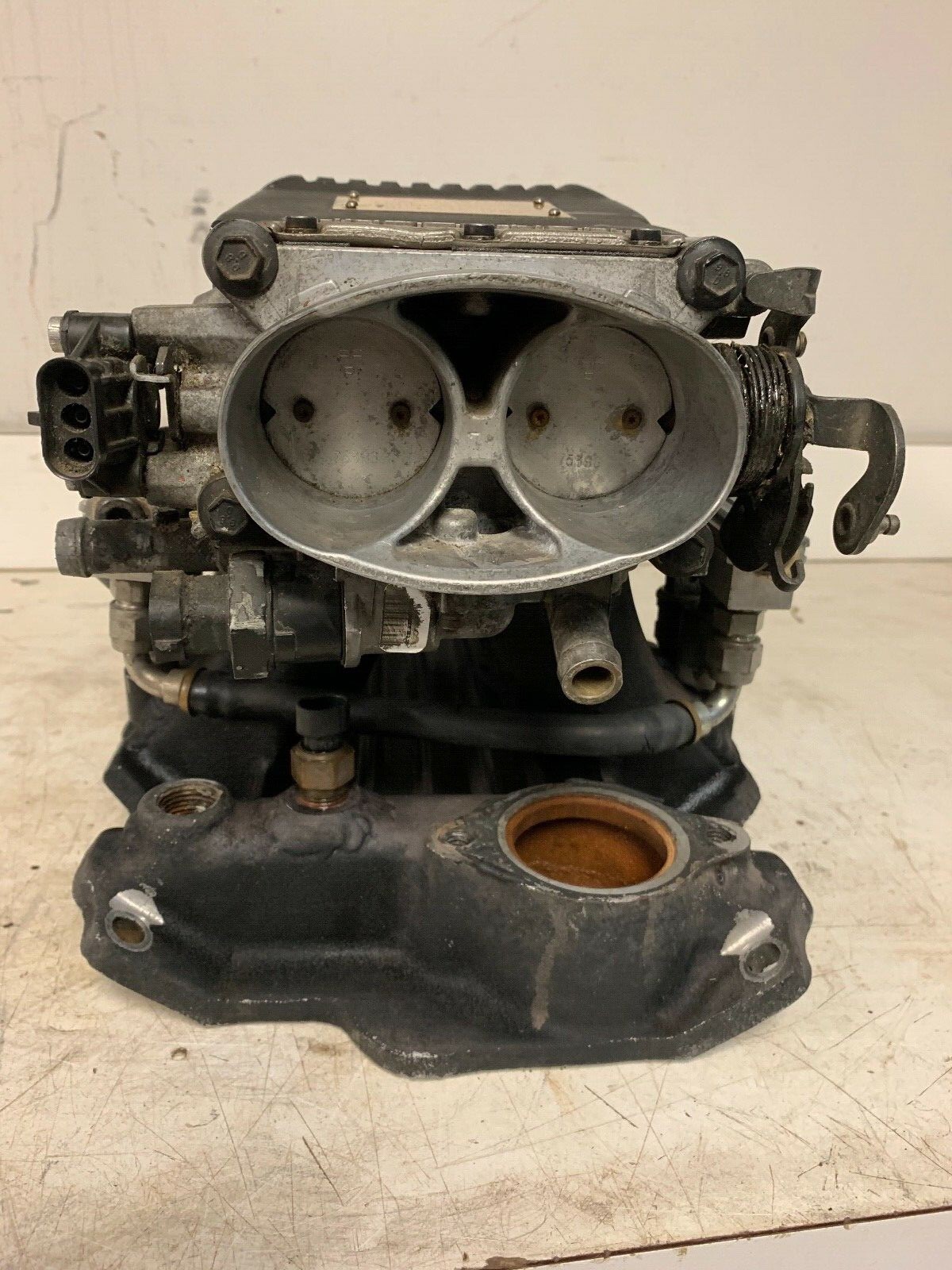

I don’t even see how a throttle cable or tv cable attaches

Probably some kind of cobbled/fabricated bracket that bolted to that screw er whatever on the plenum.

The seller is high as a kite. That garbage isn't worth $1200 plus shipping. Looks pretty homely and a brand new stealth ram including fuel rails is about half that asking price. The stock throttle body isn't adding much to the value if anything. Some people....

Given the prices for some of the second hand aftermarket TPI stuff, it could potentially sell for the asking price. It'd help if a person took the time to give it a fresh coat of paint. People love odd stuff with fresh paint.

Pry the trophy placard off there and it'd look a lot better.

That's not a Mcfarland. -although it appears to be modeled after one. It may actually work pretty well, but not a player at that price.
