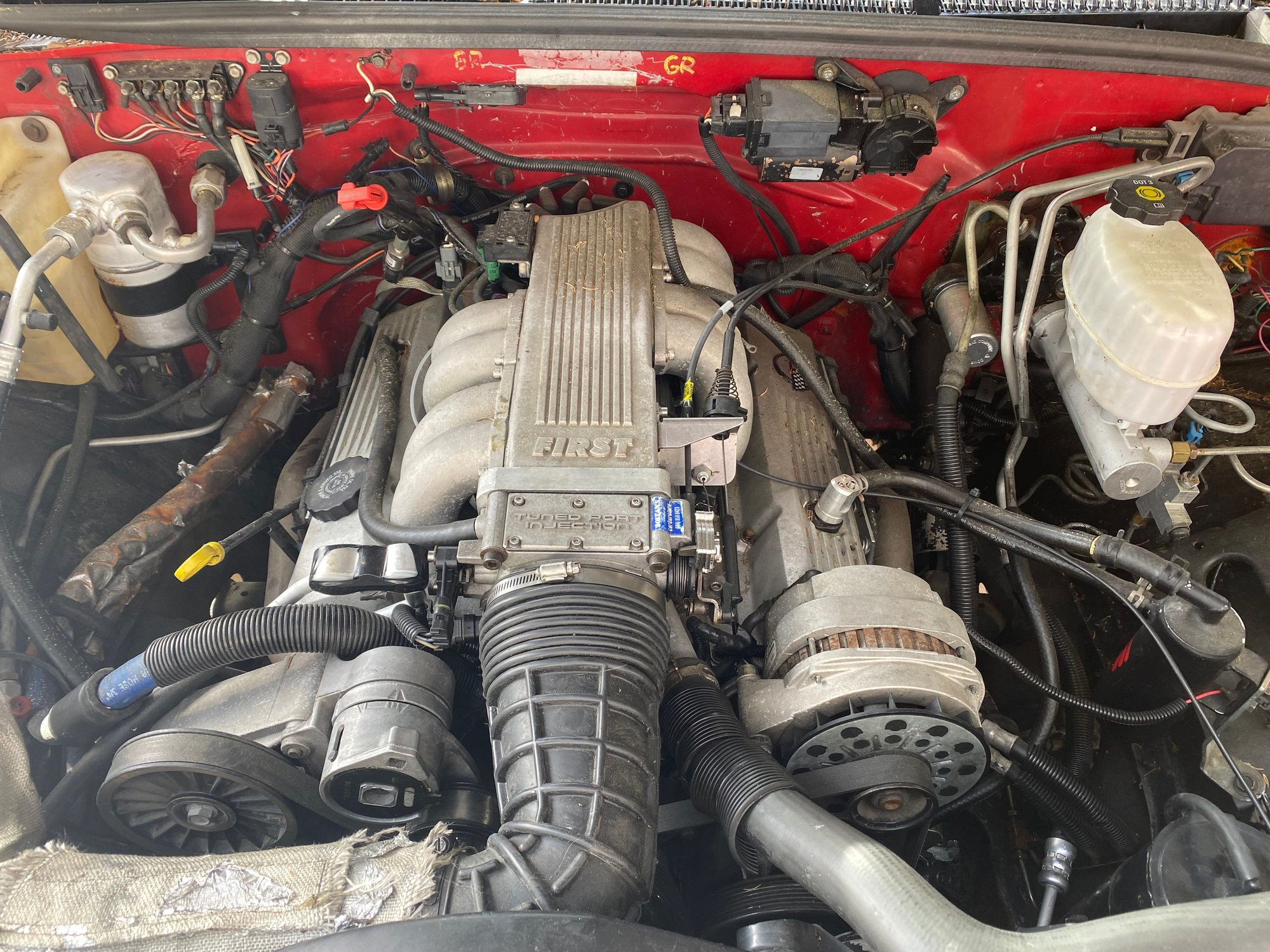

Well I have installed and am driving/tuning my new Vortec 350 with cam (Comp Nitrous HP 224/236), valve train (PAC 130lb beehive springs, Scorpion narrow body RR's) and FIRST manifold (thanks Ken). Some initial thoughts:
1. ITS AWESOME!
2. Machine work on the manifold was superb. Everything fit as designed. Ken does an amazing job and his customer service is outstanding.
3. I went with the fuel lines routed to the front of the manifold. This is contrary to their recommendation but the F body fuel line layout being what it is, it makes sense. With the right low profile fittings and using low profile Oetiker clamps there's just enough room.
4. You will need an external fuel pressure regulator. I mounted one of these on the fenderwall: https://www.deatschwerks.com/6-2000-frb
5. Ken can machine the intake for LS style injectors. I used a set of these, 42lb with data, and they come with EV1 adapters so they plug right into the factory harness connectors: https://www.deatschwerks.com/18u-01-0042-8
These are tuning well for me (I'm on a LINK Storm ECM with our prototype 7165 harness adapter), and I'm idling about 1.7ms which is well into their linear range.
6. If you have a TPI car, make sure you request the "long throttle pin" from Ken. This accommodates the cruise control cable.
7. You will need a TV cable throttle pin if you are running the 700R4. This is the one I used: https://www.summitracing.com/parts/edl-8018
8. The intake does fit under the Firebird hood. I have Energy urethane engine and trans mounts and the throttle body just barely kissed the reinforcing frame under the hood.
Feel free to reach out to me if anyone has any questions. I must say the whole experience with Ken was excellent and I highly recommend this intake to anyone. I'll add more to this post once I get the tune more refined and I put it on our DynoJet.
GD

Great set-up!!!
"ITS AWESOME!".
Ohhh yeah... I concur.
"Ken does an amazing job and his customer service is outstanding."
Almost an understatement lol. Ken has a LOT of patience with customers.
"I went with the fuel lines routed to the front of the manifold. This is contrary to their recommendation but the F body fuel line layout being what it is, it makes sense."
"You will need an external fuel pressure regulator. I mounted one of these on the fenderwall: https://www.deatschwerks.com/6-1000-frb"
I used Aeromotive 13301 https://aeromotiveinc.com/product/un...***-regulator/
"Ken can machine the intake for LS style injectors. I used a set of these, 42lb with data, and they come with EV1 adapters so they plug right into the factory harness connectors: https://www.deatschwerks.com/18u-01-0042-8"
For my small block, I used Bosh III style, 32lb/hr from https://fuelinjectorconnection.com/
"I'm idling about 1.7ms which is well into their linear range."
I'm idling at around 1.5ms before Voltage compensation. At WOT, max RPM, near 6000, I'm just under 80% INJ PW DC with my set-up (includes INJ PW voltage compensation).
"The intake does fit under the Firebird hood. I have Energy urethane engine and trans mounts and the throttle body just barely kissed the reinforcing frame under the hood."
I have the same mounts. Just touch a bit at throttle body that's it. Of course fitting the strut tower brace was a bit more work.
GD[/QUOTE]

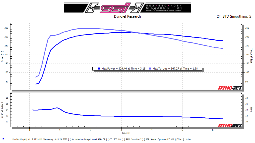

The results are in! Spent 3 hours on the DynoJet with a fellow tuning buddy and got what I think are some pretty respectable numbers for an Iron Vortec roller motor:
The numbers were: 325 RWHP, and 347 RWTQ. The torque is not accurate through the 3k stall automatic of course. Likely higher since this graph is from about 4200 to 6200 where I lifted. Engine has about 50 miles on it. I'll start another thread in the general section on the engine build. I'm curious what others here think of the results, the components I chose, and where I might go from here.
Figuring typical drivetrain losses through a slippery automatic with a high stall converter, this engine is likely very close to 400 HP at the crank. Not bad for a $200 Vortec truck pull-out with 177k on the odometer.
GD

Beautiful setup! Breathes very well. That x-axis shows "Time" but its RPMx1000 yes?

No that actually *is* time. I can put up the RPM graph also, it just looks really funky because half the graph is seven tenths of a second long, while half is 5.5 seconds long. Due to the engine traveling 2500 RPM's in 0.7 seconds to come up against the converter.
If you put 4500 where the 1 is, and 6200 at the end of the pull - that's the RPM range. I'll export the graph with RPM along the bottom also.
I also did a pull at full power using roller speed to calculate RPM. That does interesting things to the torque curve. It showed 529 Ft/lbs peak torque. LOL.
Many folks don't understand that part of a dyno graph is how the operator elects to display the data. RPM would be what I would have used if this were a manual car. But the high stall auto really makes a more pretty graph with this layout. It's the same exact curve, just with the RPM from 2500 to 4500 compressed into the first 0.7 seconds of the pull.

Here's the export with RPM at the bottom. You'll note that it's the same once the converter stalls. It's just a lot of useless graph (unless you're tuning and need the RPM).

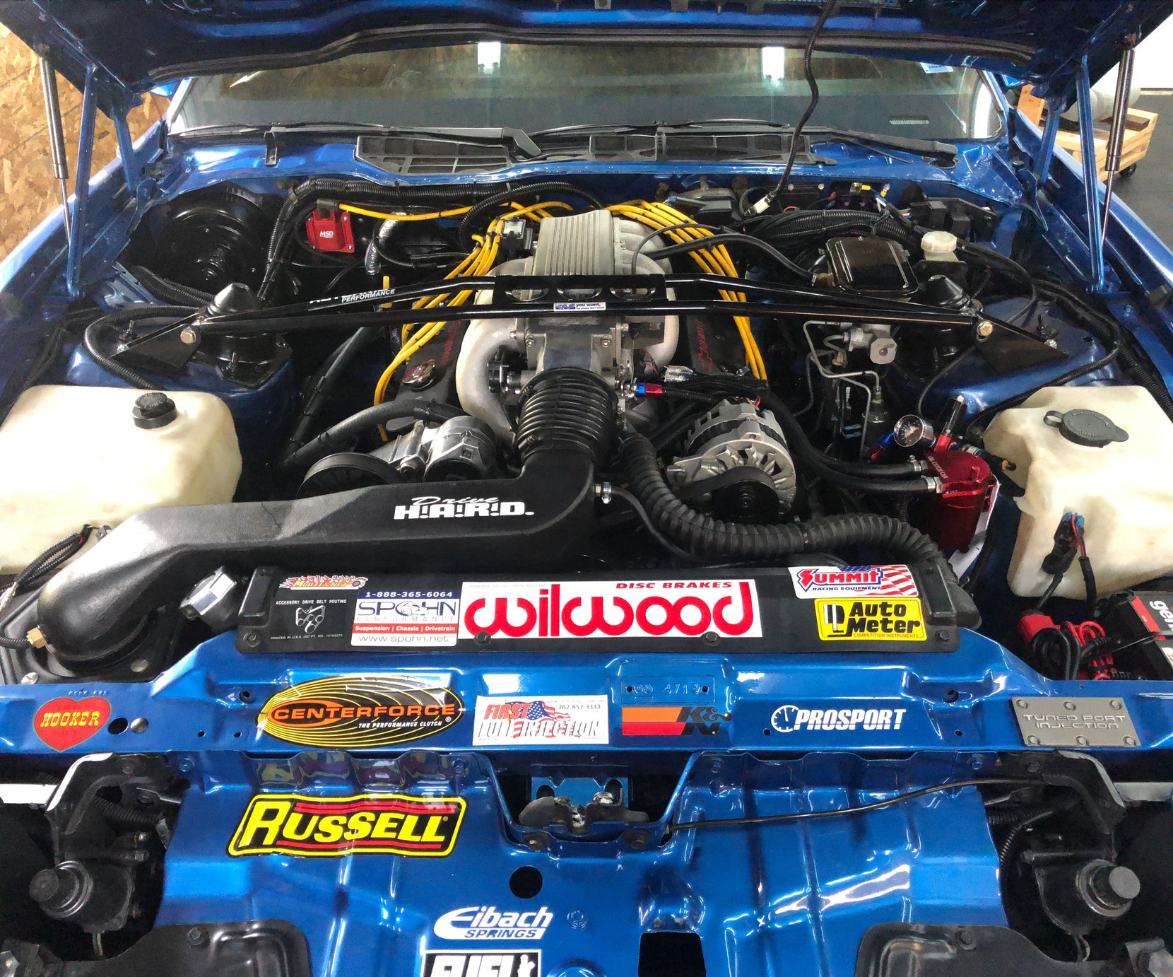

Our build is almost done ours is a 383 first performance intake we had ken Port our TB to 76mm ..lpe219 cam by lingenfelter, 113 heads, tuning is done by a Holley hp efi system hoping for similar dyno numbers.

Sorry if I missed it but what cam are you using?

Think he means strut tower brace

Oh I see. He's talking about your pic. That makes more sense.
GD
I don't think a strut tower brace would fit with the First performance intake. .
Old May 15, 2020 | 08:32 PM
ViperSpec's Avatar
Joined: Apr 2015
Posts: 30
From: Minnesota
Car: 1989 GTA
Engine: 5.7 TPI
Axle/Gears: 3.27 (Stock)
Re: FIRST TPI intake installation complete.
It's been awhile, but I thought I compared the height of the two intakes at the point the brace crosses over and its pretty damn close to the same as I recall. But like I said, its been a good while and I could be mistaken. I always thought the fitment issues on these was not so much overall height, but the way the throttle body sits and is squared vs rectangular that could cause interference in Vettes and such.
BTW, I love that Sandel compressor. Looks like it really frees up some real estate in that area compared to the pancake compressor. Works pretty well with R134a too?
Old May 15, 2020 | 08:34 PM
my hemi's Avatar
Joined: Oct 2013
Posts: 614
Likes: 59
From: NJ
Car: A few things lol
Engine: 350 tpi supercharged and a 383 stro
Transmission: Both 700r4s
Axle/Gears: 3.23s and 3.54s
My TB grazes the hood he had to massage the hood a hair to clear...

Awesome; love it! Surprised to see the torque peak up at 4,700; I would've expected more like 4,400 RPM.
I went with the ls-style injectors, too (Bosch III 36 lbs) from FIC on sale for $329. They like running at 4 or even 5 bar.
I like that deatschwerks fuel pressure regulator; good deal!
Adam
Old Jul 8, 2020 | 05:04 PM
GeneralDisorder's Avatar
Joined: Mar 2017
Posts: 4,255
Likes: 427
From: Portland, OR
Adam
The torque peak is actually about 2500. You can't see it in the graph because the converter stalls after the torque peak. The first graph is accurate but you don't get the RPM because it's a graph over time. The second graph is only accurate once the engine comes up against the converter. I start the pull at 2500 and go to WOT, and you can see in the graph it flashes through that first 2000 RPM climb in a fraction of a second. The two charts are the same pull - just graphed differently. The rest of the graph from 4600 to 6200 takes about 6 seconds and the engine is over 300 HP at the tires for most of that time. This is all dynoed in 3rd gear. The torque peak down around 2500 is almost guaranteed to be well above 400 Ft/lbs. Probably in the 450 ft/lbs neighborhood.
GD
GD
Total misread that graph. Now I'm shocked the torque peak is so LOW with that cam and 350 cubes, but I always forget just how small the vortec ports are compared to what I'm used to. Really cool to see the curve move to the left from the port volume.
Adam
Old Jul 10, 2020 | 01:20 PM
Joined: Mar 2017
Posts: 4,255
Likes: 427
From: Portland, OR
It makes a LOT of toque. If it were a manual it would probably be a little difficult to drive. With the high stall auto it's easier to hook up.
GD

This installation uses oem fuel rails and Holley AFPR, Bosche 38pph gen4 injectors, ported oe TB, For the oe TB, how does it compare to a LS DBW TB?
Old Aug 12, 2025 | 10:16 AM
Edsiroc's Avatar
Joined: Jan 2017
Posts: 75
Likes: 31
From: Los Angeles, CA
Car: 1989 Camaro, 1989 Firebird
Engine: 5.0 TPI, 5.7 TPI
Transmission: T56, 700R4
Axle/Gears: 3.42, 3.23
Do you have any picture of your fuel rail set up?
Old Aug 12, 2025 | 12:03 PM
dfarr67's Avatar
Joined: Sep 2009
Posts: 358
It's been awhile, there was some machining involved. Bosch 3's fit but I had a problem with Bosch 4's which are probably shorter and leaked at the top, I ended up using TPI/LT1 injector c-clips at the top and everything works as it should. The oe rails flow sufficient fuel for this 385 and the AFR is discrete. Also needed a custom cable from Bowtie OD for the 700R.
skinny z
