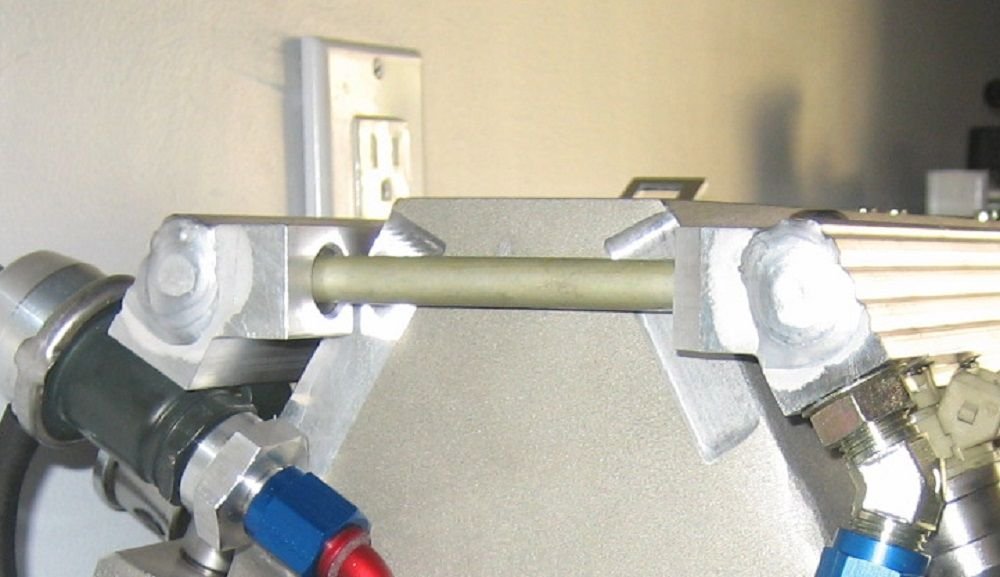

The rails can be gundrilled from the rear then welded shut. I use a -8 line in, welded -6 fittings and my own crossover while keeping the pressure regulator as supplied with a -6 return.
this was inadequate for supply in high flow situations
gun drill both rails through here and weldemup
the -6 fittings are welded onto the rails here and fed across to the front of both rails
this application has supported 50#ers at sustained w/o throttle
