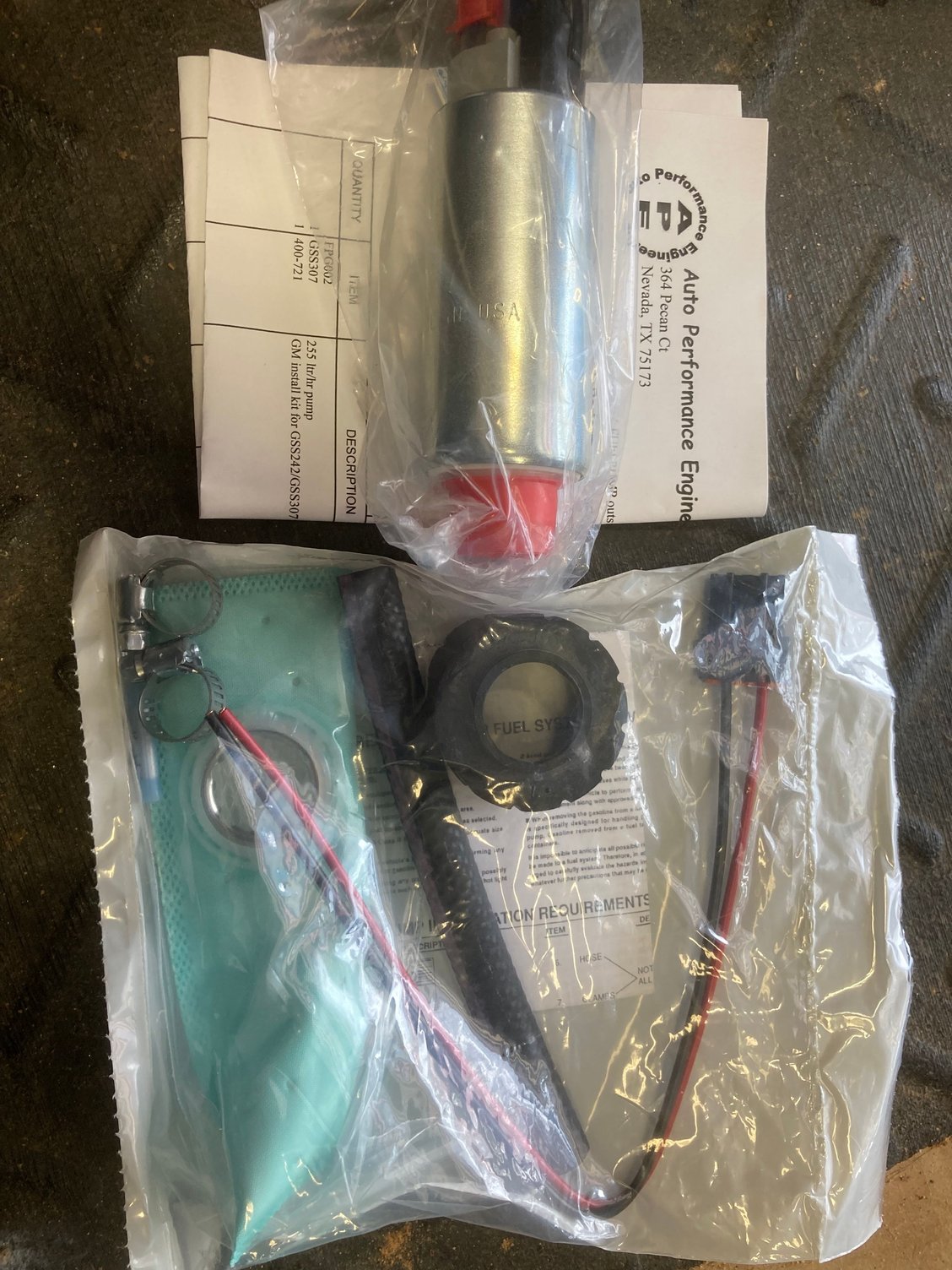

which pump number did you use? I had ordered the kit specifically for 82-92 camaro but they are still on back order every where I have looked. https://protect-us.mimecast.com/s/X15sC82A1XsXV6zJTMnusl?domain=summitracing.coM
Old Mar 21, 2022 | 02:08 PM
midias's Avatar
Joined: Oct 2004
Posts: 4,528
Likes: 240
From: Henrietta NY
Car: 1984 Trans Am L69
Axle/Gears: 3.42 10 Bolt Posi
Re: Carb to Edelbrock Pro-Flo
I got mine here FPG002 kit
http://www.autoperformanceengineerin...ml/fpapps.html
Old Mar 21, 2022 | 07:33 PM
3rdgenmaro's Avatar
Posts: 2,042
Likes: 18
From: Lincolnton, NC
Car: 88 IROC
Engine: 97 5.7 Vortec LT4 hotcam
Transmission: 700 r4
Originally Posted by midias
thanks! Just ordered one.
now to find the regulator in stock somewhere or swap to a different type. Right now I have the edelbrock fpr that was made specifically for the pro flo. But it is also still on back order since January.

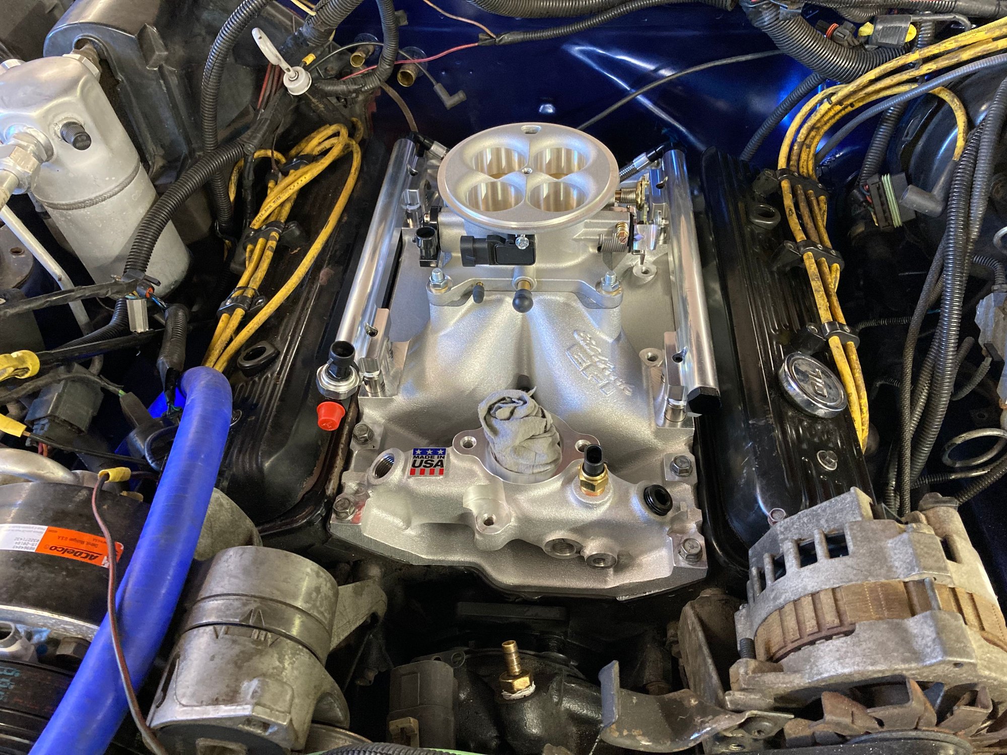

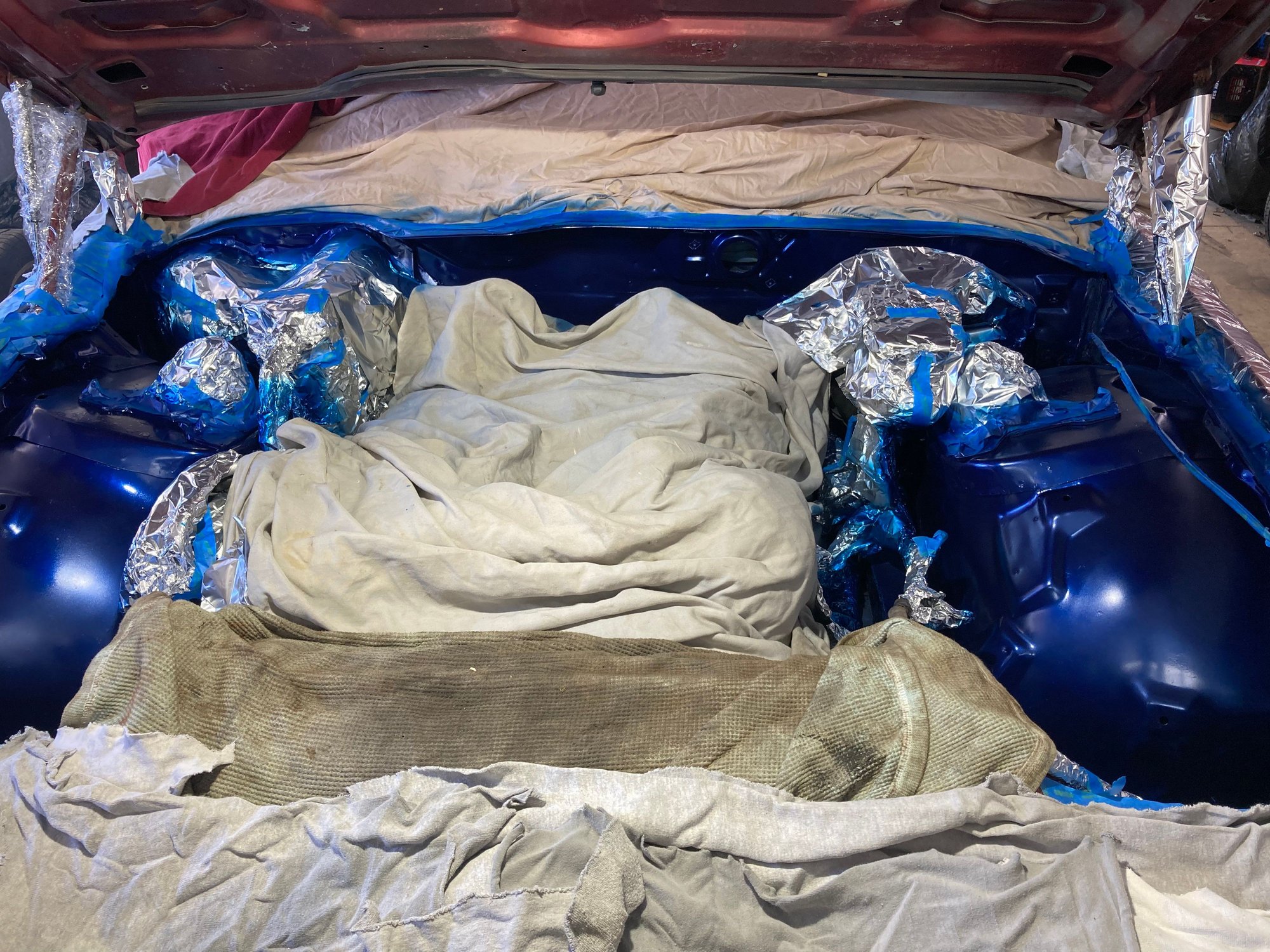

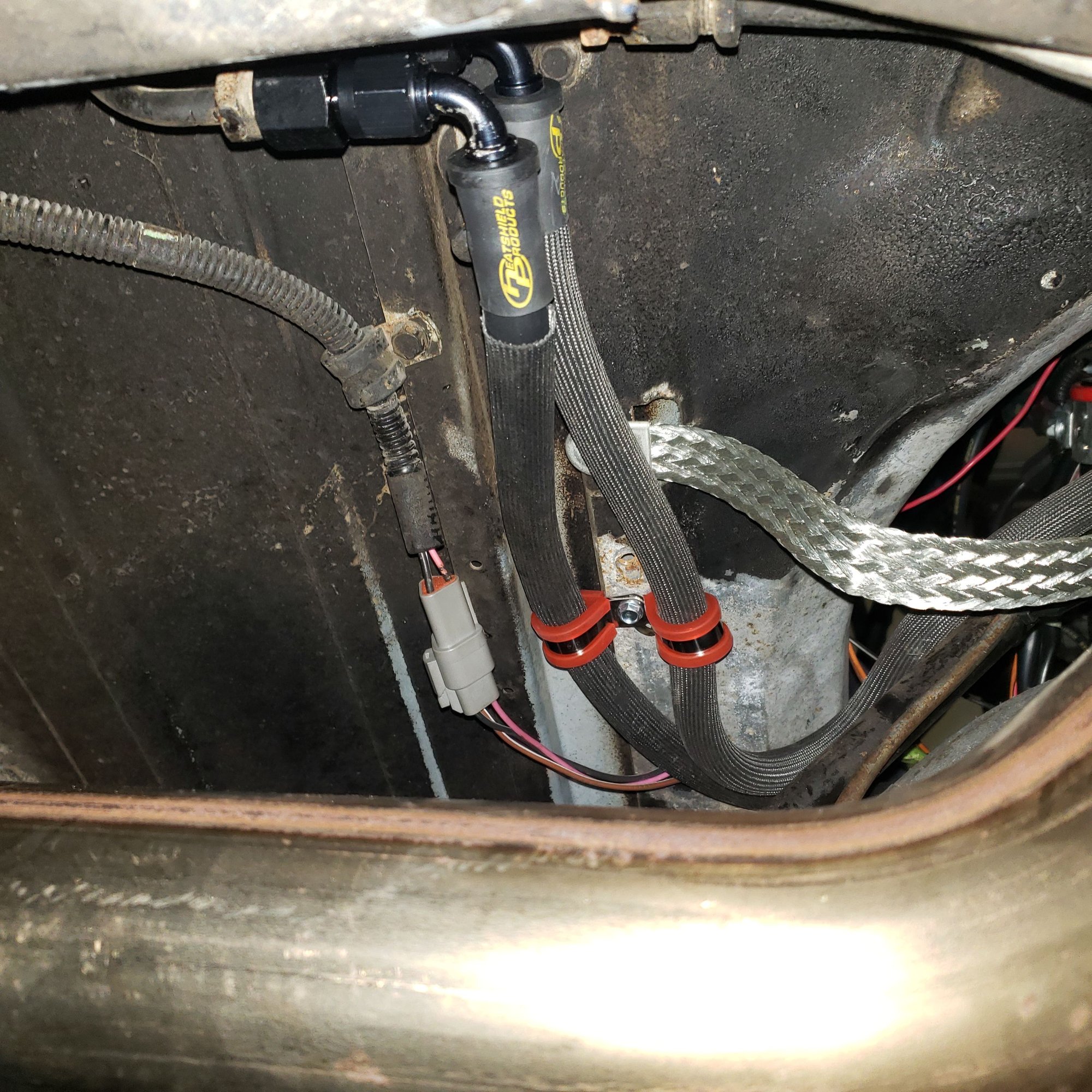

Started install last week. Started off pulling the tank to swap fuel pumps and check tank condition. Clean as a whistle inside but I noticed some varnish on the outside. Wiped it off and a pinhole popped up. So had to order a new tank. Doesn’t fit near as good as the stock
one. But it’s all in now.
Under the hood I decided to paint what I could while I had a lot removed. Not looking for a show room finish, but eventually I’ll paint the car admiral blue metallic and figured now would be the time to hit the engine bay. Turned out decent.
ran out of time but will start back on it next Friday

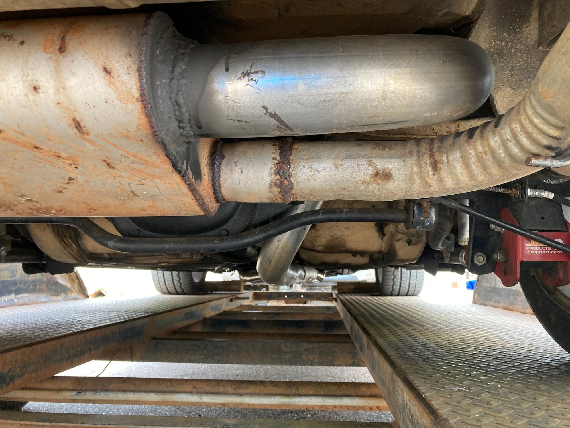

Didn’t get much done this past weekend. Had some other stuff going on. I did get my muffler modified and mocked back up. I’ve had an 80 series flowmaster on almost as long as I’ve had the car. Love how it sounds so didn’t want to replace it at this point, or spend anymore on it. For now anyways. Plus when I put longtubes on this winter we installed a flowmaster 3” outlet y pipe but used the stock tiny pipe between muffler and y.
I don’t remember the part number but I bought the 4th gen 3” intermediate pipe mentioned elsewhere on this site. Installing it at the same time. The current 80 series is a 2.5” inlet. I contacted flowmaster a while back asking if there were any internal differences between the 2.5” and 3” and they told me no. The only difference is the pipe diameter entering the case. So I cut it out and opened it up to 3”. Just got to do some more adjusting and measuring then start cutting and tacking into place.

Didn’t get much time this weekend but got the exhaust welded up and the car back on the ground. List is getting shorter. Intake looks awesome sitting there. Can’t wait to button it up and fire it up.

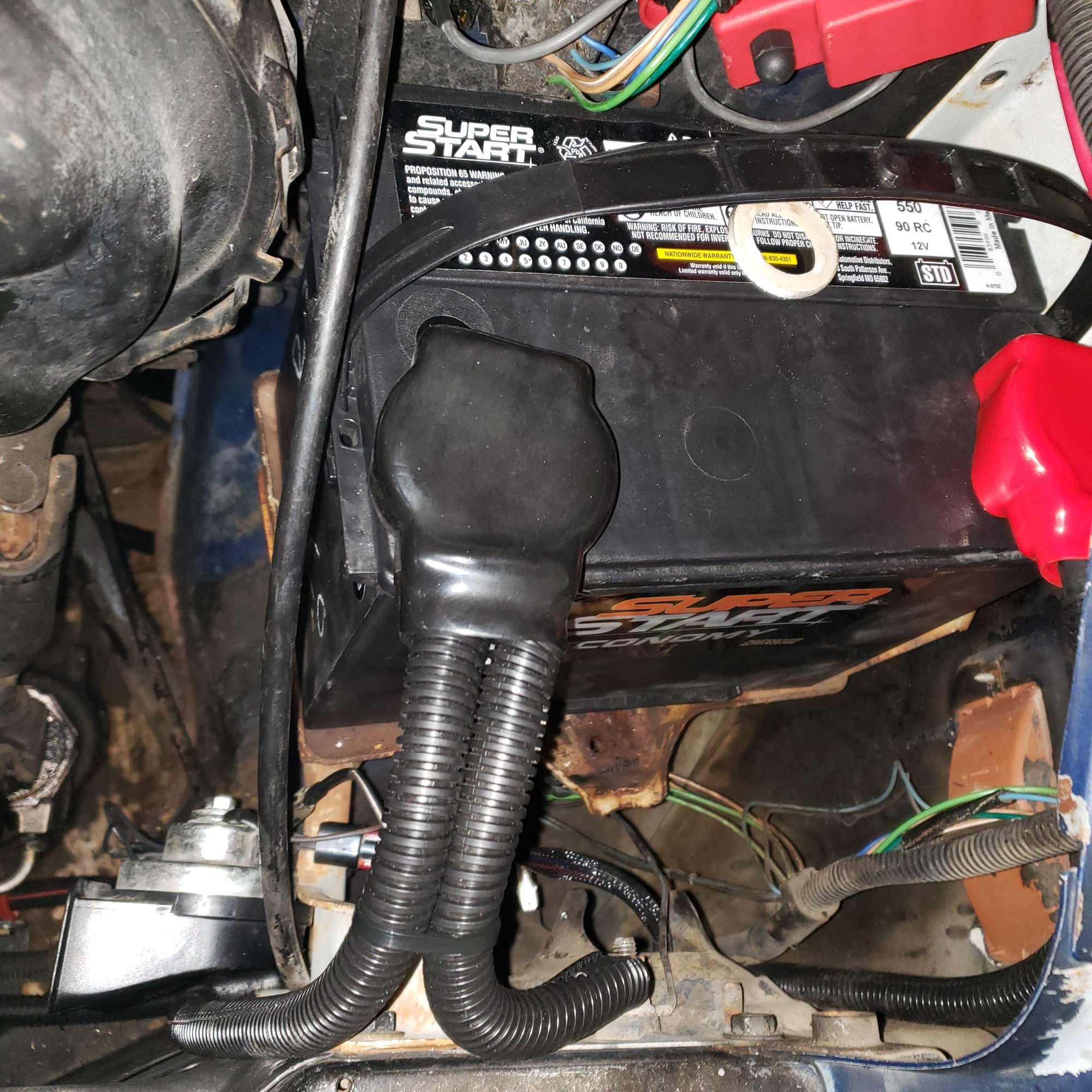

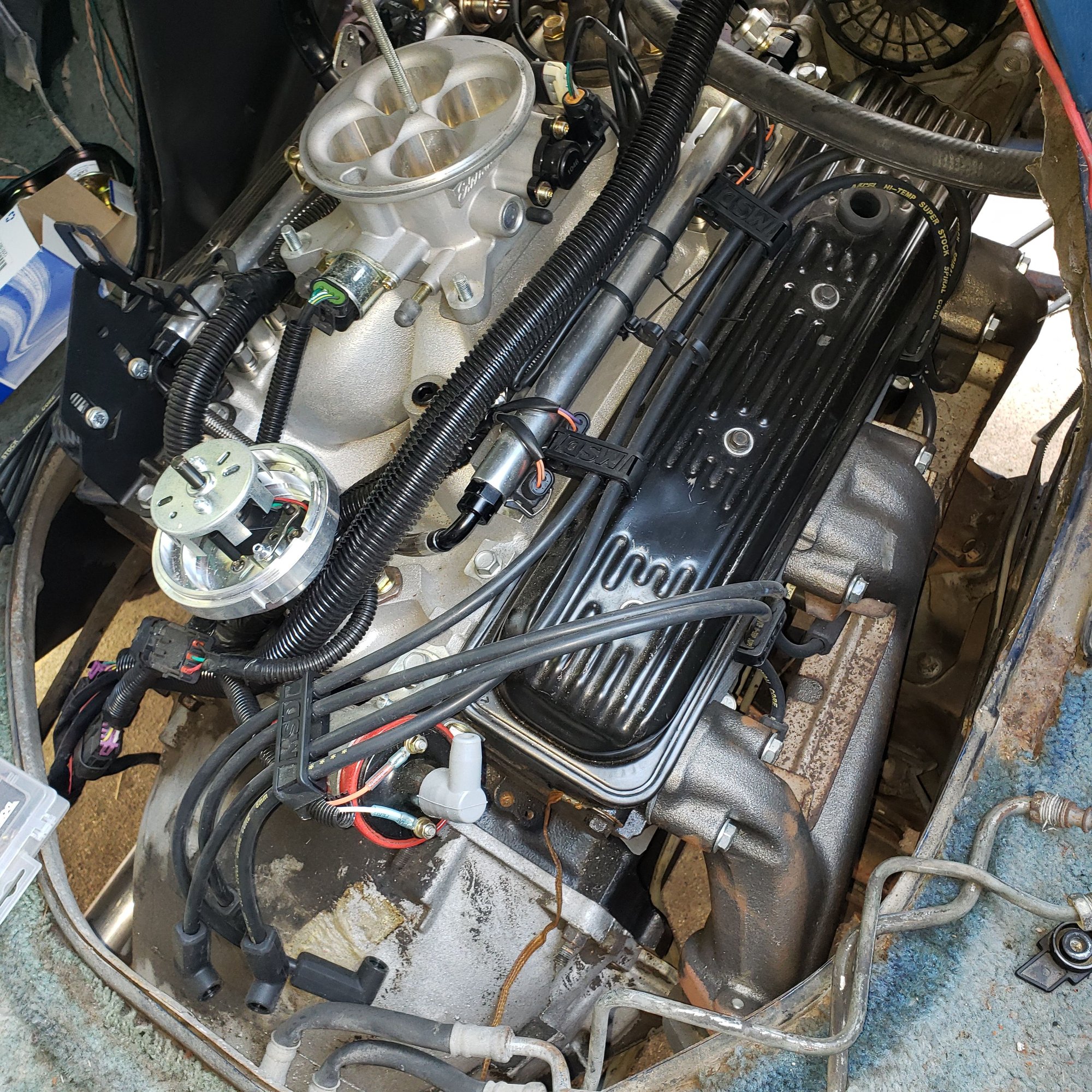

Man, I didn’t plan as good as I should have. Had to do a few things temporarily since I’m in my dads garage, but finally got it fired up. Need to get the car back to my house and clean up some wiring and tidy a few things up.
Had a couple hiccups that I didn’t expect/think of. First was the heater core input to pass side intake would have hit the fuel rail. Ended up having to use two 90s to get it to clear.
Second, the shipped location for the temp sensor hit the thermostat housing. I’m running vortec heads so I had a bypass plumbed from the water pump to the intake too. Ended up having to use some adapters and a 90 to move the bypass to the drivers side 1/2” npt location. Moved temp sensor to the lower crossover port.
third, I had forgot, even though I bought a coil, to get a coil wire or mount bracket. Ended up making a coil wire that doesn’t exactly match, and found a coil bracket we had saved from who knows when. Mounted it the only place I could think of that fit the harness.
Finally we were ready to turn the key and my cell phone app didn’t find the ecu. Thought it was apple vs android issue. My brother came up and downloaded the e tuner 4 plus app. Wouldn’t connect. Tried the e tuner 4 app and it connected.
took a couple attempts but got it to fire and idle and looks to be doing as it should. Love it so far and haven’t even drive it yet
Got a lot of wiring to finish and clean up. Plus a few things to redo. Existing plug wires don’t really look good or reach as they used to. Also have to hook up ac and a bunch of other things.
Some things I just couldn’t run how I wanted to, but hopefully get it cleaned up and driving shortly.

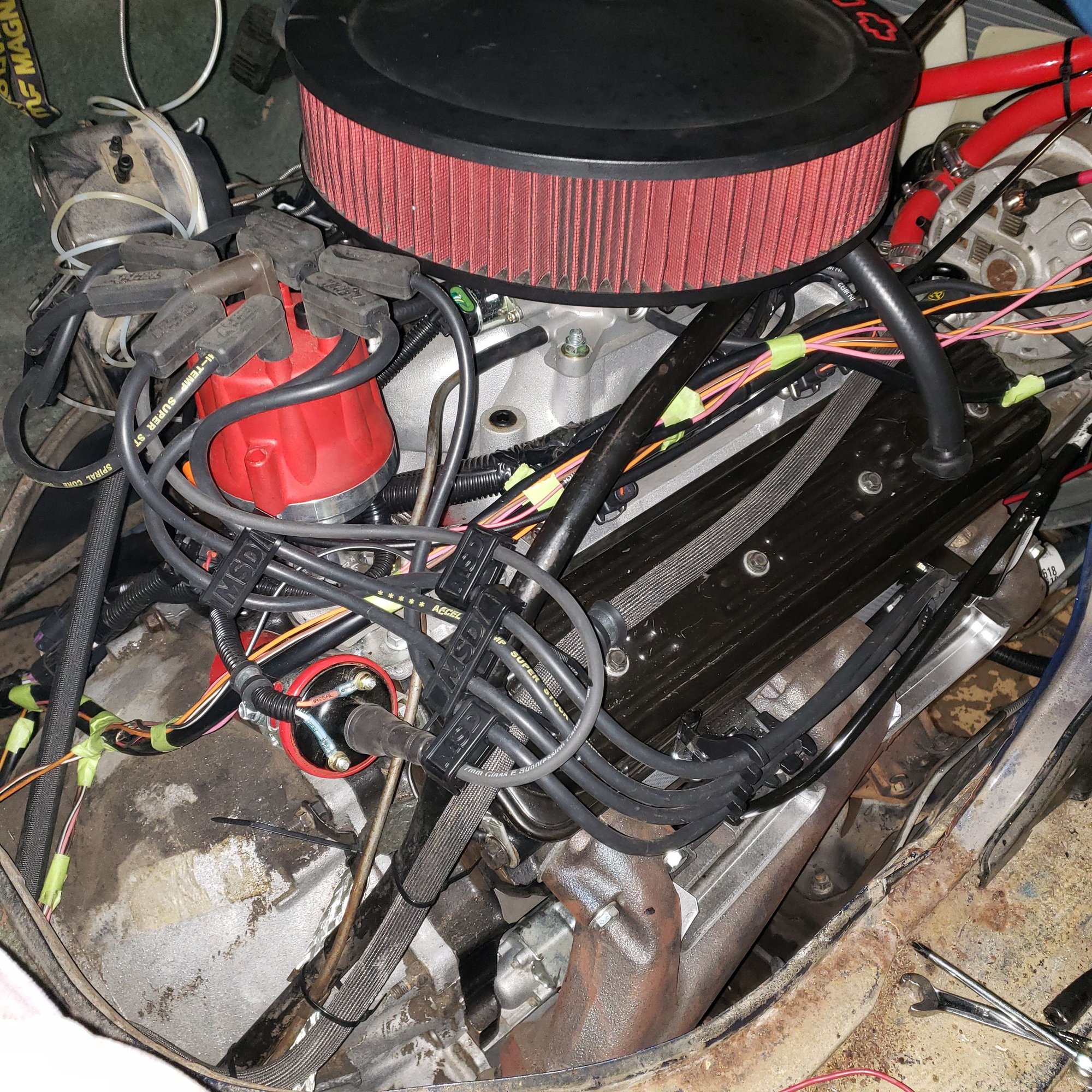

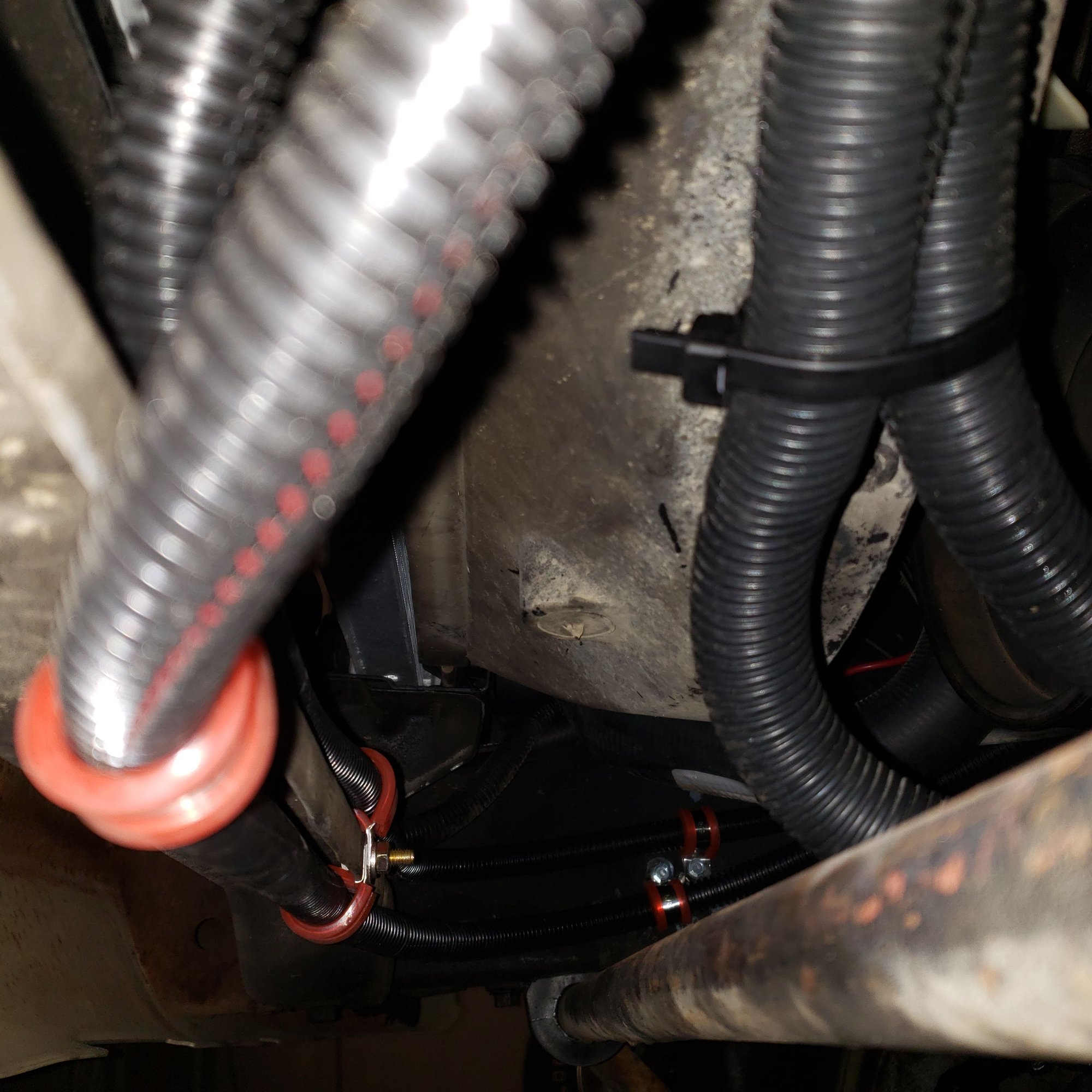

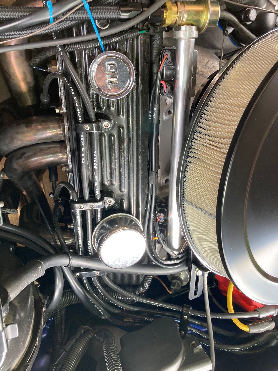

Been a bit. Put probably 200 miles on it so far. Had a few issues that I couldn’t quite figure out, had some misfiring and back firing in the exhaust at light throttle. Tried making some adjustments and nothing seemed to work. Then I went back to basics and decided to go ahead and put new wires on it. Turns out a couple were getting brittle and one has burnt through. I went ahead and put some new plugs in, gapped to .035 per Edelbrock recommendation. Just took it for a spin and is running great again. Sometimes need to just go back to basics.
still need to clean up some wiring and get my washer tank reinstalled but it’s getting there. Also got a slight oil leak at the oil pressure tube coming from the block I need to fix.
Getting closer. Ignore my temporary wiring

Also the 3” intermediate pipe from summit worked pretty good. As I mentioned earlier, I cut the inlet off my existing 80 series far enough to where it mated up with the pipe and then welded it back in. Just had to modify the hanger that came with the pipe.
Have you put any more miles on yours? I removed my temporary wiring and finalized the actual harness connections on mine. Have it all on the key now. I also built new 2awg battery cables to use a 24F top post. I installed a new well baffled TBI replacement tank, new TBI sending unit and Delphi Vortec pump in the tank. I plumbed the fuel lines using the OE TBI steel hard lines up to the rear of the engine compatment. Parker EFI hose with Fragola fittings and HP products sleeving over them. With the stock TH400 and 3.08 gears this will roast the right rear P275/60R15 off it at will just dropping the go pedal from a stop. Manifold seems to be making good torque with my combination. 10.25:1 L31 350 with a GM 6492 cam and 1.6 full roller rockers. It is stalling the OE TH400 converter ~2,500 rpm.
