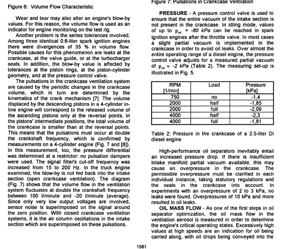

Crankcase evacuation using air filter pressure drop example

Originally Posted by Bill Chase
Or maybe you prefer to suck it into the intake tract and use that as a source of vacuum? It is far more common with high performance power adder v8 stuff to use a belt driven external vacuum pump, or electric vacuum pumps.
Weeeeel Intake manifold doesn't have significant vacuum at wide open throttle due to rapid pressure variations as valves open and close. Perhaps you have heard of water hammer? Engineering textbook phenomenon where pressure waves reflecting from closed valves travel up into the plenum...
The pressure drop is produced in front of the throttle valve, this is where OEM engines 100% of original engines receive their PCV signal for wide open throttle, using the engine as a vacuum pump.
In forced induction engines the same thing happens but instead of the throttle valve, it happens at the compressor wheel inlet or supercharger inlet, the region behind the air filter.
All factory engines use the engine as a vacuum pump to drive PCV. It is when people disable this system and have no idea how to use the OEM pcv system which starts causing oil leaks.
The pressure rises in the crankcase without proper OEM pcv and causes oil leaking, and other issues such as carbon deposits, reduced oil quality, long term health issues with the engine, reduced piston ring function, many issues as a result of disabling or removing the OEM pcv system setup.

THe reason we don't want an external vacuum pump on some engines is because of the increased complexity and maintenance related issues. They are not street friendly due to maintenance concerns and additional parts complexity.
for years now gz motorsports has made a very good sportsman kit that they stand behind when used on the street, is a bit pricy, but it is a complete kit several 3rd gen fbody people have used it. still others have used the electric smog pumps from cobra mustangs, the trick with them it seems is setting it up to ramp up at wot, and switch down when under light cruise conditions. if you run them at a 100% duty cycle they do not last long at all. back to the gz kit, it is a modified gm smog pump they have machined and fit vanves to, as well as a regulator setup. the nice thing about them is they can bolt right up using the oe serpentine belt routing etc. but a little pricy.
