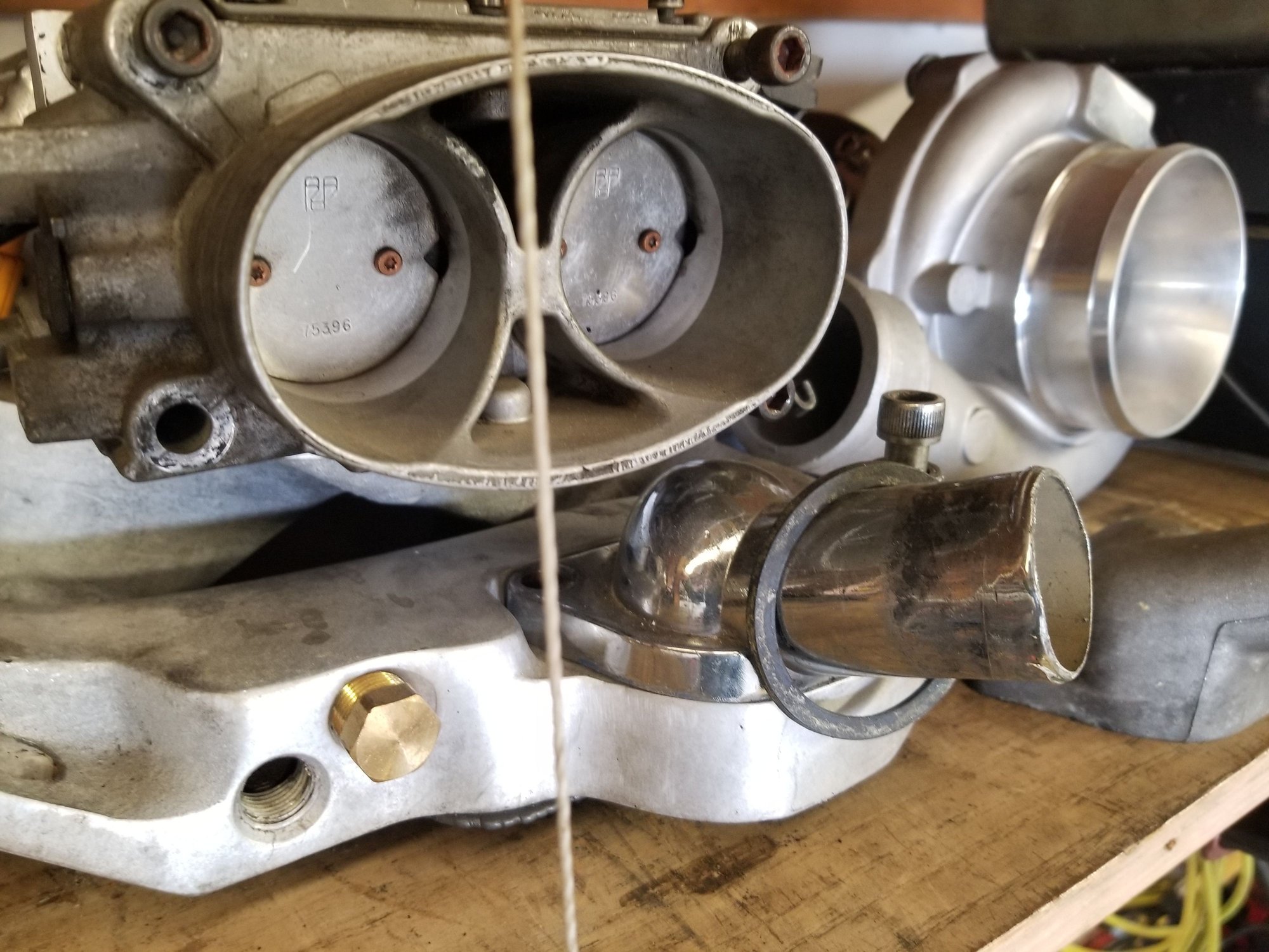

I can't remember which neck I used on the MiniRam. I looked back through pics from that intakes testing thread that I wrote, but the only pic I have of the MiniRam is after I pulled the stat housing as I started to pull the intake. Bummer. I have the intake in the "museum", still, so I can pull it down and mess w/the necks I have, see if I can figure out which one I used and send you a pic of the thing, if that would help? IDK if the Dorman one that Tuned posted is the solution? Or what that is...maybe he can clarify if that will work for you?

Here are a couple of junkers that fit under the TB. May need to chop the coolant Passage. Not sure about the orientation for your application of the upper hose but one of them must have worked for me because, I had it on there and it was working....
