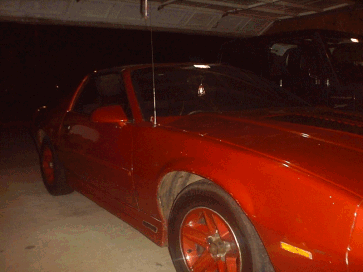

sorry bout your paint tpi_roc....i know how a sucky paint job can make ya feel. I hope the blackouts will draw some of the attention away from the lower front ground effect that is kinda busted up. This should be the pic from today hopefully....let me know if yall get this pic please so i can decide if im doin this right

Old Apr 16, 2002 | 06:24 PM
tpi_roc's Avatar
Joined: Aug 2001
Posts: 2,747
From: Orygun
Kinda small to tell chit from shinola
Maybe scan it larger and convert to jpg so the filesize is small enough for dialup users
But its pretty tiny
Old Apr 16, 2002 | 06:34 PM
v8powr's Avatar
Posts: 259
From: Fort Polk, LA
should be a little better now....i scan it bigger after i eat!

ah HA
Much better
After carefull consideration, black outs will not help one bit against my horrible paint job
Old Apr 16, 2002 | 06:48 PM
v8powr's Avatar
Posts: 259
From: Fort Polk, LA
WOW....i finally know how to post pics! i didnt know to convert them to jpg format.....thanks!
