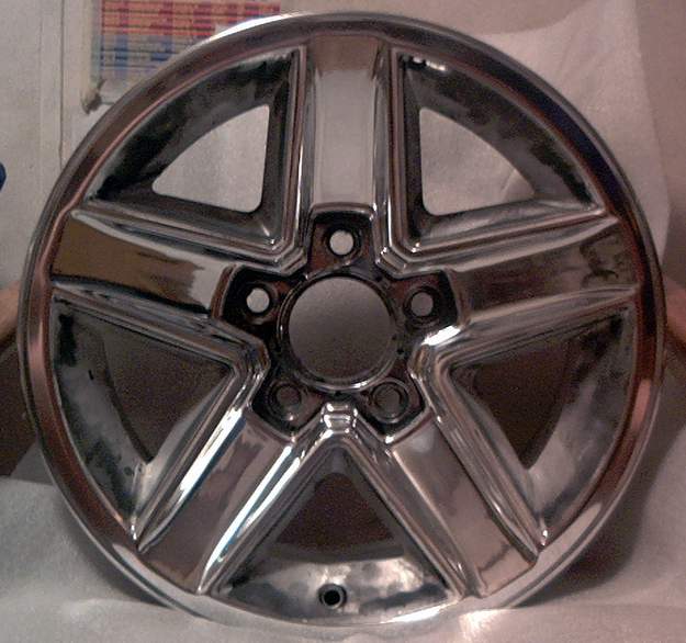

everybody listen to MikeInAz....... he knows what he is doing? here a few pics of my first polishing project using his method. I plan on redoing all of it end of summer
Attached Thumbnails Aluminum: Buffing vs Polishing-2up-rightside-motor-.jpg
Old May 5, 2002 | 01:26 AM
87transam5.7tpi's Avatar
Posts: 1,532
From: Nebraska
another.......oh and these are before and afters I hope you can tell the difference :-)
Attached Thumbnails Aluminum: Buffing vs Polishing-2up-top-motor-.jpg
Old May 5, 2002 | 01:27 AM
Posts: 1,532
From: Nebraska
and the last one this one actually was getting some light so you can see how it somewhat shines
Attached Thumbnails Aluminum: Buffing vs Polishing-2upleftside-motor-.jpg
