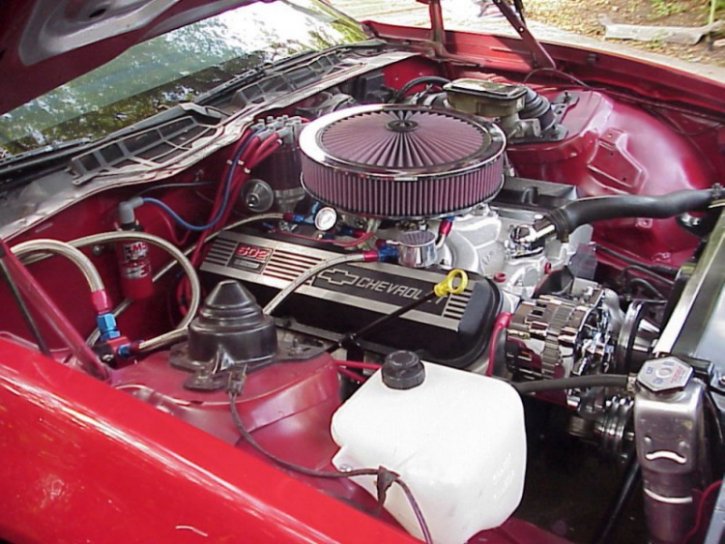

Hey, thought I would post some pics of my car. So what do you all think?

Did you have to beat anything to make it fit?
Looks great to me. Clean install, great job!

that looks awesome in there! What mods are done to the motor? How hard was it to shoe-horn that in?

I have quite a few more pictures if you wan't to see them. So far the only hard part was the exhaust the rest has been your standard engine install. I really should have cleaned it up abit before i took the pictures, hasn't been washed in a month(to busy trowing parts in the car).

The Longblock is a GM performance 502. I used a differen't intake to fit it under the hood. Pretty tight under their but I can shut the hood no problem, not to bad for calculating the intake height months in advace with no Physical engine. The only thing I wish I could of done different is poly motor mounts instead of solid, but the exhaust and intake are to tight so I had to use solid mounts.

Good job smoothing the firewall. That definately cleans up the engine bay a lot. Only bad part is that it gets really cold in the car. Did you replace the vent controls with anything? That's how I'd like my car to eventually look.

Well around here it dosn't get that cold and it's not going to be a daily driver so I'm not to woried about a heater. To me I would rather have the firewall look clean intead of climate control.

No that is not nitrous those are my fuel lines but eventually I'm going to give it a 150-200 shot of juice. I have a few more pictures I don't have the crome alternator in a few and some other parts got switched around as well.
