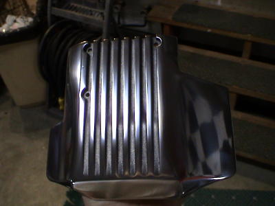

well tonight i started some polishing on my runners, and a little more on the plenum, all this stuff done to the plenum was done by the prevous owner. when im done it should, i hope, look like its all been tripple cromed.
everything you see i sanded only with 180 so far, the left side also. thats all i have gotton done so far, but tomarrow i go and get the buffing wheels and compounds so after im done sanding i gat to ahve soem fun polishing.

last one, josh, screaminformula, did this before i bought it, did a good job but nothing compared to waht its going to be.

well, Shean, ya got a LOT ahead of ya, trust me. i worked with that plenum about 6 hours just to get that crappy (by most standards) finish. but good luck and maybe you will get it lookin better than i did since you have it off and i didn't. go look in the Tech section here and find out the proper procedure to do it, thats what i did...
good luck with her Shean!

Just go through the steps of different grits and use some different compounds. It'll come out niiiice

well so far ive doen about 2.5 to 3 hours of sanding by hand with 150 grit. but then i retro fitted soem sand paper to the dremel and it took like 10 minutes to do the rest of the runners and plenum. today i start the wet sanding with 320, then 400.
i picked up yesterday 3 hard sanding wheels and 2 soft. im going 1 hard emery, 1 hard tropoli, 1 soft tropoli, one hard white rouge, then last 1 soft white rouge and they should turn out very nice.
kyle, if you want ill do this for you but i dont do it in your engine bay. you pull your TPI and ill do it for $50.

Yeah, that was the bad part...but.....after doing it..I just used a leave blower...300+ winds....got EVERYTHING perfectly clean :O)
