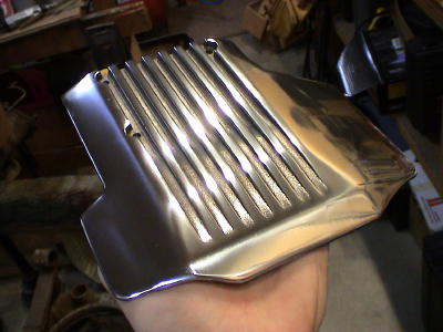

The BEST method that gives the BEST results is to do this:
1) 180 dry
2) 220 dry
3) 320 wet
4) 400 wet
5) emery of hard wheel
6) emery on soft wheel
7) tripoli on hard wheel
8) white rouge on soft wheel
*The longer you do on steps 4 & 7 the better your results.
Also, many people swear up and down that going up to 2,000,000 grit is the way to go....If you go above 400 you chance making the metal cloudy and may have to start all over again. Stop at 400 and let the buffing compounds do the rest of the work. Here is with the above suggested method:
Attached Thumbnails how does everyone polish their plenum/runners/TB?-plenum2.jpg
