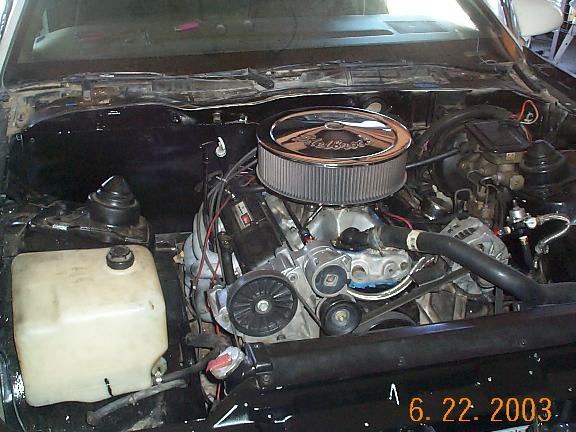

Heres mine. Just get a piece of tin, cut it to size, paint it, and screw it in with self tapping screws. simple as that.

Can you buy those aftermarket heater boxes somewhere? j/w

cool thanks guys, i live in florida, so i dont need the heat, so i think i will try the tin idea.
The tin is ghettofied and horrible, not to mention you also lose defrost, dont get caught out here in FL rain without that, get an a/c delete box and do it right. sheesh.....

Ghettofied and horrible? Im sorry but it looks pretty damn good to me. As for the defrost I dont need that living in AZ.
