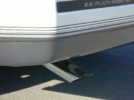

Here's a better shot at it....

yes for sure they are decals i used to have them on my car but i took them off
it was fairly easy i just let the car sit out in the sun and then they came right off

Use a heat gun set on a moderate setting and a razor blade and it will come off easily

Honestly I would leave it on. If your car has ever been repainted, you may pull the decals off only to find that the masking job for the 2 colors was not the greatest. When my dad and I repainted my sisters car, we redid the original 2-tone charcoal and white paint like yours. It looked funny without the pinstripes. The decal kinda makes it 'fade' from the dark to light color.

There is a decal that separates the main color from the secondary color. The bottom color is paint. Only the decal between them is not paint.

Well you said your getting gfx. So get them to take the decals off and it its faded paint over it when they paint the gfx. But I believe the bottom part is painted, just the little stripes on top are decals like Jim said.
