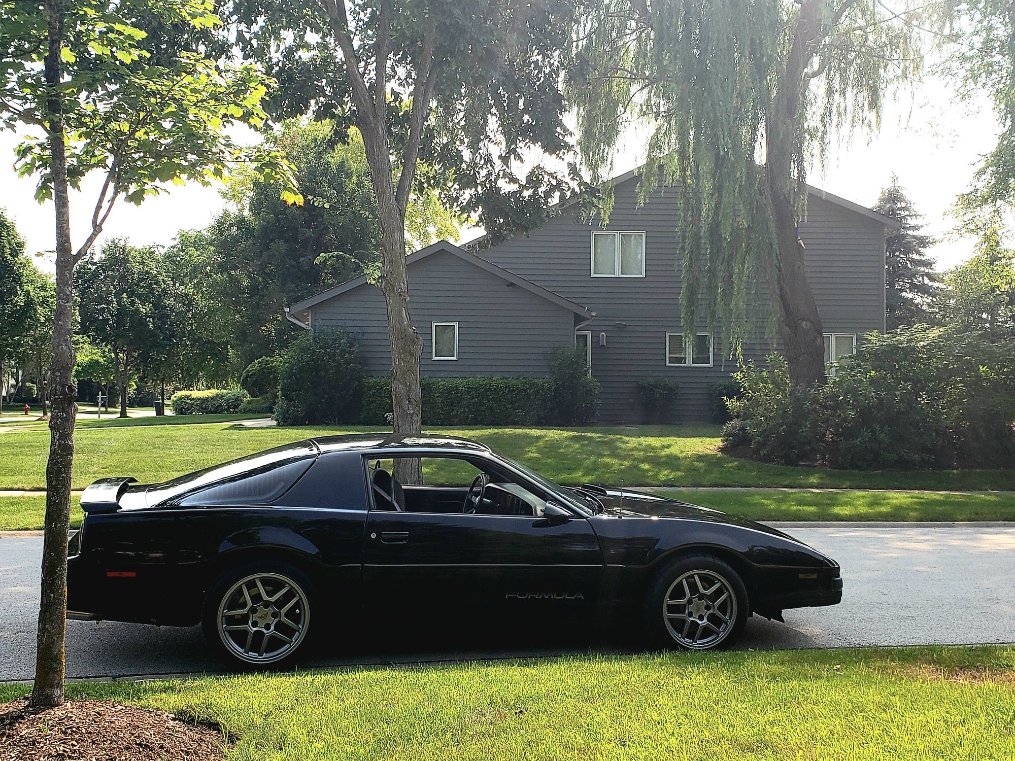

Old Jun 12, 2019 | 08:45 AM
bigbrother's Avatar
Joined: May 2006
Posts: 78
From: chicago
Car: 89 formula 350
Engine: tree fiddy
Axle/Gears: Borg warner 9 bolt with 3.27s
Re: will c5 wheels fit on a third gen???
Originally Posted by omnipotentgoku
note... yes, they will rub ( the fronts). Slight modification may be needed to your wheel wells.
thread back from the dead...
Did you find a way to eliminate the rubbing?

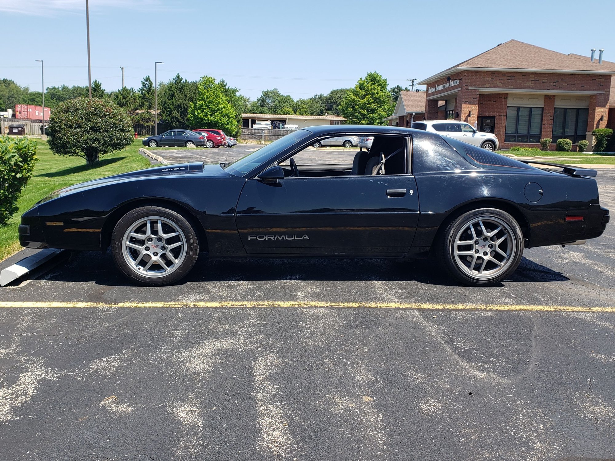

bigbrother's Avatar
Joined: May 2006
Posts: 78
From: chicago
Car: 89 formula 350
Engine: tree fiddy
Originally Posted by Brian Laycox
My C5 wheels rub a bit in the front, but only when I max out the turn. Otherwise I'm all good.
I don't notice any rubbing with the wagon wheels I went with. 245 tire up front.
I've got formula (97) 17". Wheels on my formula and not seeing any rubbing there either. The formula has 275 up front with c5 brakes and 2" spacers
I think I've got c5 brakes as well, and a 4th gen z28 rear end. I just got this car so i still have A LOT of exploring on it to do on it. I actually want to see if 1984 trans am wheels would fit on it (15x7) so I could make a knight rider tribute for Halloween. It'd be fun to park it outside while kids trick or treat. Wheel fitment seems to be a very talked about subject, so I've been paying attention to forums, old and new, and trying to learn along the way. Post up some pics! I would love to see them! Also join my Facebook group FIREBIRDS UNLIMITED. Im always accepting firebird fans.
15" wheels won't fit with c5 brakes. 17s barely clear up front.
