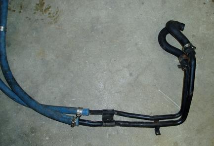

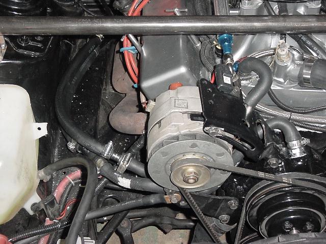

I got the metal pipes for a non ac v6 and some other factory hoses (not for a camaro) to run them like this. I had to cut about 6" off the ends of the tubes by the headers because the metal pipe outlet angles the wrong way (towards the strut tower). Needs to be cleaned up a little, but it made room for my STB. This was done with the ac delete box, don't think it will fit with the larger ac one.

The pipes run up behind valve cover on firewall, with 2 question mark looking hoses on the ends.

Hoses into heater core

Originally posted by Firebird 383
Where can you get the molded hoses that go from the heater core outlets (at the firewall) down to the metal-tube part of the heater hose run? I don't want to try and bend regular heater hose and have it kink where it 90's. The parts store guy had no listing for these.
You can get them through the dealer.
It's the S-shaped molded hoses on the end that I need:
Part #'s 10135306 and 10135312 for the S shaped hoses.
I used two cadillac catera heater hoses to come off the intake and water pump. They needed to be trimmed but had the right bends in them.
Part #'s 90502792 and 90466222
The pipe is discontinued but available through the dealer through VPI (vintage parts inc.).
Part # 14101573
The rest is joined with plastic hose connectors and regular heater hose. I used 5/8" and 3/4", no leaks but it was a little loose on the pipes. I will probably redo it with 5/8" and 1/2"
