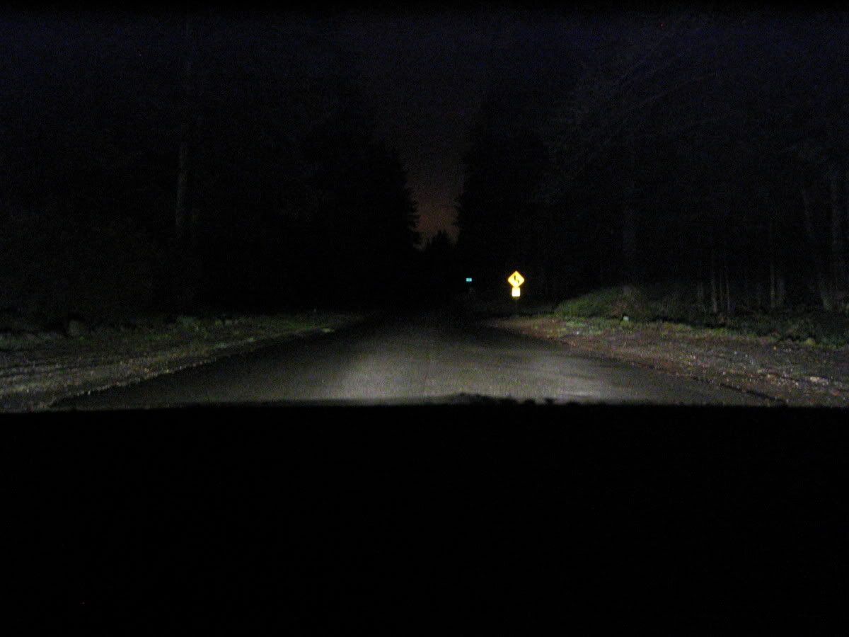

i'd like to a few more shot's with them on
can yout turn the car around so i can see
how well they light up the road ??

confucious, you mean just take a picture of the lights shooting down the road?

Car: '91 TA vert
Engine: turboLSx
High beams:
Low Beams:
I still need to adjust them. I'm lazy.
