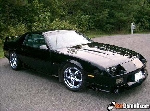

Well here are the wheels. I finally received them and I must say I am highly pleased. I think I will need to lower my car even more. As of right now they fit great and my car handles excellent! Talk to Jeff at Group A. He is a stand up guy. Tell em Dave with 91 GTA sent you.
