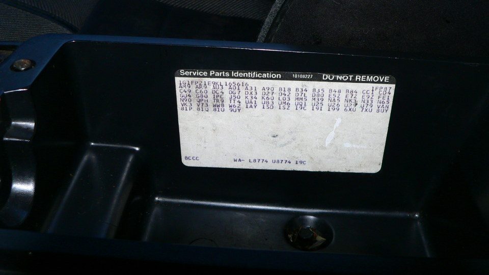

Do you still have the RPO sticker in your car? Should be located in the center console or on the door to the storage compartment in the rear (driver's side)? If it's no longer there, then the best thing to do is as Gramps says.
It will look like this one from my 89 RS, on the very bottom is the paint code. Mine is 8774 for bright red.
