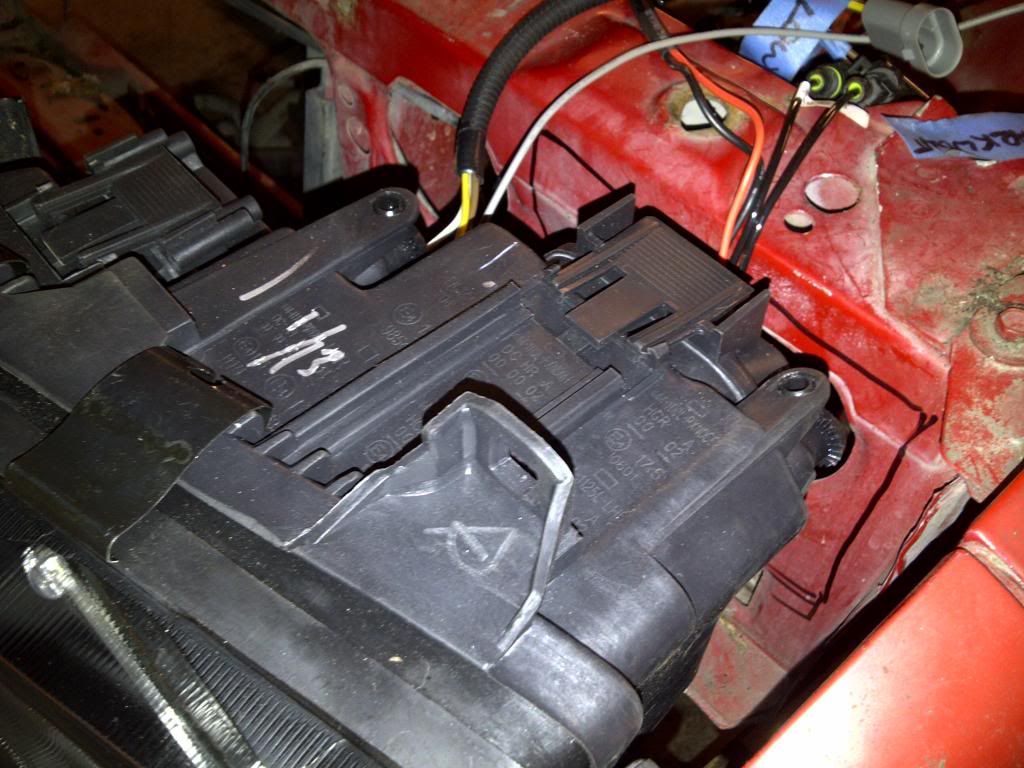

Heres a few mock ups on the parts car I have

I will post up pics and I think I will do a step by step write up for the swap as well. There are so many questions out there on the swap and I will try to cover them all. Ive got a ton of pics of my car since I started. As you can see so far i havnt cut as much as other people as im trying to save the rubber pieces for the hood that it sits on.
I still have to cut the bumper on a angle so the head lights will sit properly. When I get that done Im gonna fabricate a support for behind it and weld it either to my car or make it bolt on somehow. I will see when I get it finally set

Been working on mine. It takes a lot of cutting, grinding, beating, and a little welding to get them to fit right but they can fit pretty nice. Not completely done but i thought i would post it anyway. Notice the up/down adjuster lines up perfectly with the hood bump-stop hole. Also notice the mounting screws. welded in a lower/inner bar to bolt to and and used the edge of the fender for the upper/outer location. It is very stable between those two points and some other edges catching to hold it tight.
[IMG][/IMG]
[IMG][/IMG]
[IMG][/IMG]
[IMG][/IMG]

couple more pics
[IMG][/IMG]
[IMG][/IMG]

The car is currently all stripped out in the process of an LS/T56/9" swap so it was a good time to do this mod and repaint the engine bay and core support.
