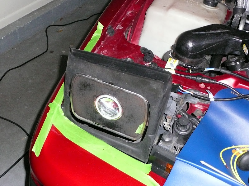

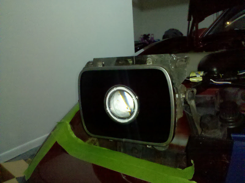

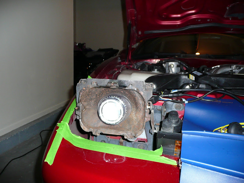

i removed the stock bulb
stuck the projector in

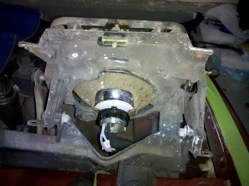

from the back you can see how they mount. i just bent the little tabs of the stock bucket over a bit and tightened the end cap over it. pretty solid
the front i'll fill in with some black abs when i find it. help support the front as well. this is just cardboard to get the size right.

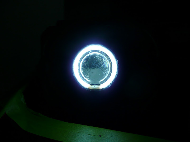

a little flat back to see what it looks like. not sure if i'm doing the projector housing and metal frame in black or just leave it sliver.
white halo's.. kinda iffy but add a little something, and atleast they are just white. so i think i'm going to hook them up.

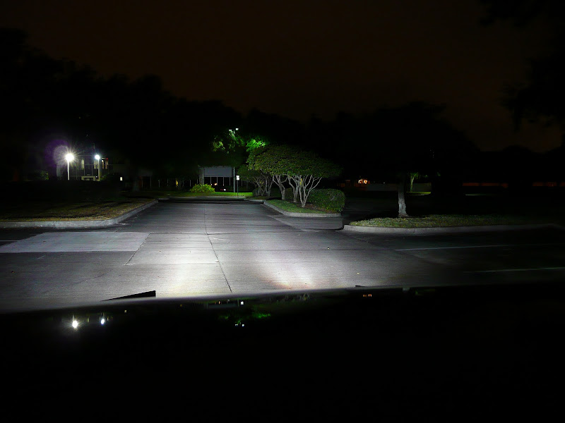

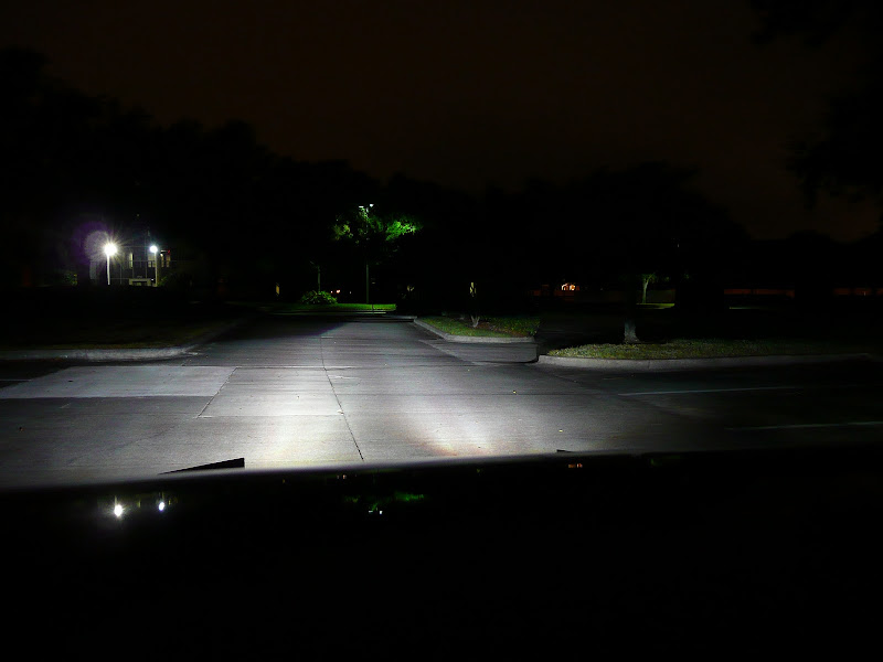

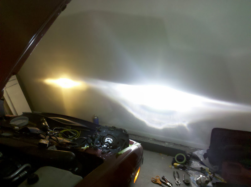

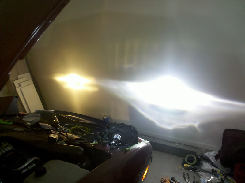

and to quick side by sides, very close to the wall so you can't really see the cut off. but they do have a great cut off.
high bean. again doesn't look to much different because its close.
they are 5000k's so very white, and at 129$ shipped i'm more than happy with them. cheap china stuff, but i've had my first set on the bike for a good while and no issues.
comments welcome, bash if you must lol. but i'm not changing the setup unless someone has a really good idea thats pretty simple to pull off. the main reason i'm doing it is because my girl drives the car to work some weekends because she loves it(and its her's haha). but always says the headlights suck. so this should fix it for simple and cheap.

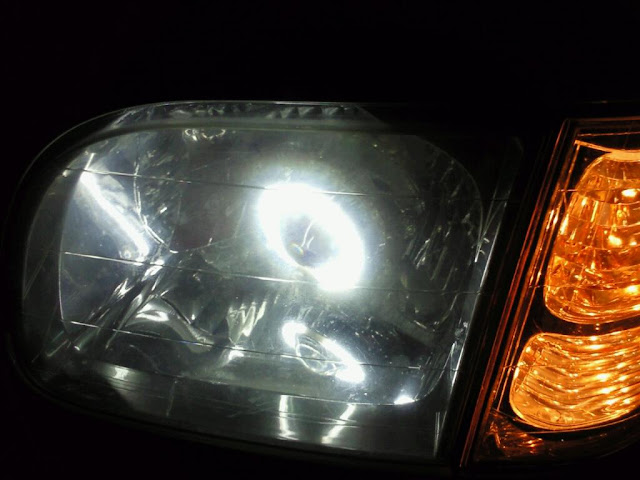

two quick pics from the bike ones to show the cutoff.
and high
here they are less than a foot apart because its on the bike, and i think the left one got turned a bit while building the bracket. so the cut offs over lap, but you get the idea.

I'm curious as to how wide and how evenly dispersed the beam pattern is. I used to post on a retrofitting forum for awhile, and was warned to shy away from off brand ebay projectors. Haven't seen these ones before though, any way you could find a big open space and snap some pics?
I should be able to pull that off

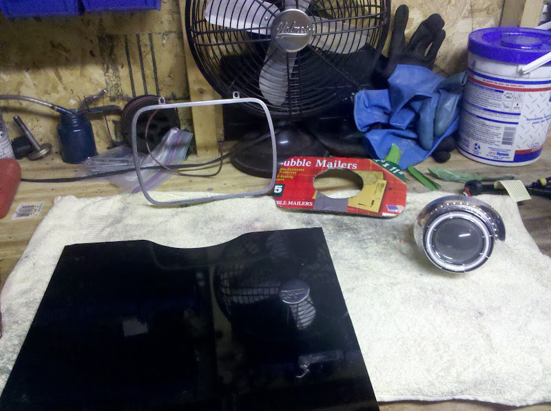

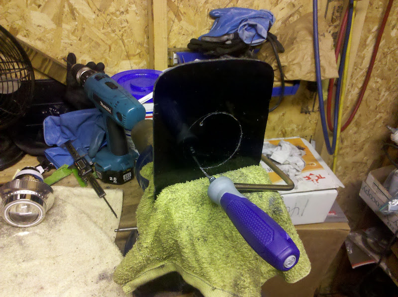

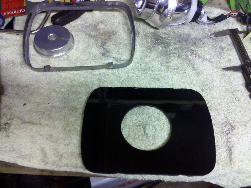

some quick ones of the plastic cut out.
the center was a pain haha
just some quick phone pics along the way. gotta do the other side tomorrow. then hide all the realys and crap somewhere, along with the motor rebuild so it flips up right.

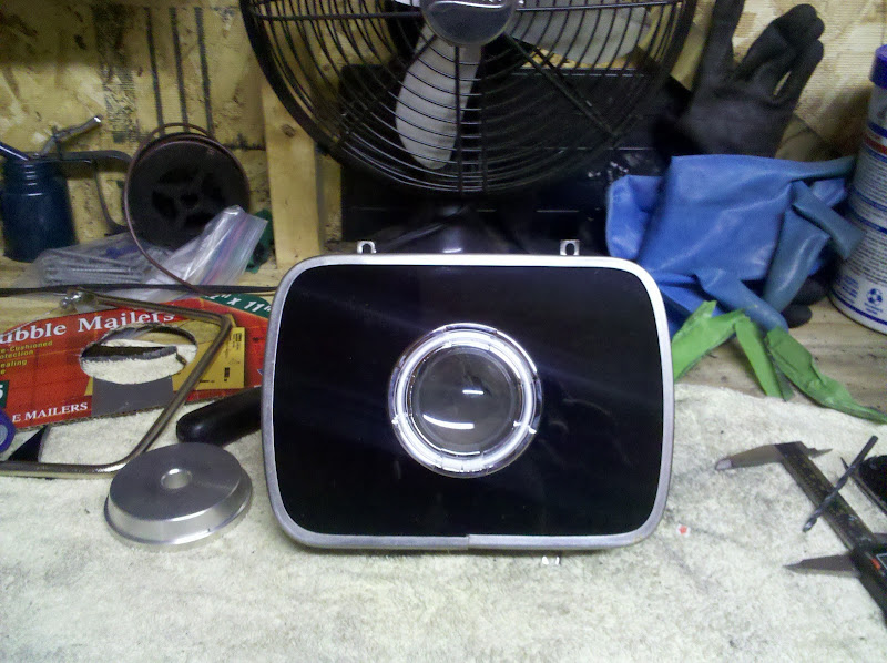

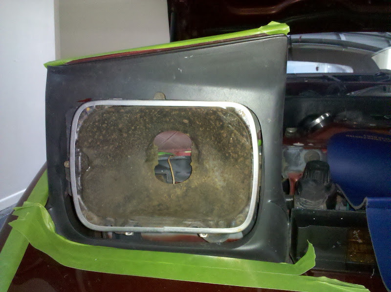

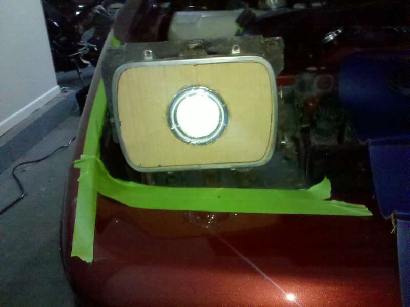

didnt take many pics tonight but got the other side plastic made up and everything sealed up in the buckets. going to let it dry over night and wire it all up soon. im not someone that worrys about wiring things but i wont lie, the way these are all done up where you only have to wire + - and plug it a plug is pretty nice. all this hi/lo and halo stuff could lead to a pain in the ...

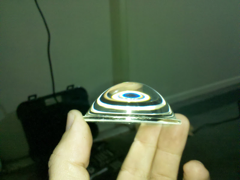

for you guys worried about them being exposed, i took a pic of how thick this glass. i think if something breaks this while driving, ill have bigger things to worry about than my headlight. ill upload later.

here's the glass..
the newer R1's are exposed i think, but they may be made of something else.
I wouldn't be worried about them breaking completely. I'd be concerned with chipping, pitting, cracking, etc.

You should make outer shields.Any damage to the projector lense will ruin the beam.Doesnt matter how thick it is.If damaged light wont focus.
As for the new R1s.Thats not the projector lense you see.Thats the shield.The lense is farther back.

Nice aiming marks on the wall, but you should be like 20 feet away to aim them, not 2 feet!

they are going to have to be aimed all over again so the cut off falls below the line of sight of on coming cars, the was just a referance point at best so hopefully i dont have to twist a screwdriver for an hour lol.
as for that whole 20foot thing, i never do any of that. ive tried and never happy with it. i stop the car on a dead end road by my house and adjust the lights based on what looks best and make sure im not blinding anyone on low. we used to do a lot of night runs and it leads to being very picky about lighting.

.....as for that whole 20foot thing, i never do any of that. ive tried and never happy with it. i stop the car on a dead end road by my house and adjust the lights based on what looks best and make sure im not blinding anyone on low. we used to do a lot of night runs and it leads to being very picky about lighting.
That is how I do my lights to. I live way out of town, so I just park on a dark back road & start aiming. I put my Hazards on & have had people just drive around me, while I'm aiming my lights!

so i got lazy and just took some pics of the light in a dark parking lot near by.
i'm calling it done.. we will see if i have any issues without covers. if so, i'll post up in this thread about what they are. as for now. the pics..
my cam has auto settings only, so it makes it look lighter than it is. but its dark
low beam..
high
i've never really studied the light pattern of a high end car with projectors, but to me it seems pretty good. deff 100 times better than stock sealed beams that were in there, and total price for the whole mod is 129$ shipped for the lights, which come with nice harnesses and waterproof relays. and i did end up buying some sticky back rubbery sheets stuff from lowes, in the roofing section lol. to keep the light from bouncing around out the and extra sure the back end was sealed to the bucket from water when in turned off and facing down. i thought maybe something could sneak thru there. the roll for 9$ and i only used a 3in x3in square on both sides

I just realized something though....You have them mounted in the mounting buckets, not in any housing that fits into the mount.
How did you mount those in there? Is that black plastic sheet what sandwiches them in there & holds them place?

check the 3rd pic in the 1st post. since they arn't stock parts, they mount from the back. so they plastic is just for looks. i went ahead and sealed the front too, and it might help some but the back uses the bucket tabs to mount the porjector.

I did look at the pics. Didn't I say that?
But I can't tell how they are held in the bulb mounts.

i don't think i'm understanding your question.
i just bent the tabs that are at the back of the headlight bucket in some, stuck the projector threaded part thru, put the washers on and tightened the nut. the bucket tabs get clamped down and it holds the projector.
these arn't mine, but same idea. maybe this pic will help.

That pic looks just like mine do. 2 options for the threaded mount.
I'm just not real clear on how it is holding itself to the bucket mount.

i may have went to far, towards the import side. but i went ahead and wired these lights up tonight. they just peel off, if they don't grow on me. i mean they look kinda different, but might be to much.
the camera makes them look blue, they are atleast white lol.

maybe this will do a better job, the arrows are pointing to the tabs i bent over and tightened the mounting ring/screw onto to.
