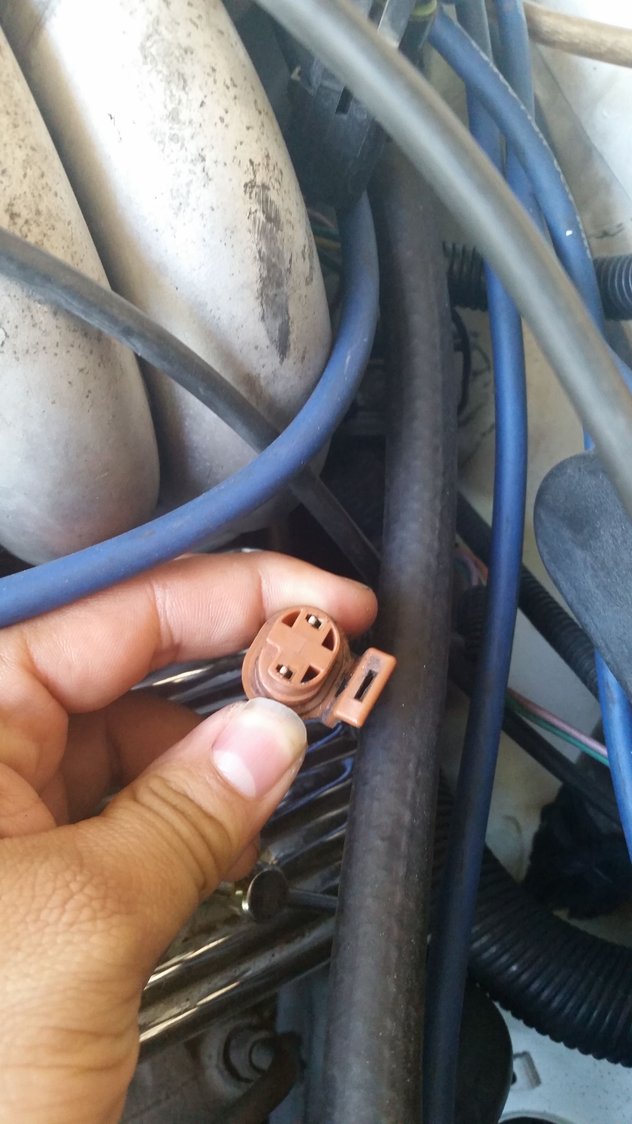

Hey everyone so I recently inherited a 1988 Camaro Iroc z28 5.7. I just had the engine block swapped out but when I got it the engine bay was in pieces. I need help identiying these harneses and what they connect to because I do not see where they go and if pieces are missing.
Engine Bay after motor swap.
I believe this is for the 02sensor since the 02 wires are cut up.
this is next to the harness of the 02 sensor
AC compressor in picture. this and other 2 wires are ran through the same harness and conects the AC compressor.

Oil Pressure Sensor (behind driver side rear of intake next to dist.)
Transmission Connector (Lock Up control, on top of passenger side of trans oil pan)
Coolant Temp Sensor (passenger front corner of lower intake)
Unknown
Unknown (possibly Smog Pump, passenger side lower accessory)

Thanks I found the location of some. Still going through the car to find the rest.

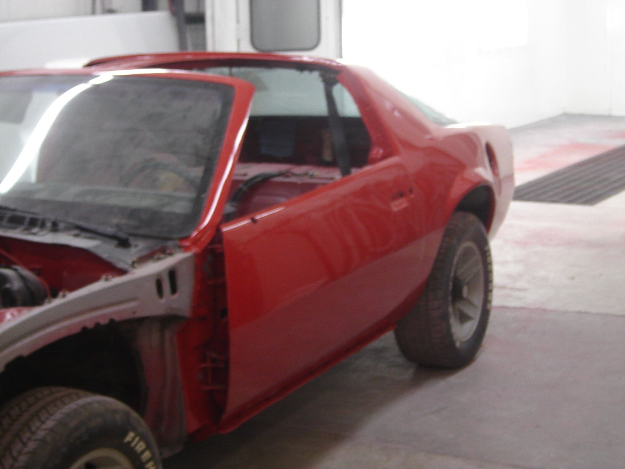

Mines a project. a many year project.
T-Top bar was dented bad. I wanted the car done perfect.
Epoxy primer. Down to bare metal.
This work was done in 08'
About a month after this I was in an accident that caused my baby to sit in storage till hopefully this year.
Currently, All the car needs is for the fenders to be fitted/hood/bumpers and interior and she will be back on the road. There is many small projects that I want to button up also. Its been so many years, one more wont hurt I guess. Want it to be done right.. Want to drive it though too..
